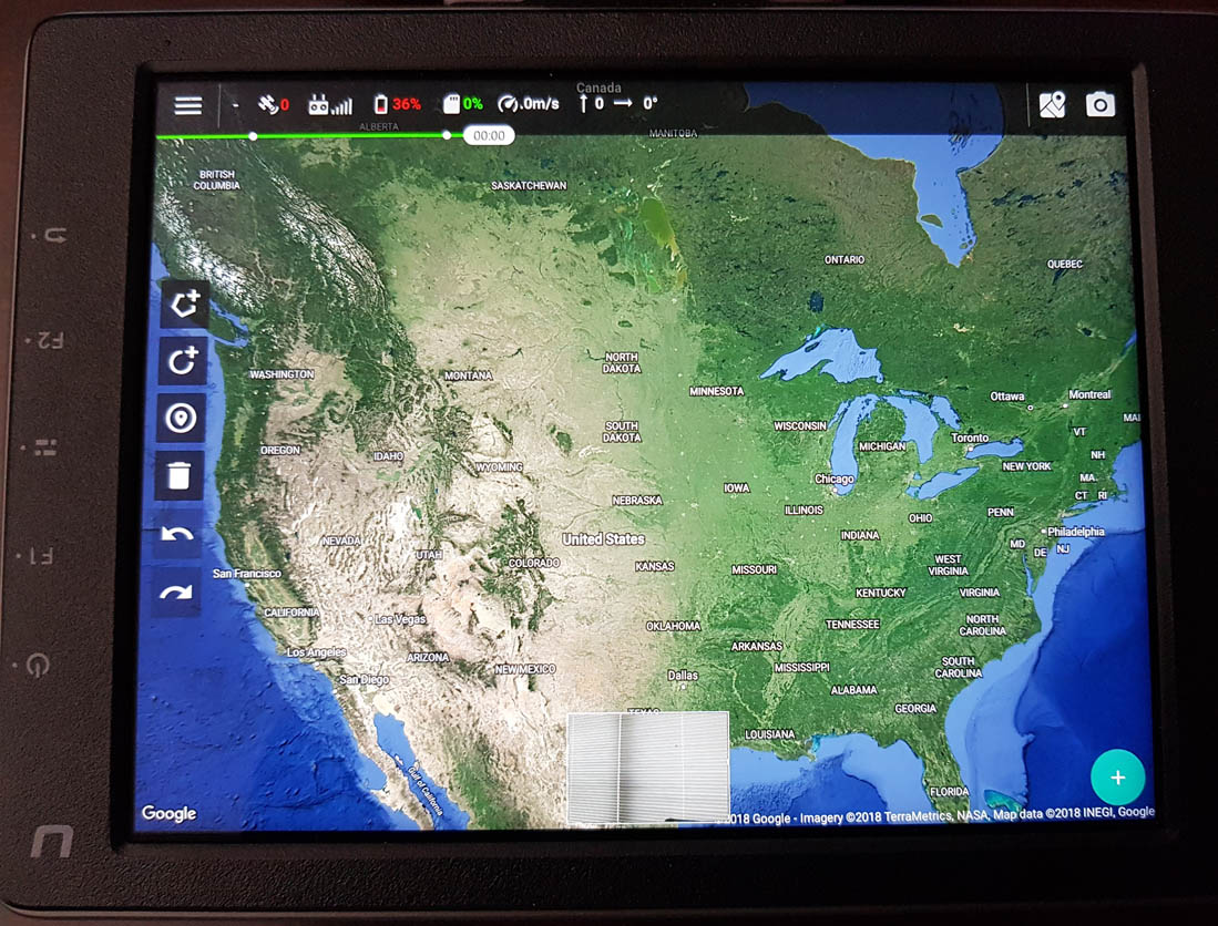

Drone Harmony works on my CS Ultra, no problems at all

Awesome! If you have any tricks or hints for our dev team to consider (we expect to get our hands on a CS device in the next weeks), please let us know. We will be more than happy to credit you in an official installation guideline.

To get DH to work on the CS, I just installed the following APK files, it's no big deal
google-play-services-11-7-44-032-173432861.apk
Play Services Info_v0.7_apkpure.com.apk
Google Play Store_v8.3.75.U-all [0] [FP] 173942022_apkpure.com.apk
Maps Navigation Transport_v9.64.1_apkpure.com.apk

Cool thanks for sharing. Our dev's will look into this as soon as we have the CS.
