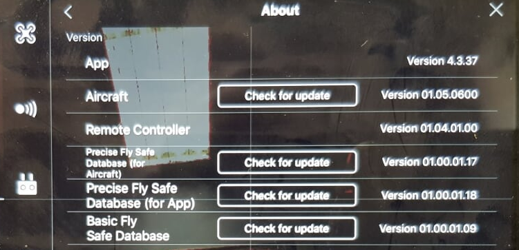

What firmware is on your P4pv2 and on your controller?
Attached/Appended image from Go4app. Refreshed last Friday. I've checked the release version on my P4P and it this same. However, yesterday when I was trouble shoouting this, I noticed that the 'Dual' option had been de-selected and '5.8' selected instead which might explain why the P4P has seemed not to have suffered the same problem, although I cannot recall setting it 5.8 ???
P4Pv2 Versions.
