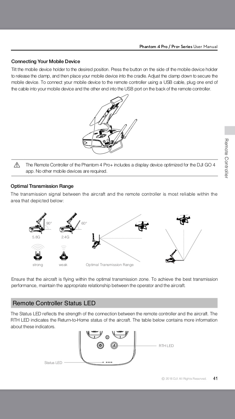

You can load missions to Litchi just fine in the air. Just make sure the drone isn’t directly above you, as the antenna orientation from the controller at this angle isn’t optimal for transmission.

You can place antennas parallel to ground when drone is directly above you for optimal transmission.
