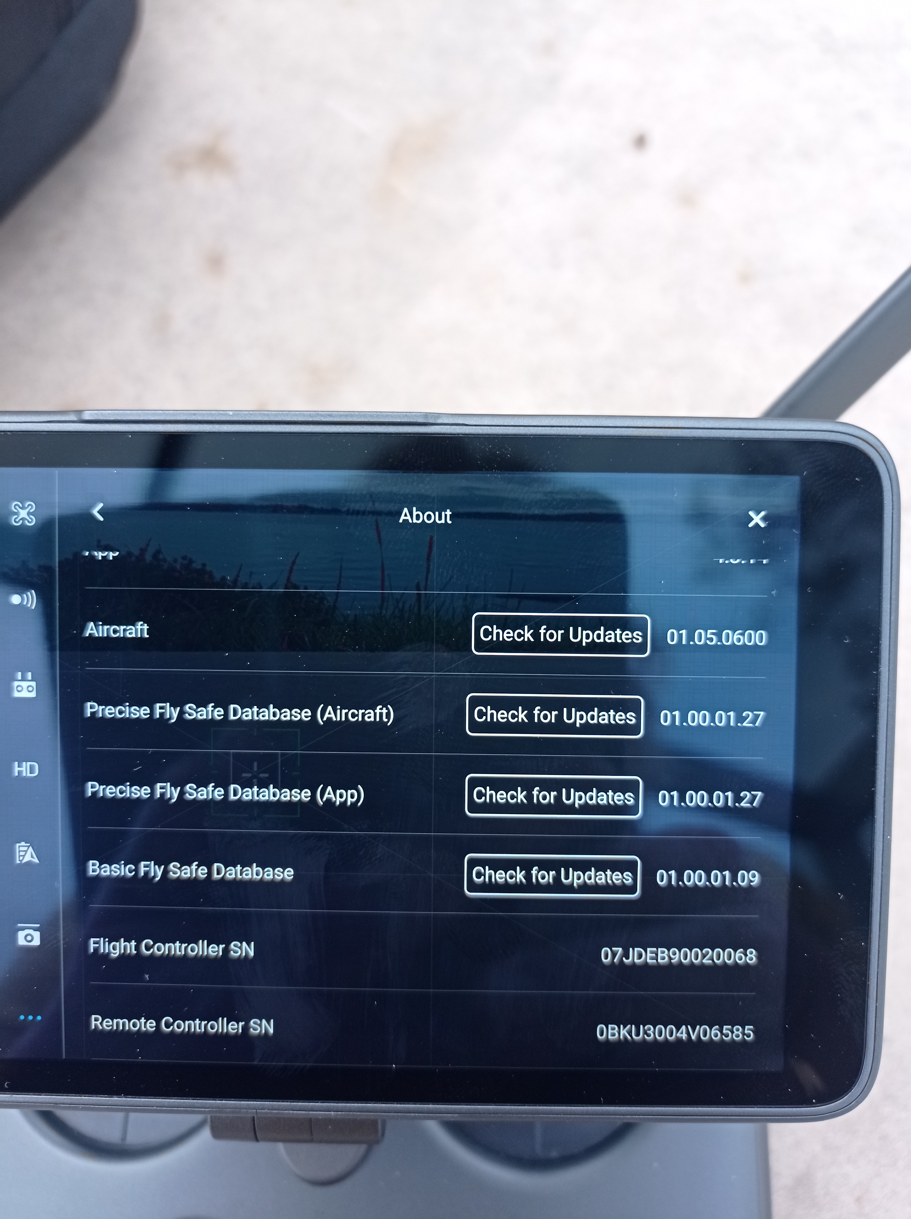

Remote: - 01.04.03.00 GL300E
(Under the 'About' with drone connected)
App: 4.3.14
Aircraft: 01.05.0600
Precise Fly Safe - Aircraft: 01.00.01.27
Precise Fly Safe - App: 01.22.01.27
Basic Flysafe: 01.00.01.09

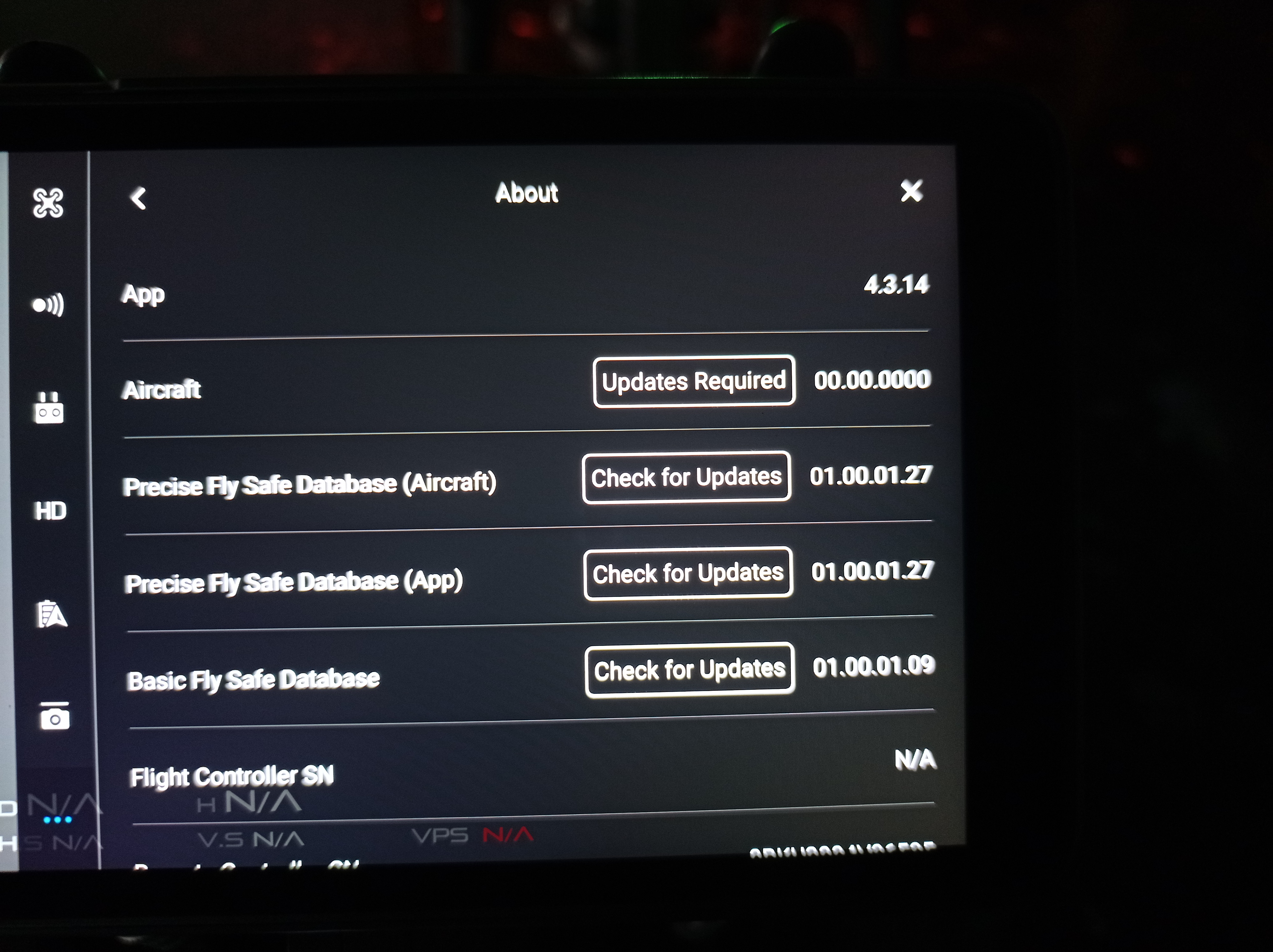

Have factory reset the drone so it's now yelling to update. Ugh!

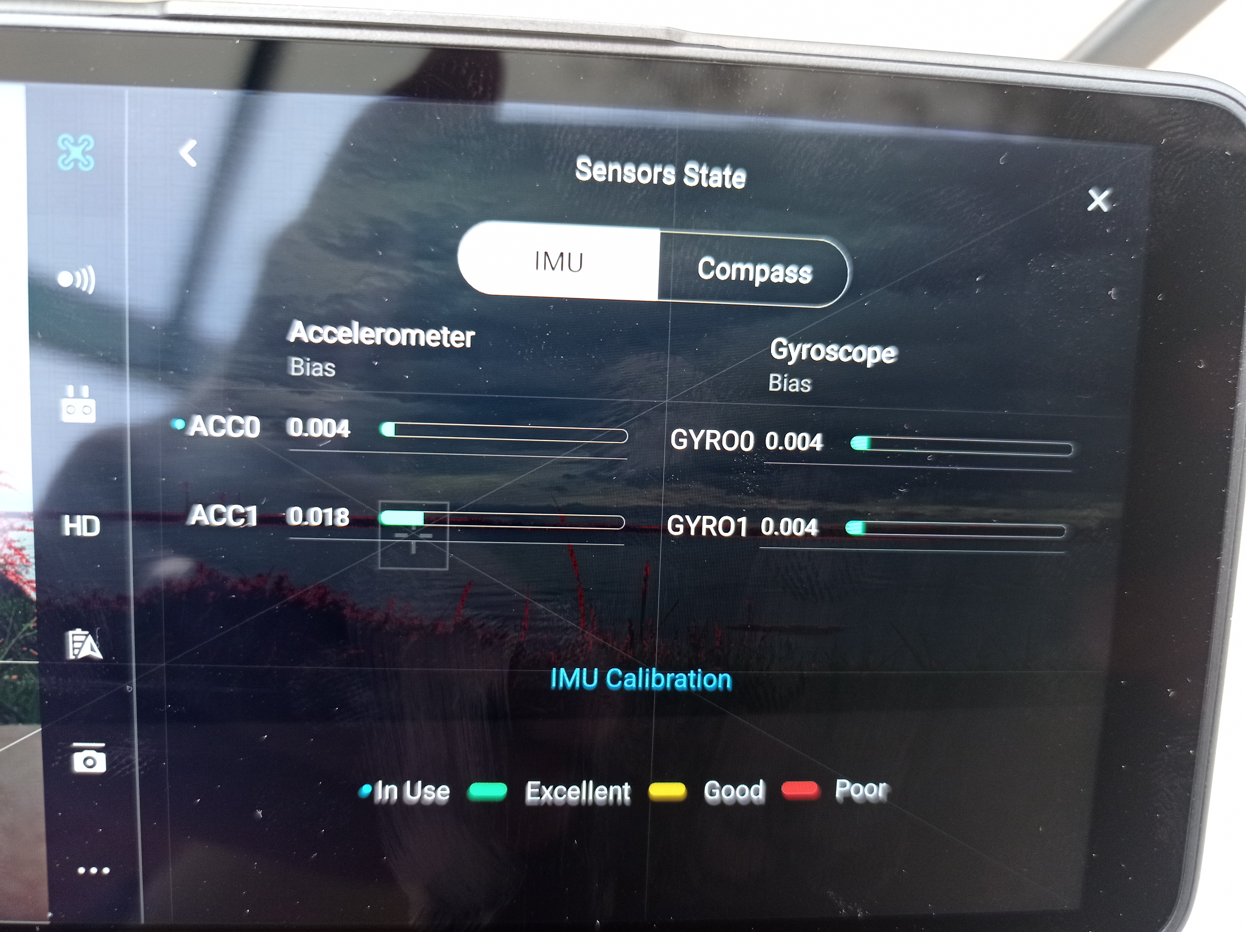

Is this normal that when doing the imu calibration it hangs? Was doing this and it didn't 'lock in' as complete. I turned the drone off, restarted, checked and it had been small, very small bar. 🤷🏼
Factory reset data inconsistent with remote so I'll update before flying jobs today.

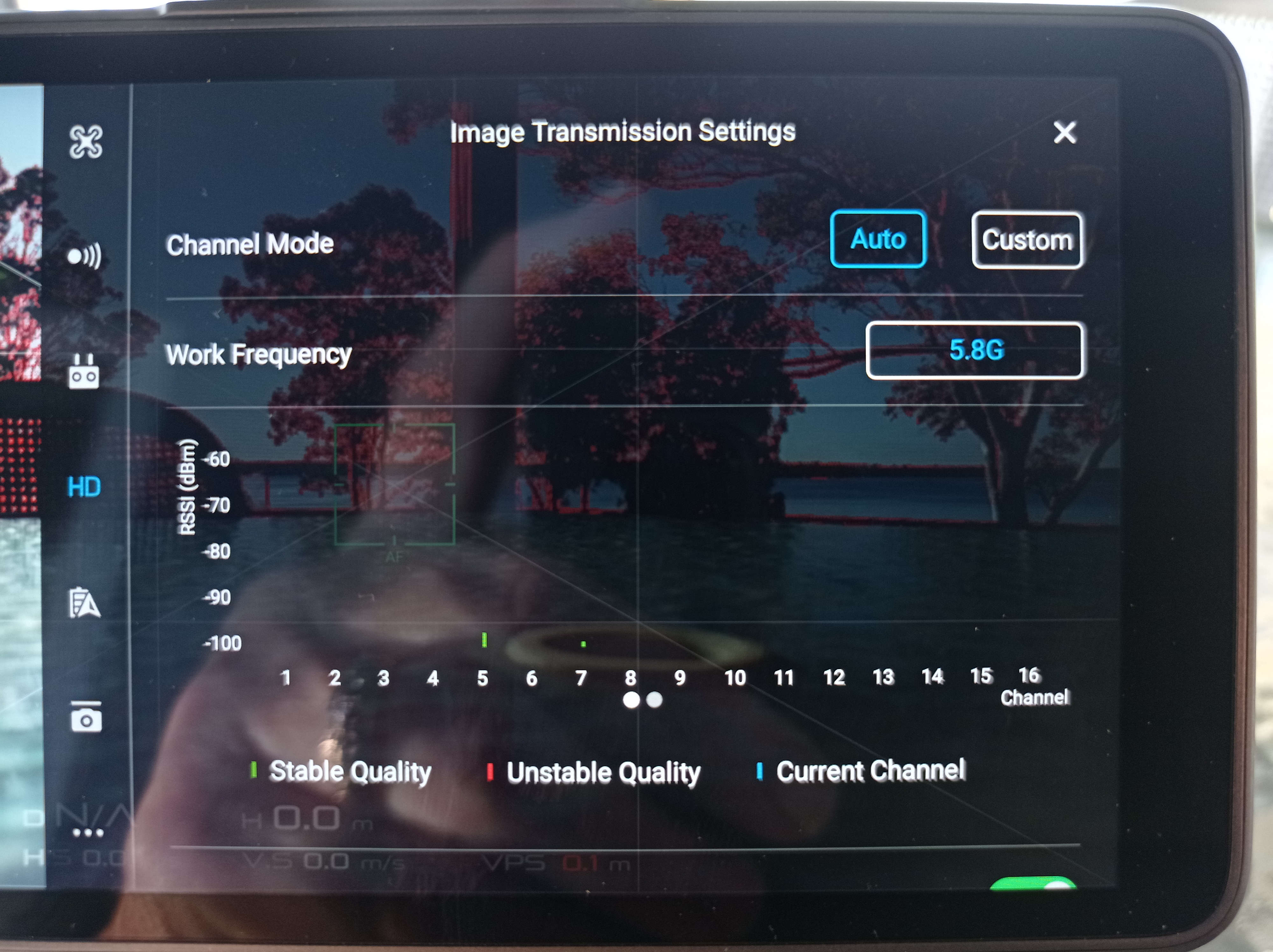

So, with the going through things I changed the channel setting from custom to auto ... Heading out to do jobs, I'll see if that's made a difference.
In your collective humble opinion is there a channel setting that's better than another? In sure it's determined by country as well. I'm in Australia should you have forgotten.

So, with the thing through things I changed the channel setting from custom to auto ... Heading out to do jobs, I'll see if that's made a difference.

So you were set on "Custom" before and just now switched to "Auto"? Who set up the Custom signal? If you didn't know this was an option, that may have been your issue.

Nope, that wasn't the issue. The glitch remained through all the jobs.
ALTHOUGH is was less on one job but back to frustratingly glitchy.

Also, it appears the frequency - when on auto - had to be changed to 5.6 each time. I noticed that and got excited that it's a frequency issue, but alas not to be. 😢
