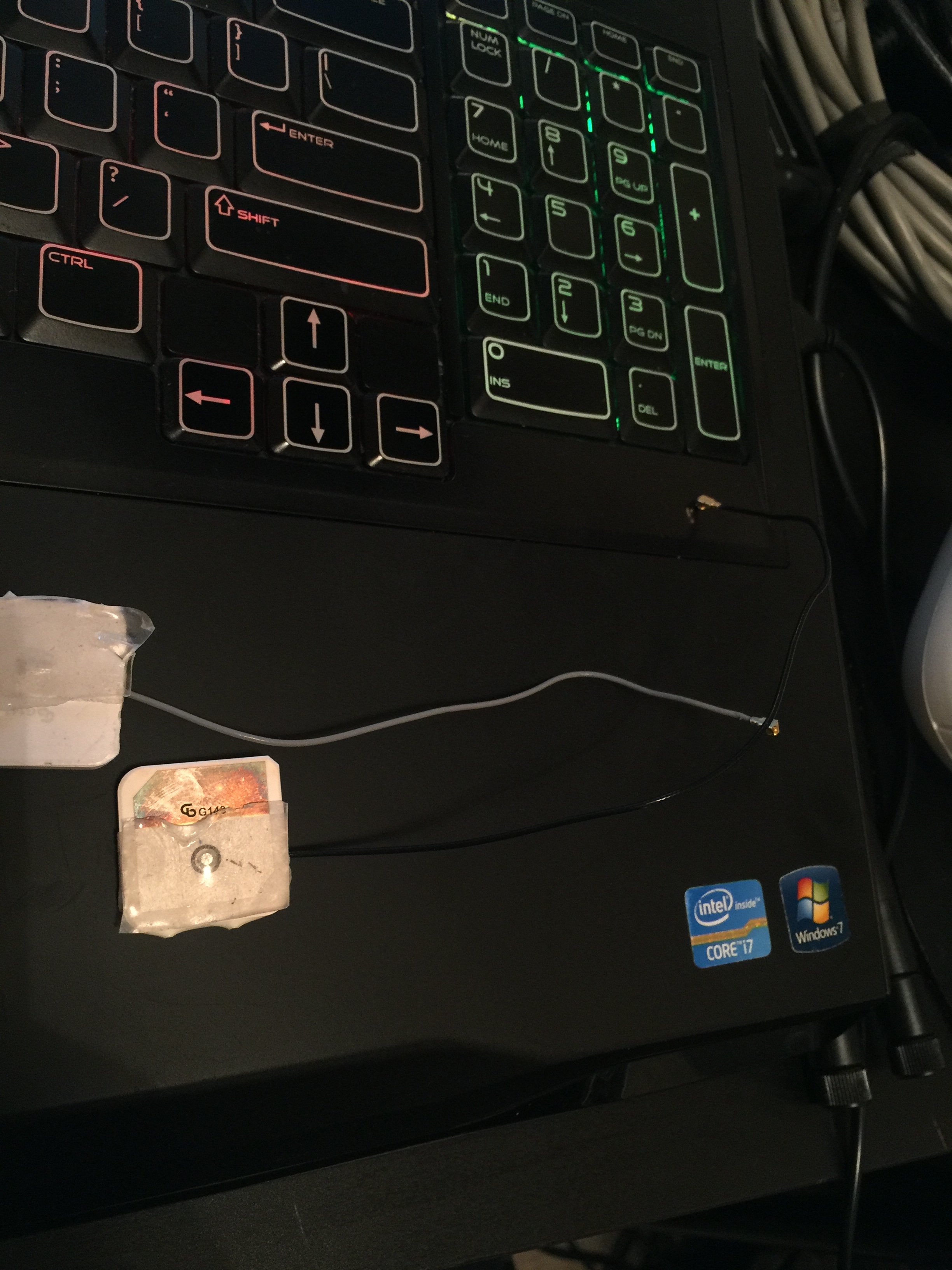

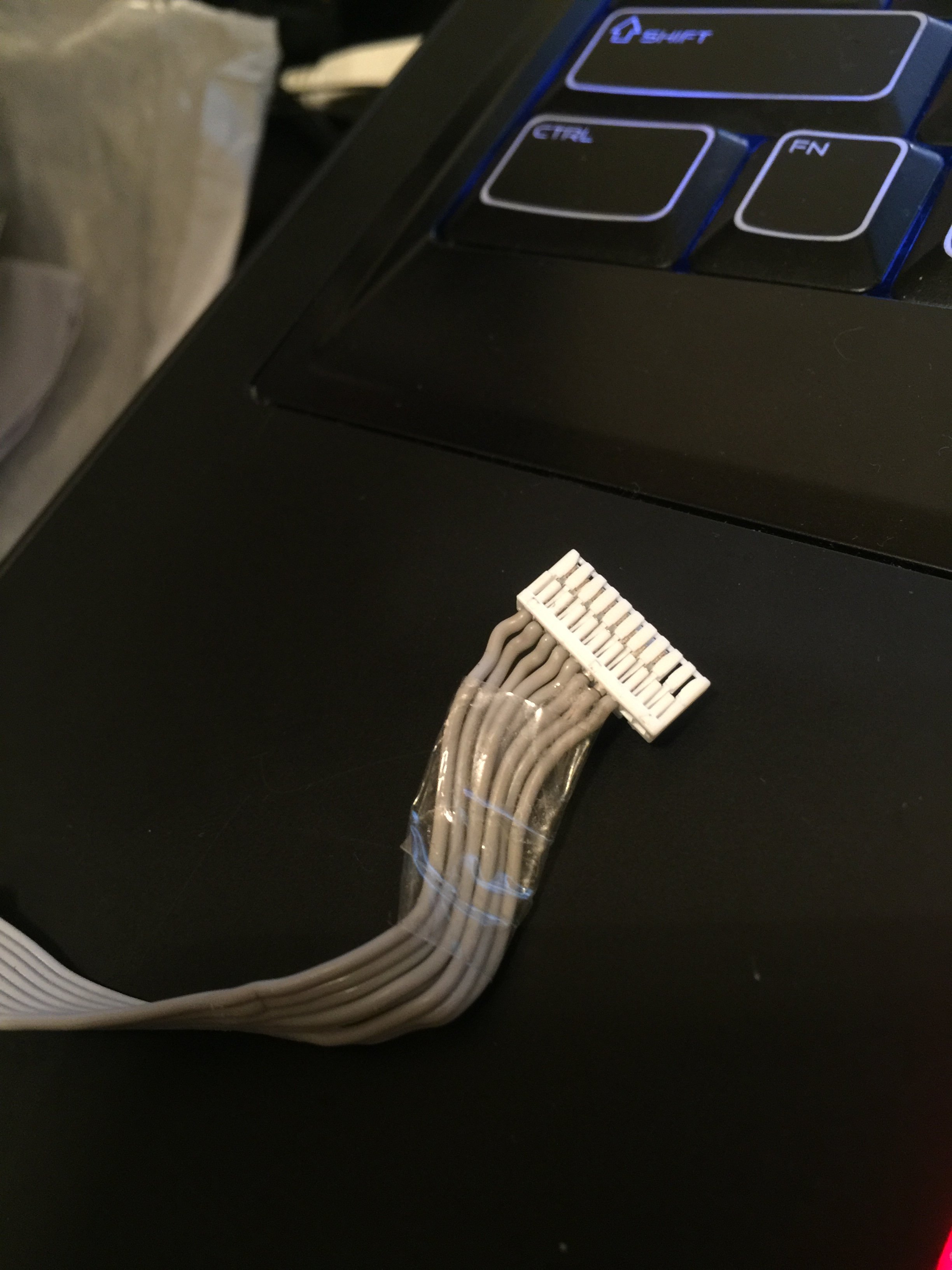

So i took my time and looked around online, i had seen someone who had attempted to repin the plug that goes into the gimbal and had a go myself

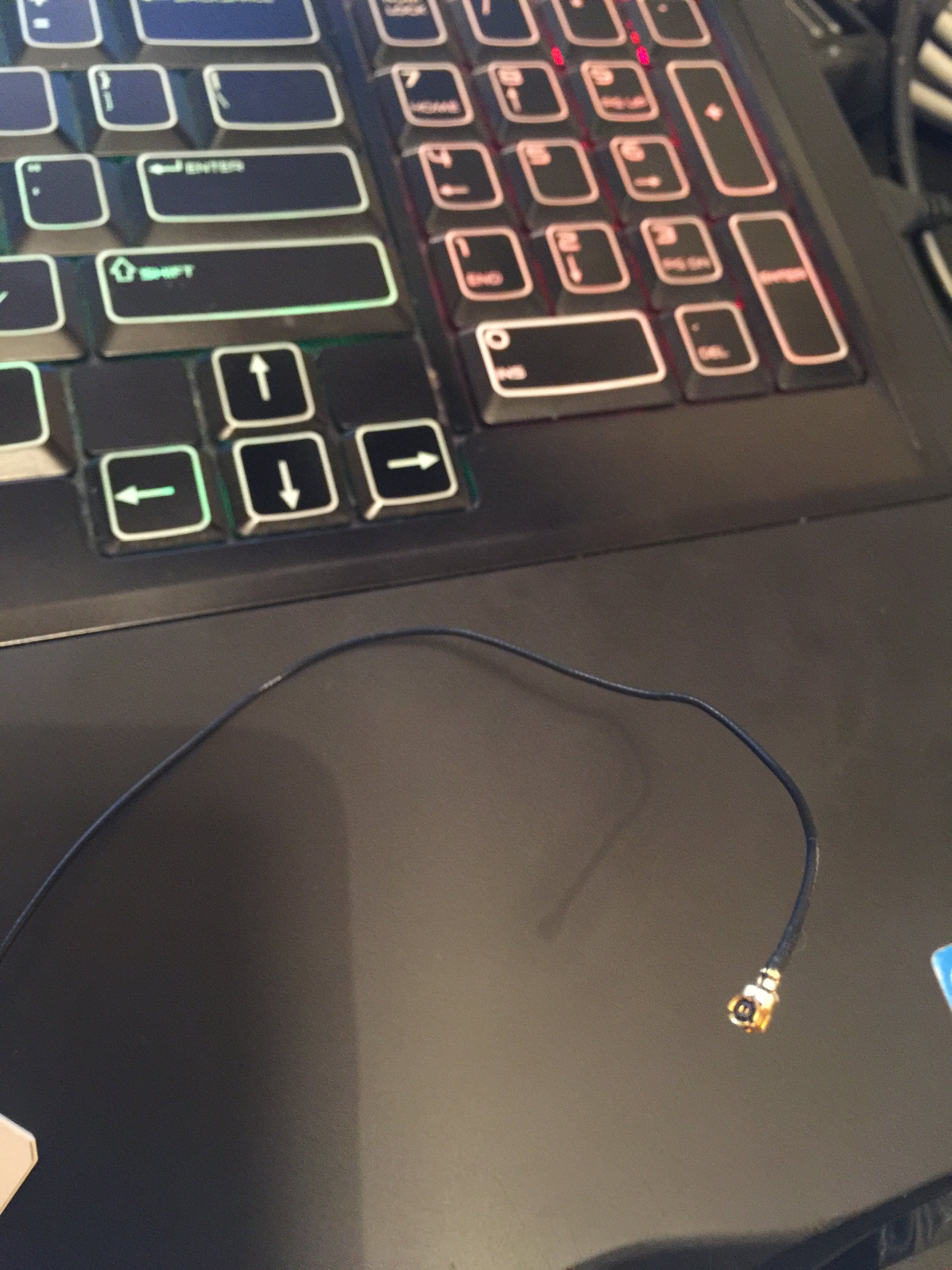

I also took the antenna cables and managed to find the ends still attached to the gimbal :eek: so done my best at re attaching them too

now the fun began.... i took the drone apart and replaced the 2.4ghz wifi antennas that had dodgy ends and also replaced the the main gimbal cable and usb cable as this was in the way at the time.

So i put the old antenna back on (on the outside) and surely enough it went back to what i had originally had in the first place. (poor but still working)
