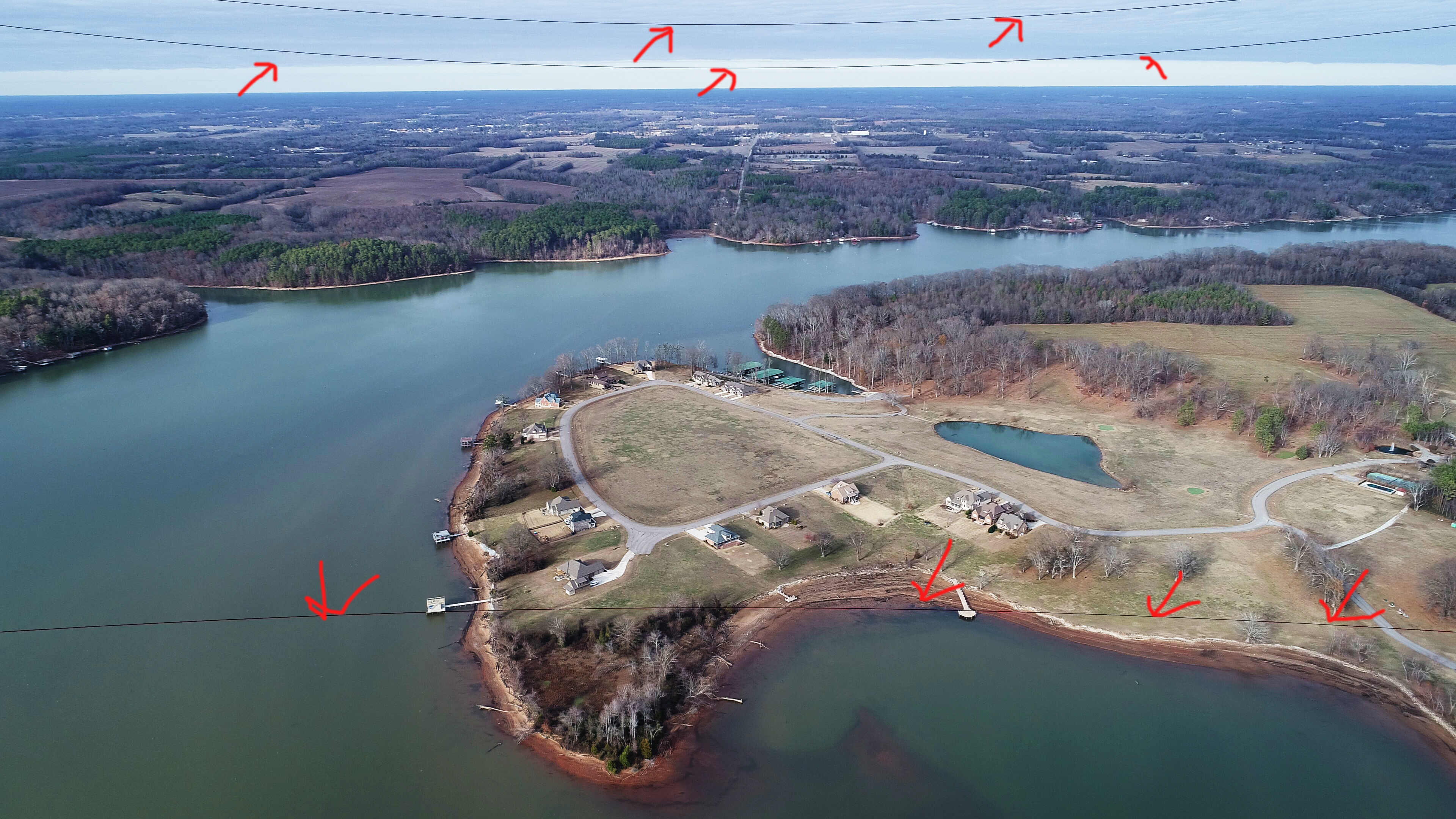

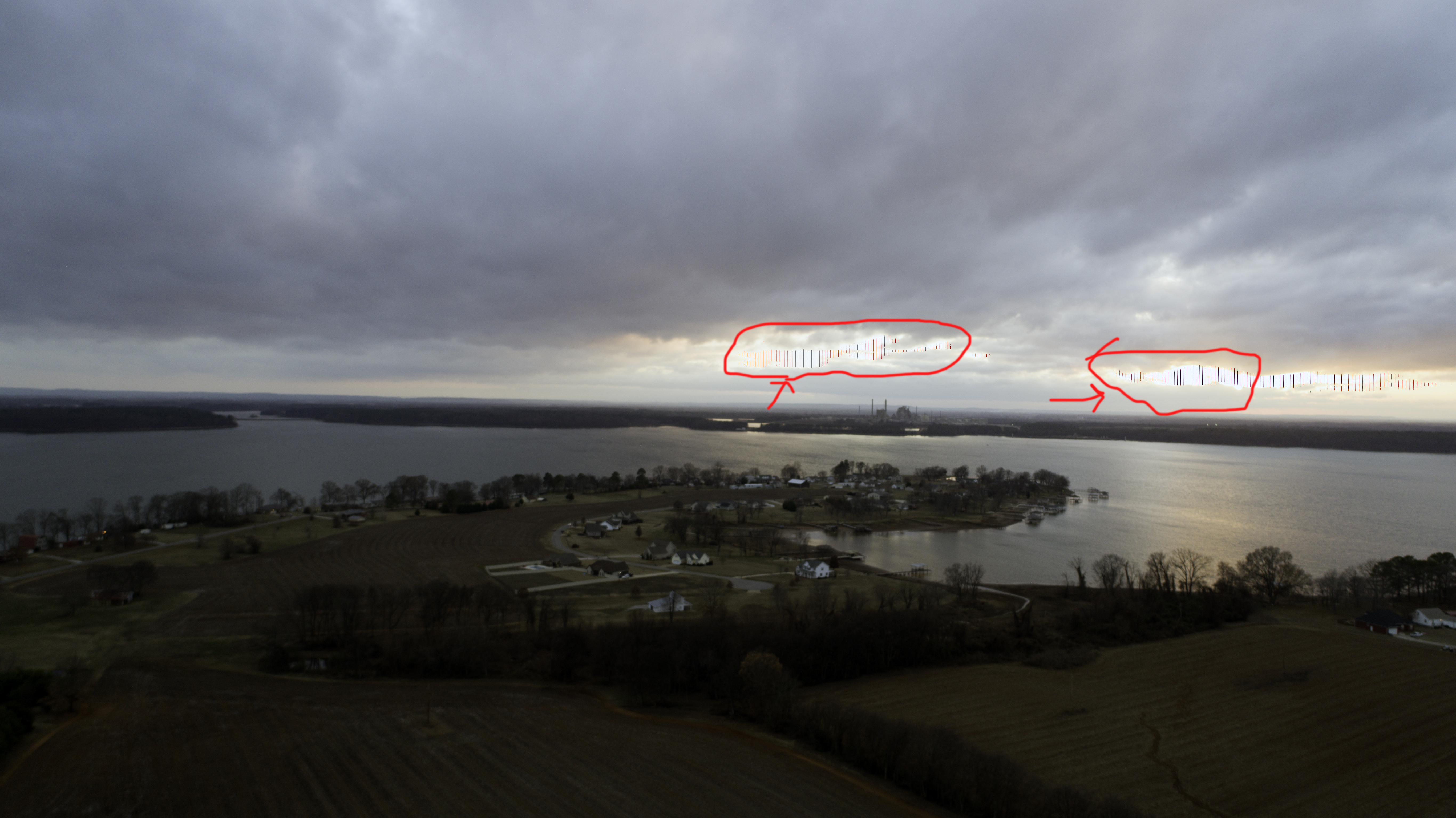

i have been enjoying my P4P since Christmas but have had frustrating results from the Camera. While I have had a few great still shots I have had either horizontal lines which do not appear to be prop lines/shadows as they are very thin - they are show up in video every 20/30 frames - PLUS my highlights are marked with vertical lines , it is that though the overexposure warning is showing up on the final output. The vertical lines appear on both Jpegs and RAW the horizontal seem only to be on the jpegs.

Fixed permissions. I have a long video that displays both of the issues that showed up in the stills plus the video jumps every so often.
That's some pretty weird artifacts you got there -- I'd say you're going to have to contact DJI and perhaps when you do provide them a link to the images posted here. Doing that will let them see it but also let them know that others see it.
