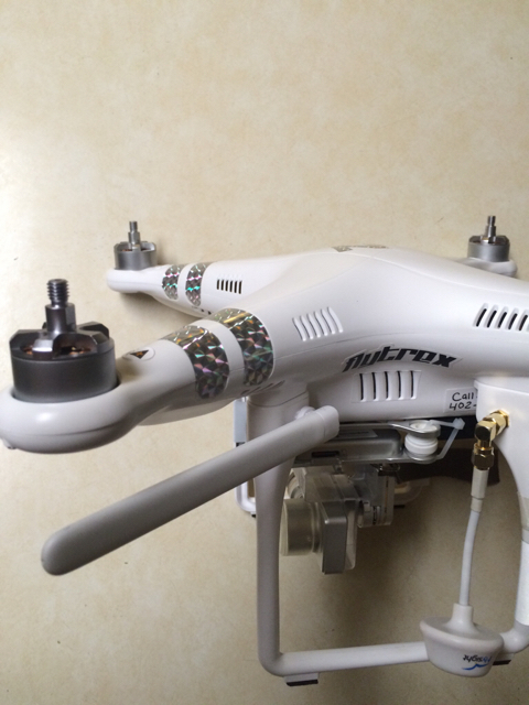

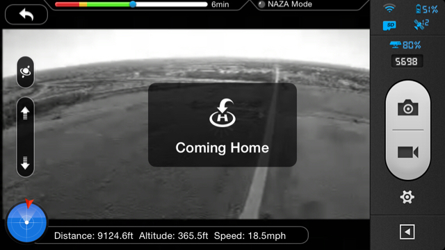

    I did the itelite/fpvlr upgrade on p3 controller and removed antennas, place just 1 of them on my friends p2v+ and doubled range! No booster app,but does use fpvlr antennas unboosted on remote. He usually got 4000-5000 ft, i've done 3 runs so far and get an easy 9000' & know it'll do a little better but its been windy on those runs. Maybe some struggling p2 users can recycle!! ImageUploadedByPhantomPilots - DJI Phantom Forum1442298813.858302.jpg ImageUploadedByPhantomPilots - DJI Phantom Forum1442298835.986911.jpg

  6. dirtybum
    Apr 14, 2015
    3,461
    1,951
    The p3 antenna is 2.4 & i did use it for wi-fi "control".
    I have (1) original antenna on receiver (1) flysight mushroom
    (1) original antenna on wi-fi module (1) p3 antenna
    Resulting in easy double range, not even trying to turn and go further after initial rth activates

    This was just an experiment to get my friend a little more range/depth w/out sticking antennas out all over like my two ton p2v+

    1,951
    Louforgiveno....I forgive you! The answer is simple my friend, both!! I put only (1) p3 antenna which is 2.4 on the wi-fi module&still use (1) original module antenna, then i put (1) flysight omni 5.8 on the reciever kept (1) original antenna left on!!
    PRETTY SIMPLE STUFF if you are familiar with upgrades! Hope this "put the glasses on" for ya. If your still using original antennas on ANY phantom model or remote & are not happy with the results dont be afraid to try new antenna combinations until you find what works for you!
