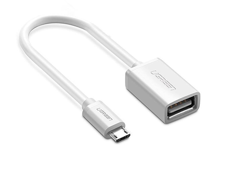

I bought my Phantom 4 used and I did not get the USB Otg cable with it. I am using a Apple iPad Pro 9.7 with my receiver. I am using a lightning to USB Cable with my iPad. what combination of USB OTG Cable and cable to connect between OTG and Receiver do I need to buy for upgrading firmware?

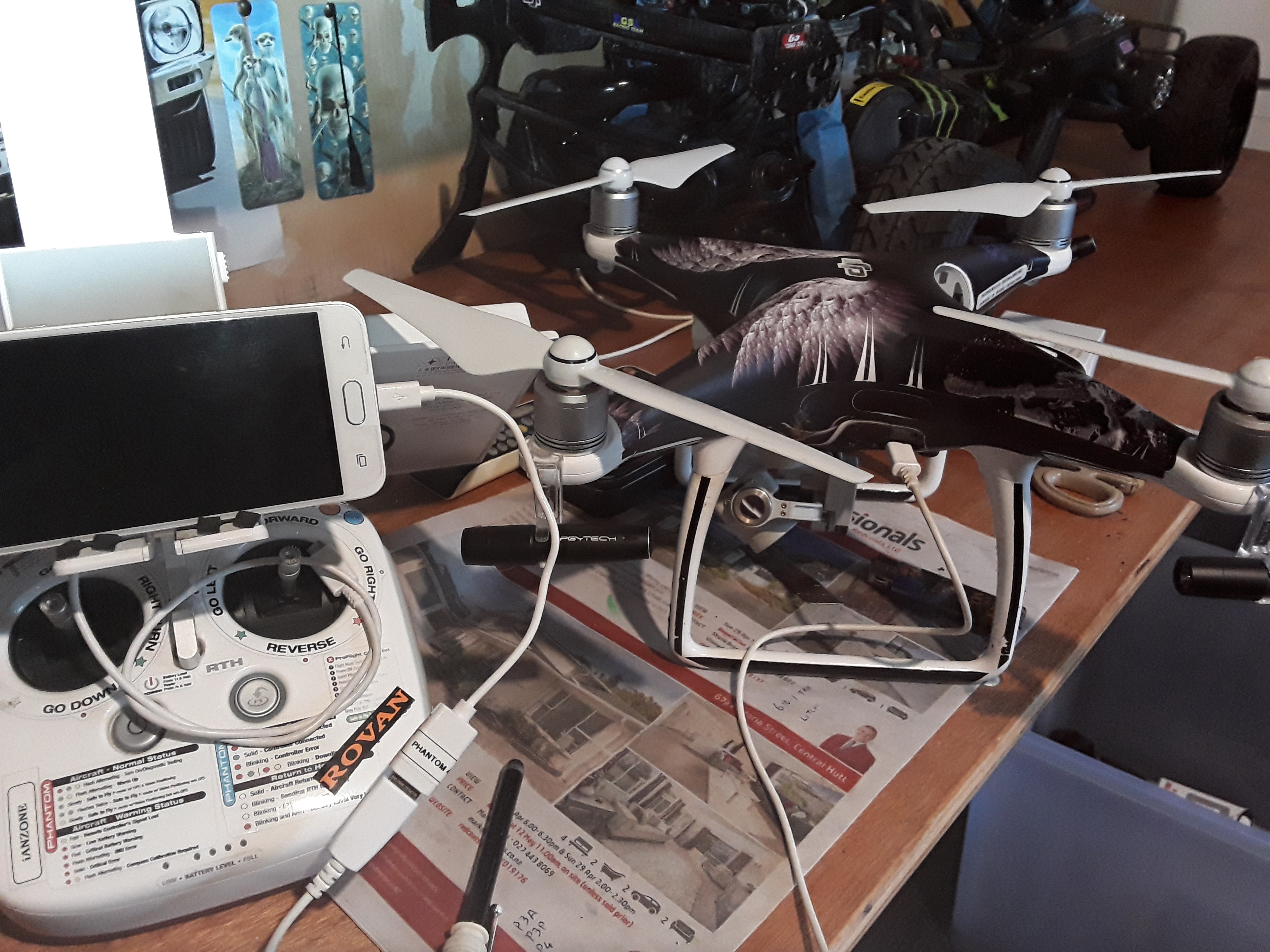

I have updated the firmware on my remote control with the ipad attached with a lightning cable; but cant seem to update the firmware on the Phantom 4. I have also connected a mini-usb cable from the phantom 4 to my computer, but still having no luck.
You need OTG cable adapter for your usb cord then you can plug into your device and p4 usb slot to update aircraft,your device needs Internet to download new firmware , then you plug into drone and update,,I has always done firmware this way,no computer,,
