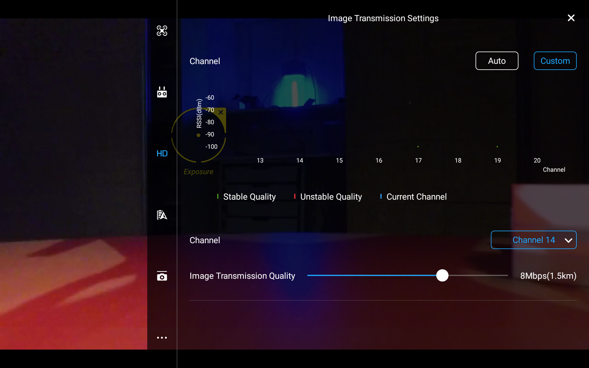

The slider you all are talking about only changes the quality of the video feed from the aircraft to your device. That is all. Setting it lower allows for further distance before losing video feed. Setting it higher gets a little better video feed on the device, but it will lose the feed before a low setting when getting to the range limit.

Im in Europe too. To get the slider, you just have to disable "auto", and put it on 'custom'. With me, the slider has always been on "auto", and the bitrate does seem to vary. In fairness, not to 6, so Id like to see some 6+Mb cache video's

Mine displays that adjustment. It goes from 2MB to 10MB. I am using the latest updated version of the app. Updated yesterday again. It does make a difference. In range and the down link quality. I have the P3 Advanced.

So you bought a new camera, instead of adjusting this setting at the bottom:
Which is available on both P3A and P3P.
