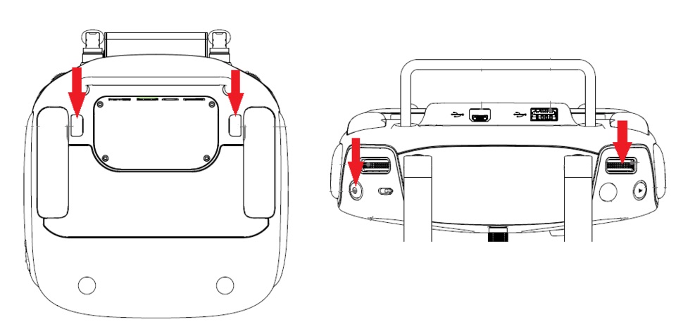

A lot has changed with the RC update procedures since Tahoe_Ed made that post in August. I don't know if it even works at all anymore. You can however try again with this photo as a guide. I got the photo from another user.
I was able to solve it by updating the DJI Go app when a new version finally became available (currently running 2.4.2, 1.4.10 on the aircraft, and 1.5.70 on the RC) - are you up to date?
DJI GO App version 2.4.3
I DO IT....
I press C1 + C2 + REC + Photo buttons and Power ON.
GO app ask for upgrade and it was success.
Green light and connected with aircraft.
I DO IT....
Excellent. I'm glad it worked for you. It's also good to know that it still does work. Cheers!
