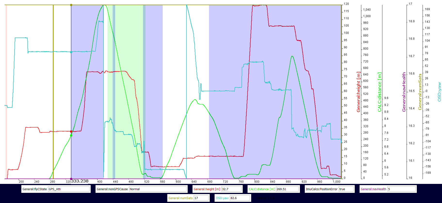

Thanks the flight logs are here, I can view it on google earth and you can see the red line in the flight where it went to Atti mode and I flew back, this is just after the second 'tilt' in my vision - I'm flying with the googles here. DJI Flight Log Viewer - PhantomHelp.com any help is appreciated I noticed a yaw error around 7 Min 6 secs EDIT: I noticed it shows GPS the entire flight, this was not the case, the warning for 'atti mode' came up where the red line starts, and when I brought it back to me, I want neutral stick and the drone drifted with the slight wind. So I don't know why the logs say GPS. Interestingly though if I was in atti mode, why could I still see my diamond in the goggles? IT still knew where home was.

Are you 100% certain this is the correct log? There is no ATTI mode in this flight. Your Sat count and NAV Health are fine. The only issue I see is you did have an IMU Positioning error at ~ 332 seconds and this continued intermittantly through the flight. ( Area's shaded in purple below ). The YAW ERROR, is usually indicative of a compass issue. I mention the Nav Health, because this signal must drop below 4 for an ATTI switch. It was at 5 for the entire flight. If you are certain that this is the correct flight, you may want to extract your aircraft .dat file for a deeper look. See this link for how to retrieve it Retrieve Aircraft .DAT For this flight you will be looking for FLY151.DAT

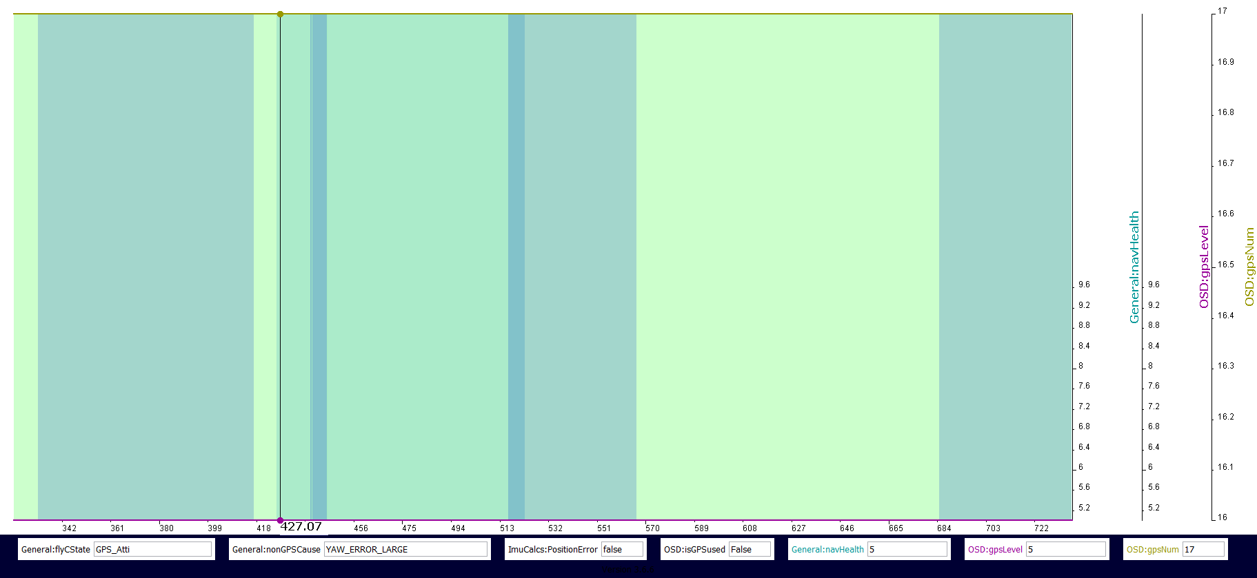

@Davious An addendum to the above. Looking a little farther in the log, you could very well has recieved an ATTI mode message. However, it does appear that the aircraft never actually switched to ATTI. The :isGPSused flag went false right at the YAW error. This is a bit odd, but I suppose it could happen. The aircraft .dat might tell more.
