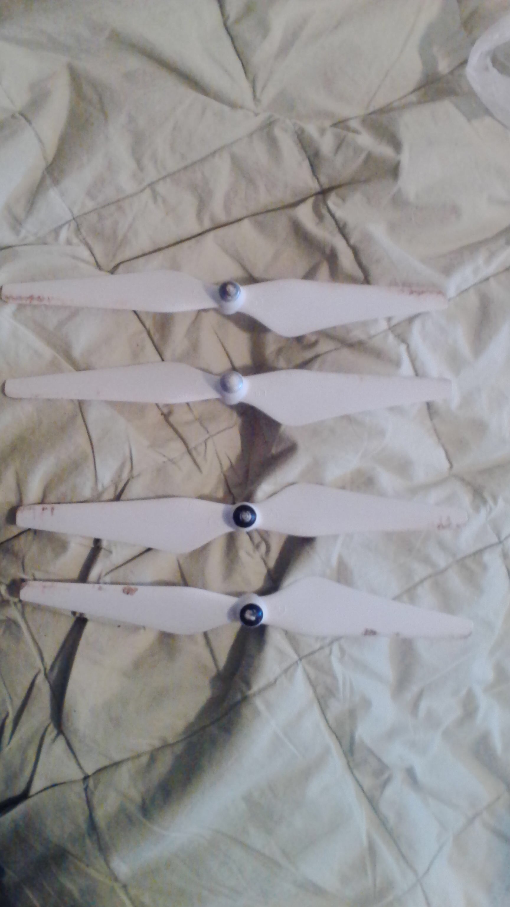

This is how my props look now. Can I still use them or get new ones?
Do you have a prop balancer? They don't have to look pretty to function properly, but vibrations can take a cumulative toll over time.
Reactions: Fplvert
Balance is important, but even small chips can induce vibration. Error on the side of caution if they have any visible damage. Use your spares and order some new ones.
