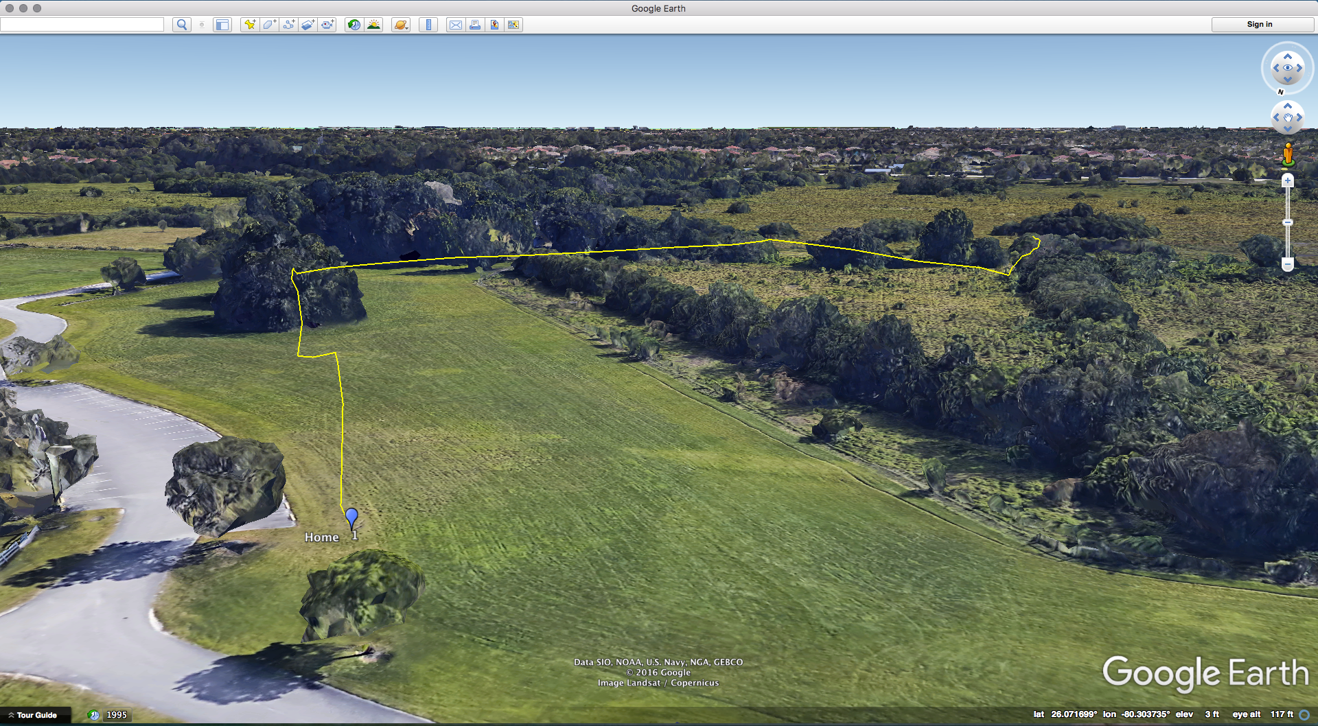

I was flying about 2 weeks ago in a field at about 86 feet altitude when my Phantom 3 Standard suddenly dropped out of the sky. The shell was badly damaged and the gimbal snapped off but surprisingly with a new shell I was able to get the bird flying again. In fact, flying flawlessly. I took it up to 400 feet, dived, flew around generally for about 5 minutes and it performed perfectly and the camera worked perfectly.
I had expected a failed engine or something I assumed would manifest itself when I put the bird back together in a new shell but I have had no problems, so I don't know why it crashed. I have looked at all the relevant log files but there seems to be no indication what happened. Can anyone see if I missed something?
I was flying with the Litchi app and the link to the flight log data on Airdata UAV is here. Also I have uploaded the .dat files from the drone itself to my Google Drive here.

I looked at your .DATs. The incident was the third flight in FLY266. There was a battery comm error at time 446. (The flight began at time 426) After that the battery data was constant, indicating that the data being reported was just the last data before the comm error.
The end of recorded flight was at 479 secs. Is it possible the battery came loose?
This is a P3 Standard which has limited motor data. In particular, motorVolts data is not reported. motorVolts can usually be used to determine if the battery came loose.
