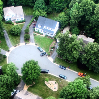

See anything ? And no it really wasn't in the trees like it appears
Pic shows the clearer flight path. I was just going to take a pic of my neighbors house

on board video? What surface did you take off from?
Take back what I said about maneuvers that wasn't csc.
No telephone poles. All the power lines are buried, probably near the end of the driveway. Don't know if it would be a problem, just an observation.
My culdesac has been my go to practice area since I purchased my 2 in 2013. Never had the slightest issue that wasn't caused by my inexperience.
No on board video. I was going to take some photos of my next door neighbors house -
