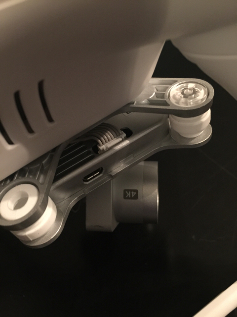

Ok I'm back looking at this and it may be fixable. I'm missing 2 clear plastic fasteners and my camera is upside down.
Biggest concern is how to get the lens facing the correct direction. I was scared to force it. See pic :
Ok. That's great to know. Seems like I'm only one step away from calibration which is a hell of a lot further along than I was this morning
