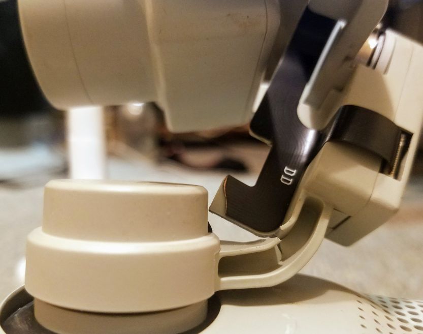

Visible damage
hit tree ...aprox 20 mph
Fell 60 ft
landing gear one side known damaged
gimble looks bad....but all motion feels smooth.....
camera was jerking before crash....led me to believe possible board issue on gimble....
Gut feelings says go with the 600 something dollar replacement cam and gimble....landing gear and labor......
Doesnt seem to make sense dollar wise.
Hoping to buy another bird ...if can get around 900 to 1000.
Any possibilitys of putting some budget camera on this unit and play / experiment with it ?
Seems older phantoms have go pro aftermarket mods and such.
I have a Spark so I can fly....
Link is to my google photos.
Sorry to hear. Ya that gimbal looks bad
Yep, that’s a full gimbal replacement, as well as gear. You could always join us in rebuilding drones, as that’s half the hobby of flying, but if you want to buy a new one it’s understandable. If you are looking to repair the drone yourself, there are many members here willing to give tips/instructions on how to do it.
Camera inside gimbal may be salvageable if it isn’t scratched/cracked, which can reduce cost of full cam replacement.

Gimbal can be repaired. I’d try it and see if jerkiness goes away. I fixed mine after a bird caused unexpected landing in parking lot. Landing gear is an easy fix. You’ll need long shafted hex/Allen wrenches. 1.5mm and 2.0 mm.

If you think this could possibly be glued a lot of people don’t know that using a couple drops of super glue and putting baking soda on the glue makes like a fiber repair

Just buy the parts from banggood as long as the camera itself is ok it should work out at £108.13 in uk and should be around the same in $ look here :-
Gimbal Camera Upper/Bottom Bracket Yaw Motor / Roll Motor For DJI Phantom 4 Pro hope this helps.
Totally fixable, unless you run it over or get it wet there really isn't any reason not to fix a P4P. From that picture, it just looks like it needs a Yaw Arm, Gimbal Ribbon Cable, and most likely a Yaw Motor. We see way worse than that every day.
