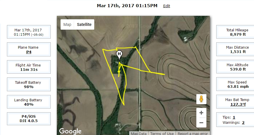

63.81 with a nice tail wind.

Those numbers would be right for km/hr but not mph.
I find it hard to believe that your Phantom goes so much faster than everyone else's or the published specs.
Balancing your props won't make any difference to speeds.

Actually if you are running the latest firmware, the speeds are limited in all modes except ATTI. This is confirmed by DJI- even with a tailwind in sport mode it will max out at 45mph.
And in P mode- there is absolutely no way you "consistently get 45mph". There was a bug in previous software that listed speeds in km/h even if set to mph. You clearly have that.
And again, balancing props on a P4 is irrelevant, meaningless, and frankly a waste of time for half a dozen reasons including but not limited to aerodynamic irrelevance and that props are not the cause of any jello/rolling shutter effect anyway.

The speeds you quoted are well above the still air speeds that a Phantom can achieve.
You would only go that much faster than the published specs with a big tailwind assist or confusing km/h with mph.
Exactly! And he says he "consistently gets those speeds" so I think it is more likely he is confusing mph with kph. And with the latest firmware updates the P4P won't even go over 45mph with a tailwind unless it is in ATTI mode.

Long enough to know that the "Top Speed" displayed in the app is completely bogus.
Go to the flight you did 64.3 mph on 27/11/2016 and replay it in the app.
See if you can find anywhere in that flight that you got anywhere close to 60mph.
I'm guessing the fastest you'll find is about 40 mph

There's a well known glitch in the app which shows the Top Speed in km/h despite saying it is mph.
Your Phantom doesn't go any faster than anyone else's balanced props or not.
