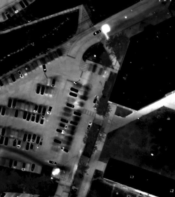

1. Thermal Infrared of the campus - by plane ~$10K to $25K per year:

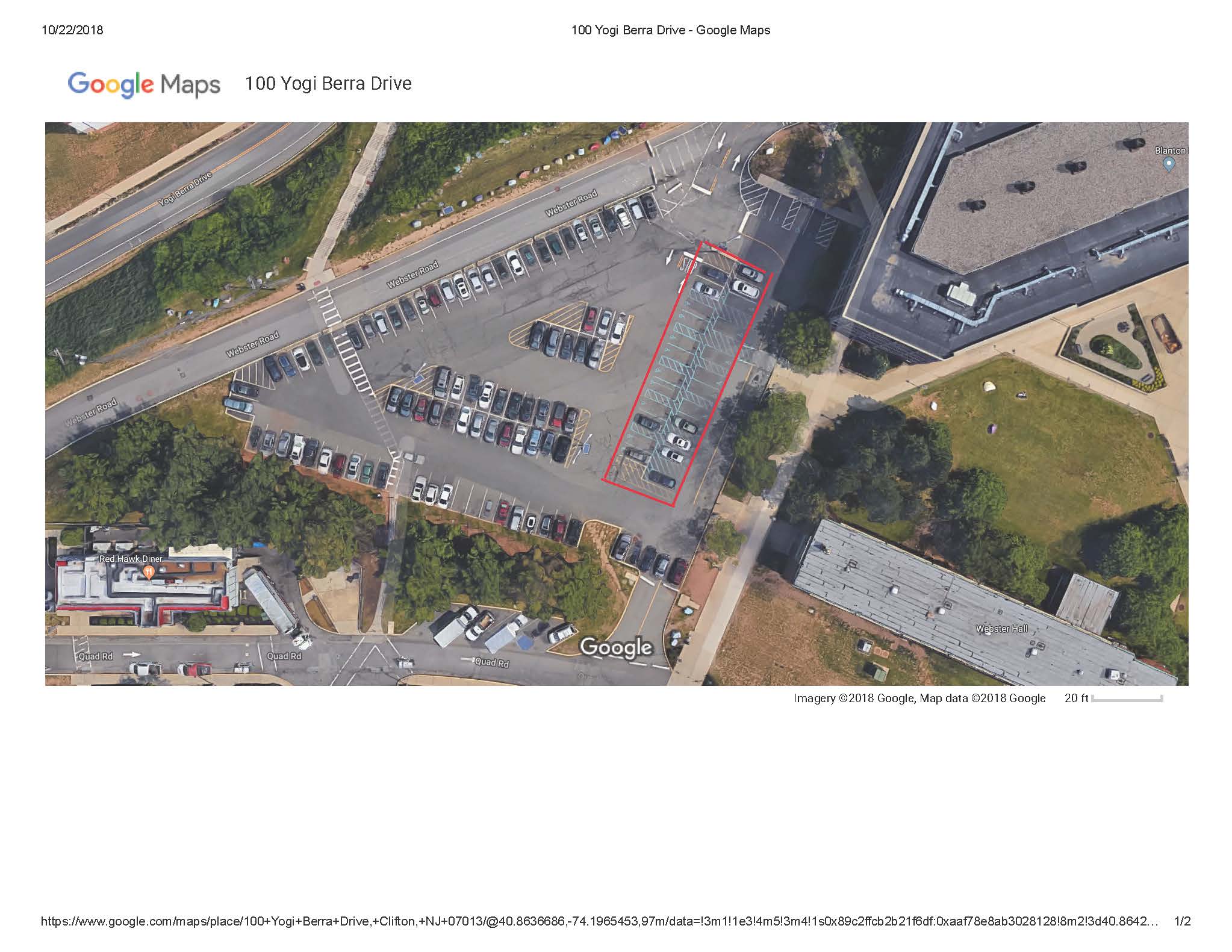

2. Google Earth image - best guess of where the leak occurred

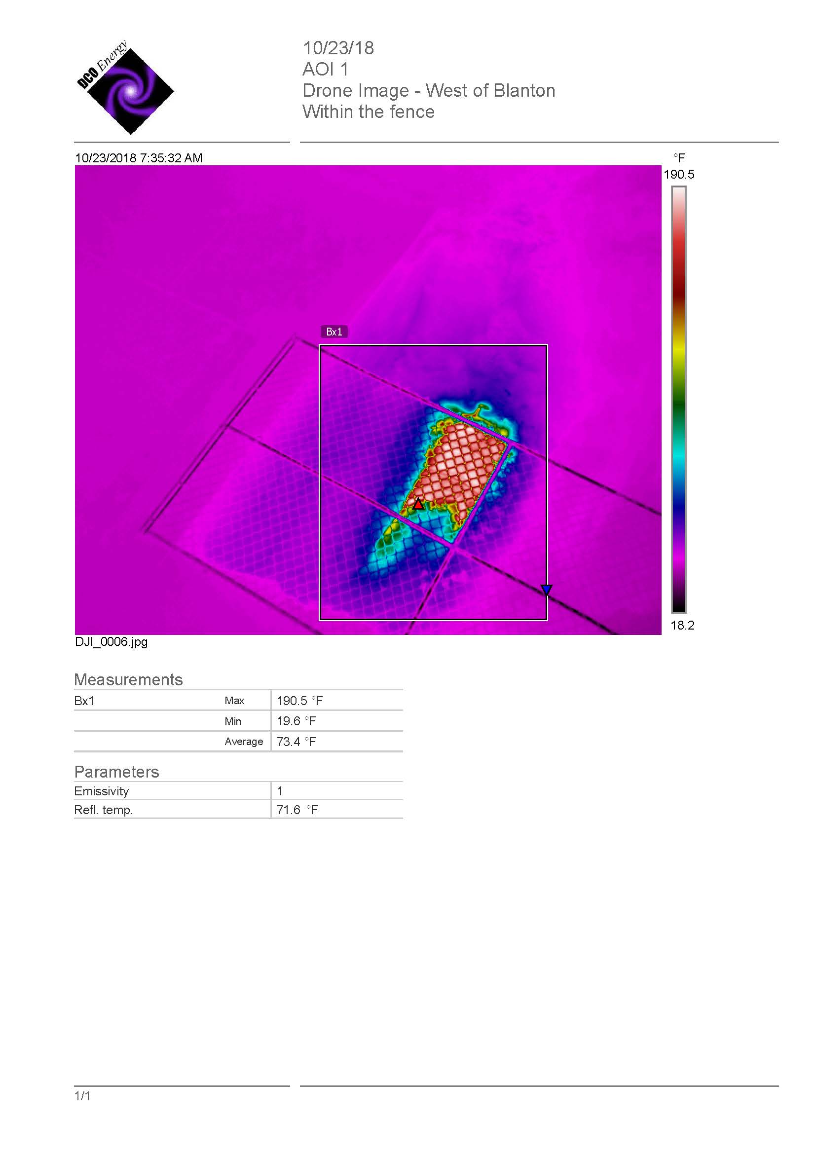

4. Area of Interest (AOI) 1: Ground temperature (19 degrees F) /Excavation (190 degrees F)

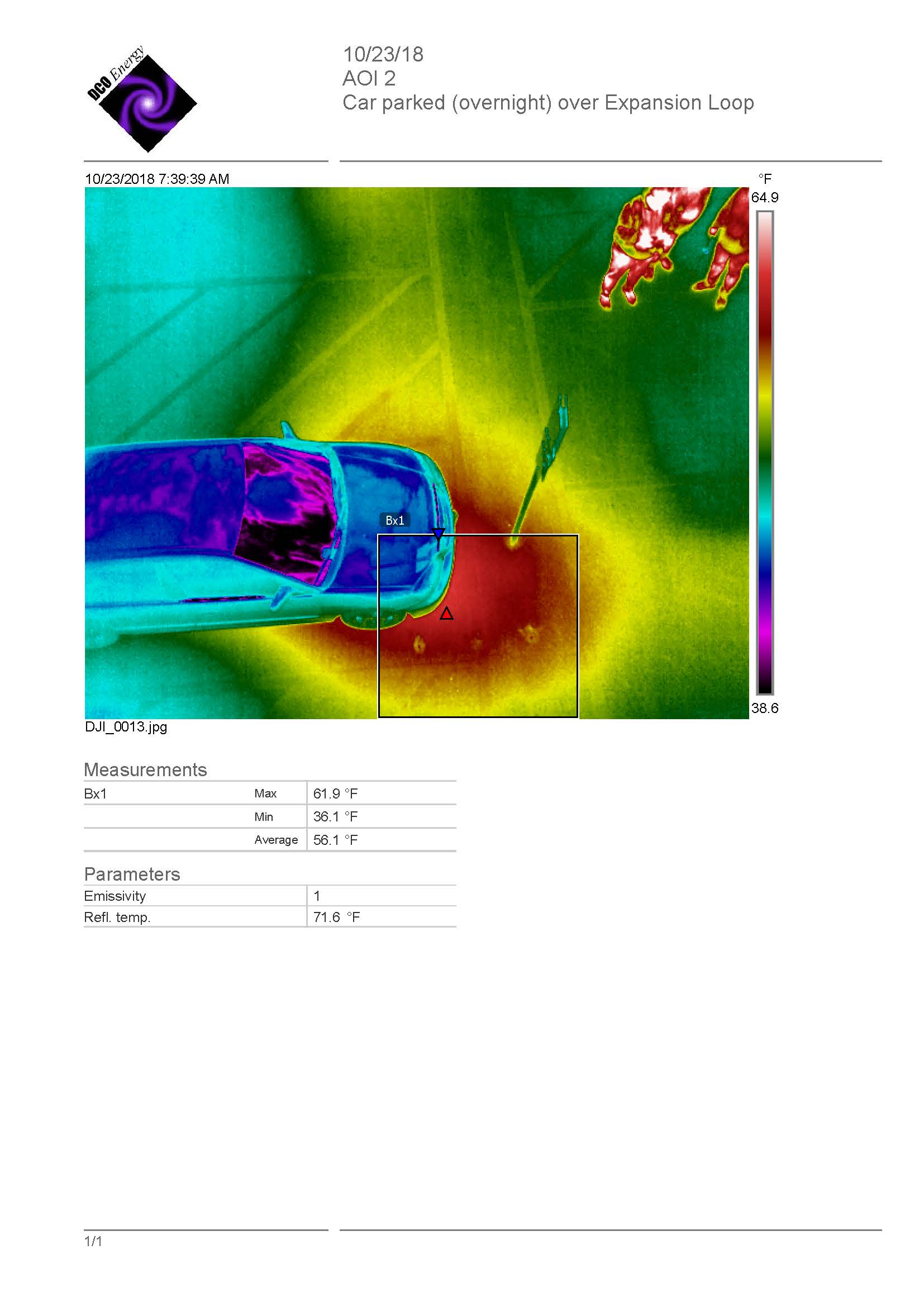

5. AOI 2 - Area under the car was 62.7 degrees F (car was parked overnight/engine cold - 33 degrees F) pipe is ~6ft underground at this location

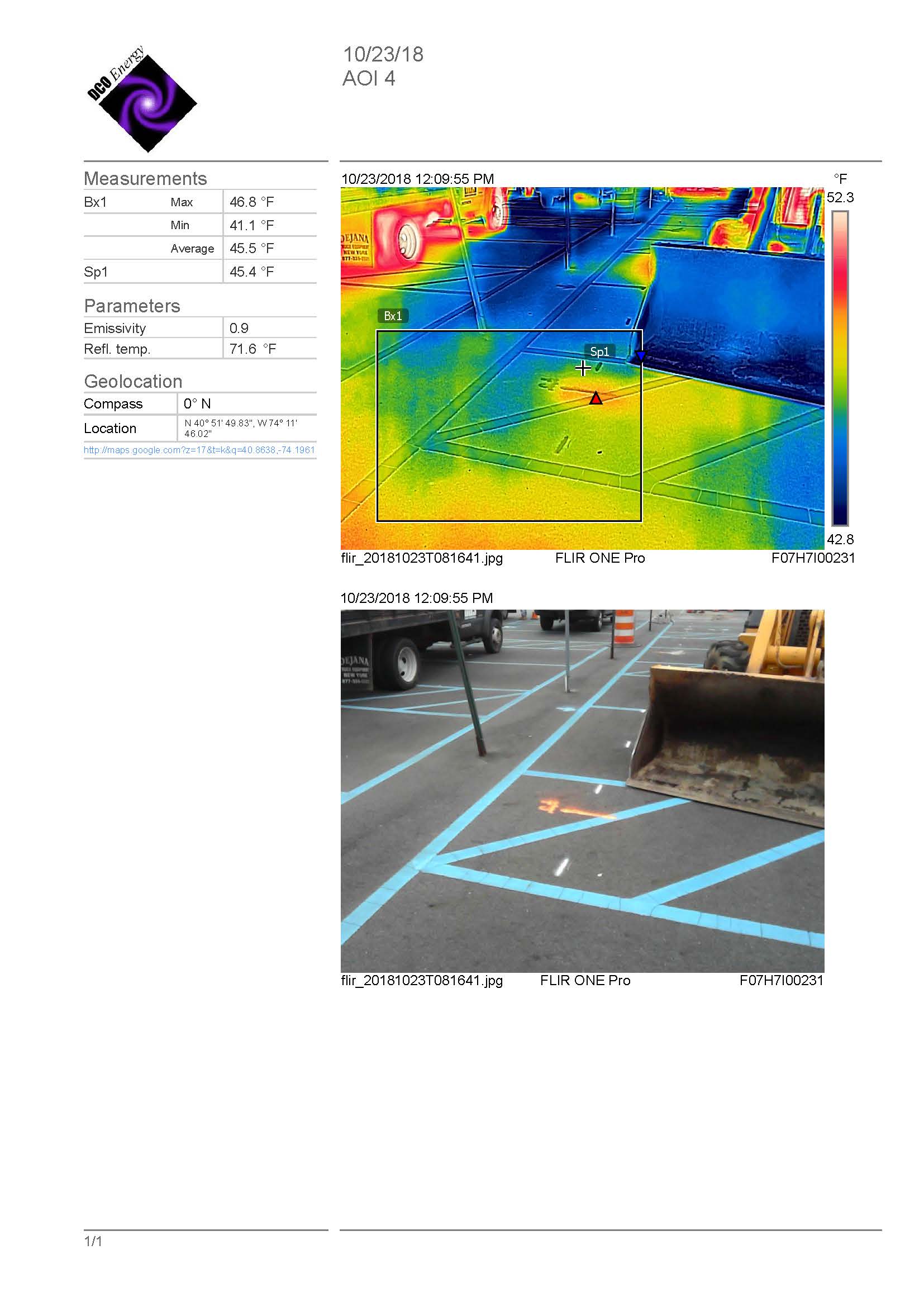

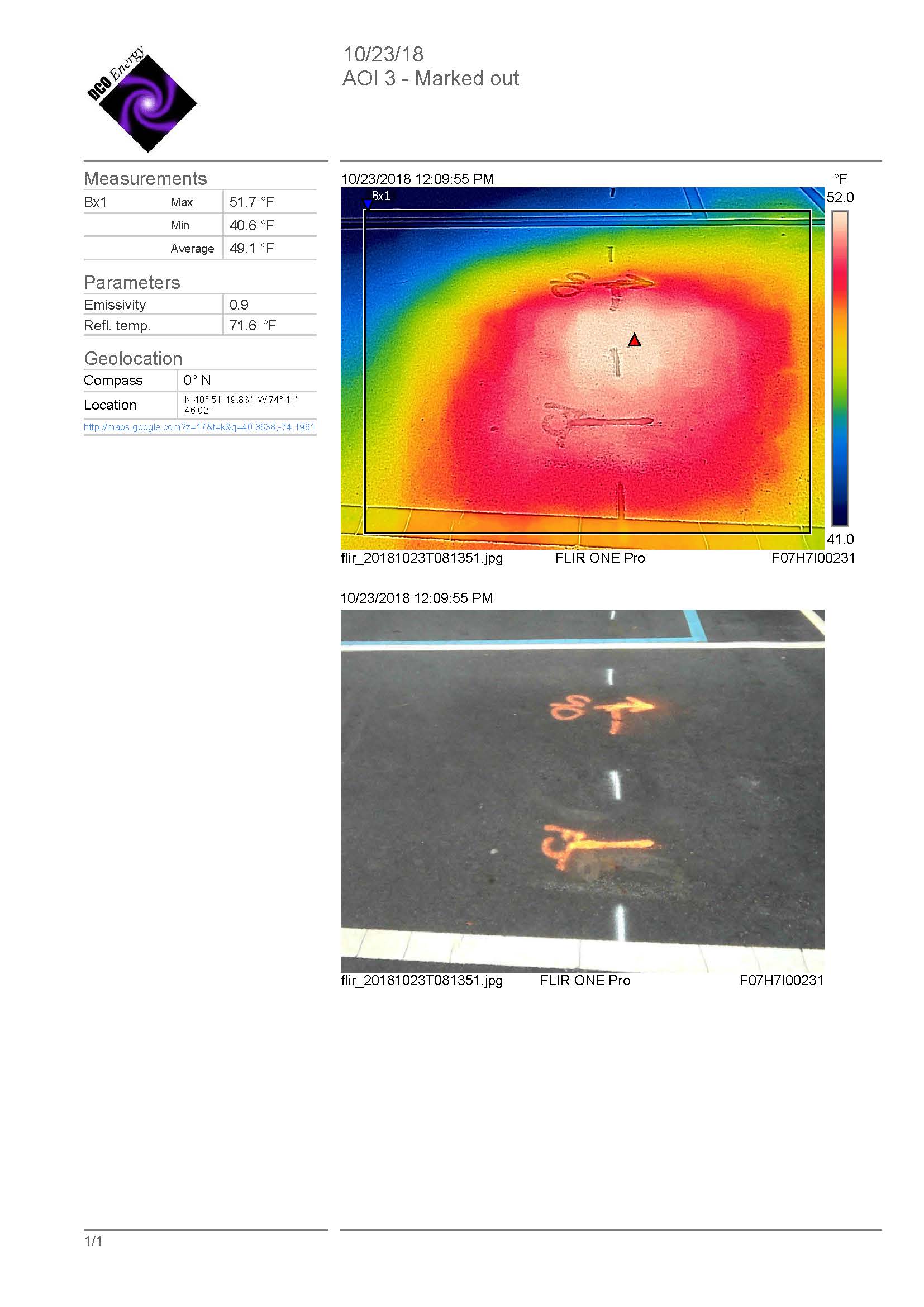

6. AOI 3 and AOI 4 - surface temperatures are close to "normal". Indicates pipe break is north of this point.

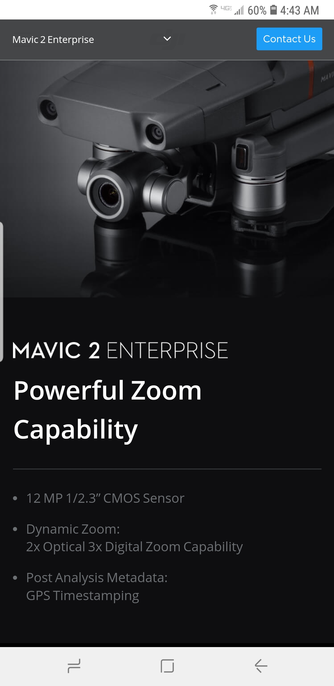

I looked atthe enterprise model and i dont remember seeing that. Is it a newer release? Looks like exactly what i need for now
The Enterprise "Dual" has the Flir Radiometric camera.

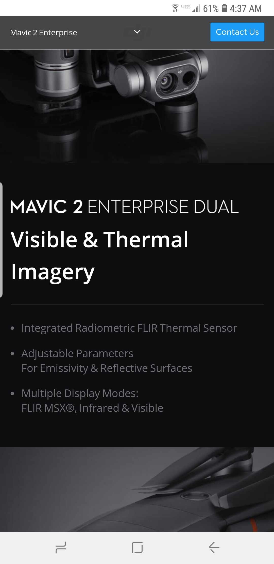

If they built an OEM Phantom, with Thermal, or something smaller than the Matrice, I would be in my Happy Place.
Well now you can be happy! DJU has the Mavic 2 Enterprise Dual. FLIR is mounted right next to the regular lens on a the 3-axis gimbal.
