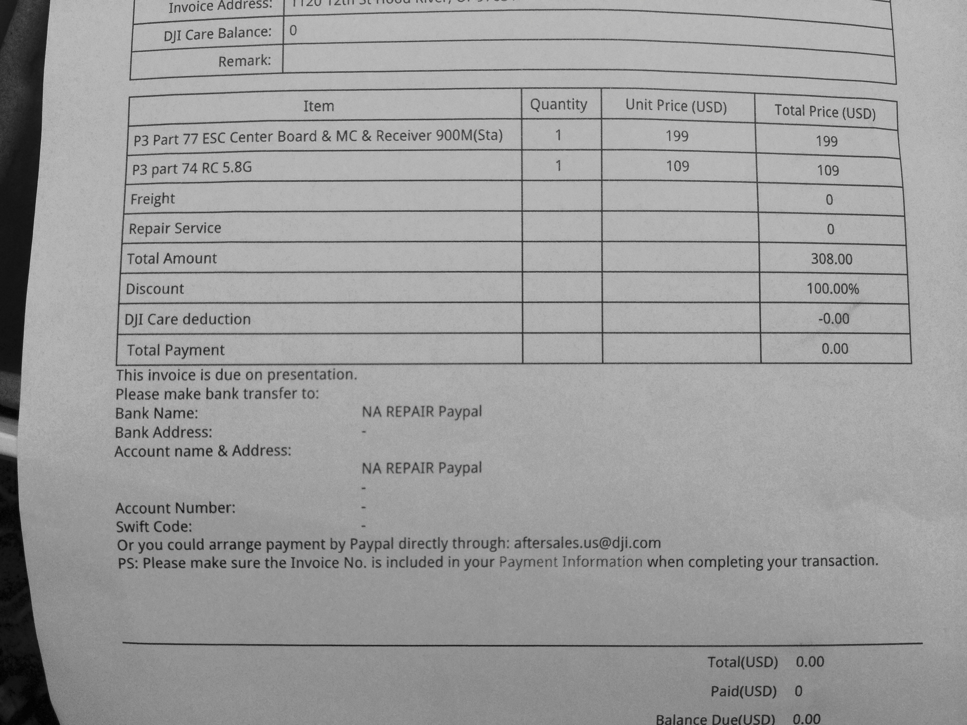

Finally have my standard back covered in dirty marks ,stickers half off and the top DJI sticker looks almost worn off , Same A/C same remote . Is there anyway to find out what they fixed ?
Looks like it's been to Mongolia and back on an small horse in a saddle bag .My near new P3S looks like a weary traveler now .Will it work ? I'll try tomorrow .Overall a thoroughly underwhelming experience .
If your asking me a have not gone backwards on apps. If you had a connection problem between the remote and the mobile that would be different. Your poor connection is the transmission from the remote to the bird.
I don't thing a mobile device or software setup is going to fix, how they fixed mine.

I Just Noticed your Paper work....They Changed out a 900M Main Board... and a 5.8 RC unit....????

Yep.... But on an Early Flight, Flying down from 400 ft back to home, I let the Throttle Latch into Descend...I was doing about 30mph, and got disorientated between the screen and Eye sight...Flying Lichi....It Plowed into the Ground... then a Cow Kicked it...New Body... Good as New ....Didn't send it In... For Pilot Error... Still had Range out 1/2-1 mile ... Then Noticed the tell tail Motor Mount Cracks.... Ordered and Changed New Body, with CNC Motor Mount Plates...
Then Noticed RTH and 100ft Distance....all the Warnings...LOS...RC Sig. Loss.... and it Being Intermittent... If Flying in windy Conditions....
So Started Looking at Log Files, with Word Pad... and got the distinct Impression, that one of the Up Dates installed automatic update for FW... after a timeout to wait for User to Up date...so rolled software back to 1.5.7 .. Haven't Flown Because of Wind and Smoke in Northern Nevada...
While Looking at Phantom 3 Standard Mother Boards, on Ebay... A Close up Group of Clear Pictures....
Shows the 5.8 Radio Board Sitting Over an OPEN Hole in the Board... with 2 of the Board Mounting Points Near By... The 5.8 Board is Only Mounted by PADS, at Each End, being Soldered to Little Pads....
IS THE METAL ENCASED RADIO BOARD and FLEXING OF THE ES MU BOARD... FRACTURING THE CONTACT PAD JOINTS ???
Causing Intermittent Drop Out, and Signal Strength Jumping all Over the Place???
The Torque From the 4 Motors and Props, Through the Body and Main Board.... with the Radio ONLY Lightly attached By the Contact Pads.... Might Be a Point...
My NEW... Main Board... Just Showed Up... So Time to Get to Installing... and Looking for Micro-Fractures, and Cold solider Joints, at the 5.8 Radio Mounting Pads...
Been Flying RC Planes since 1971, with Kraft Escapements...still Flying Futaba FM...middle of Nevada... Started working on Puters with TI vic-20...
