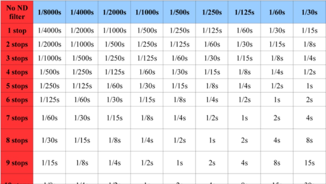

Wanted to get the 64 in the set but they are out of stock. Think a 32 will be enough?

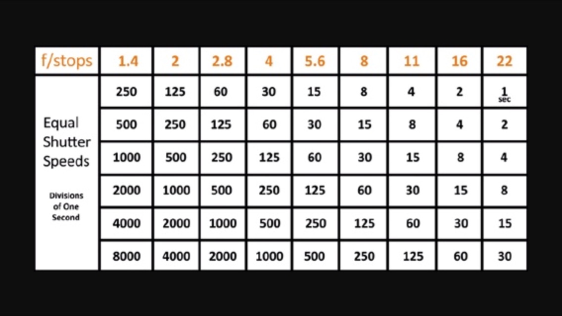

That depends on your desired shutter speed and current shutter speed based on lighting conditions when and where you typically shoot. Per the 180 degree rule, if you typically shoot 1080 30p, your desired shutter speed should be set to 60.
ND 32 cuts light by 5 stops. That means you could slow a shutter speed of 1/2000 down to 1/60 with an ND 32. If you see shutter speeds at 4000, you would need an ND 64.
For purposes of the second chart, look at the f-2.8 column since the P3 camera's aperture is fixed at an f-2.8.
