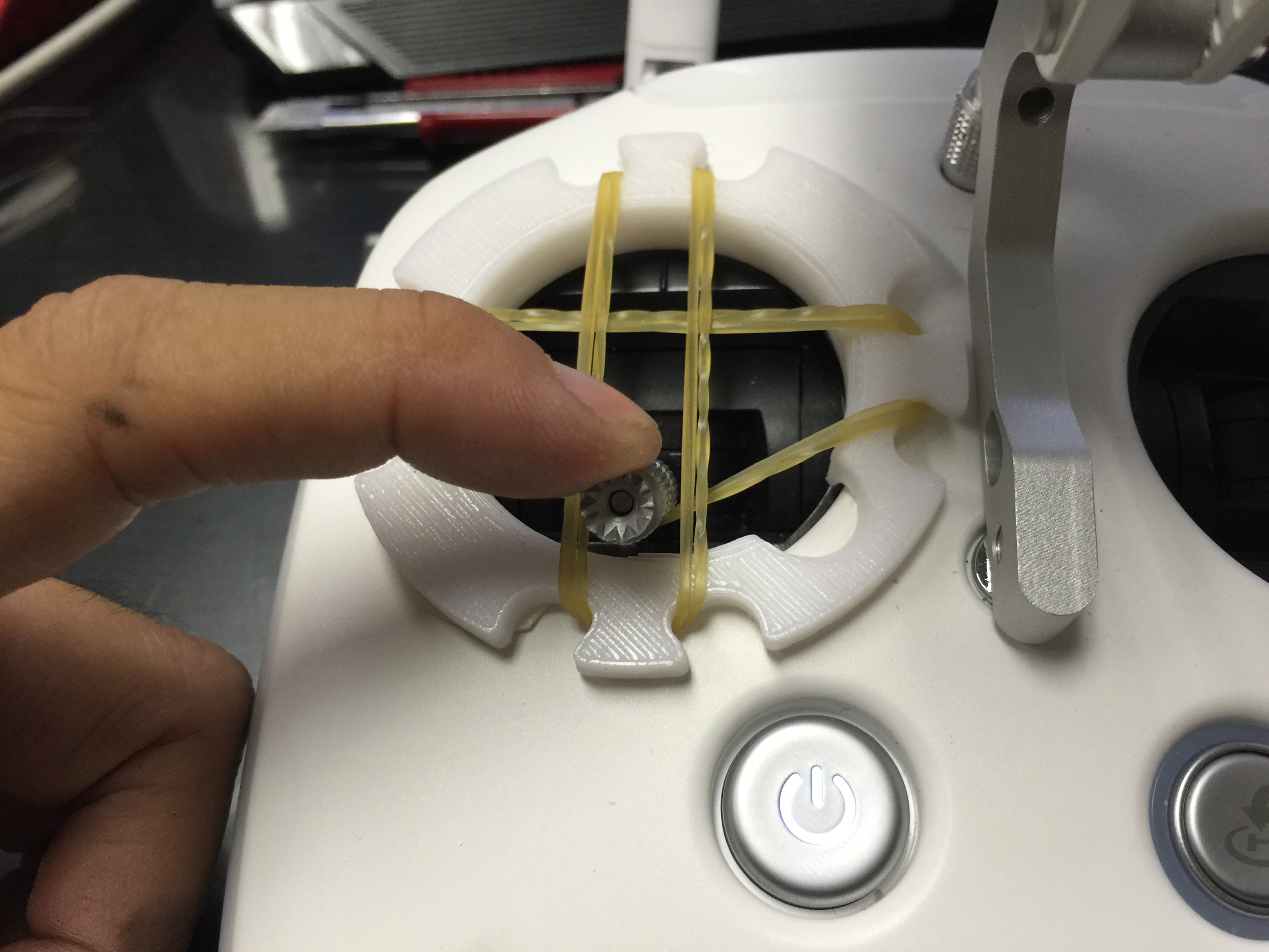

thanks for your advice. usually we pull the throttle fully down to shut down the motor so we do not have the problem you mentioned. please email us and we could send you a replacement.

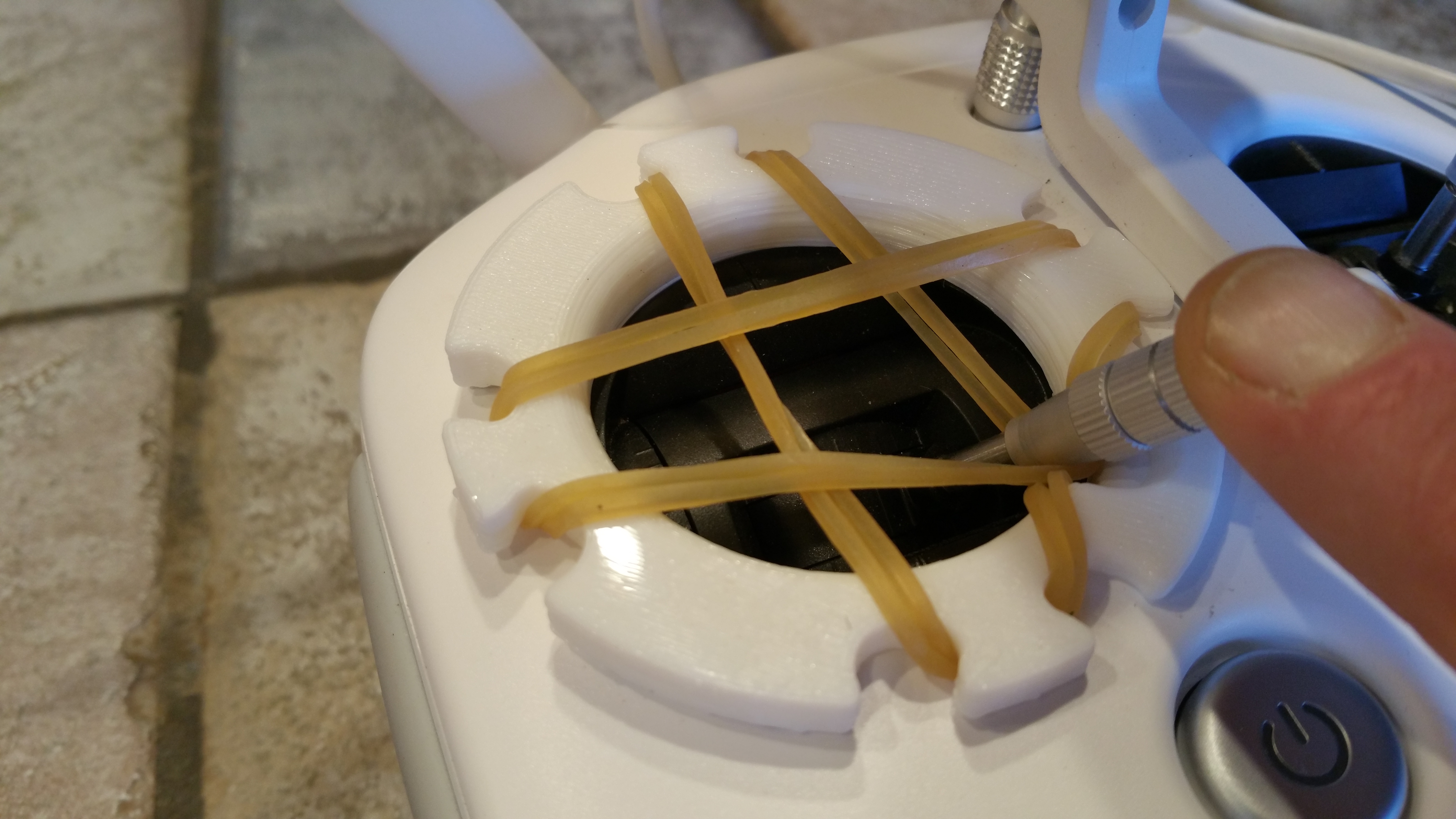

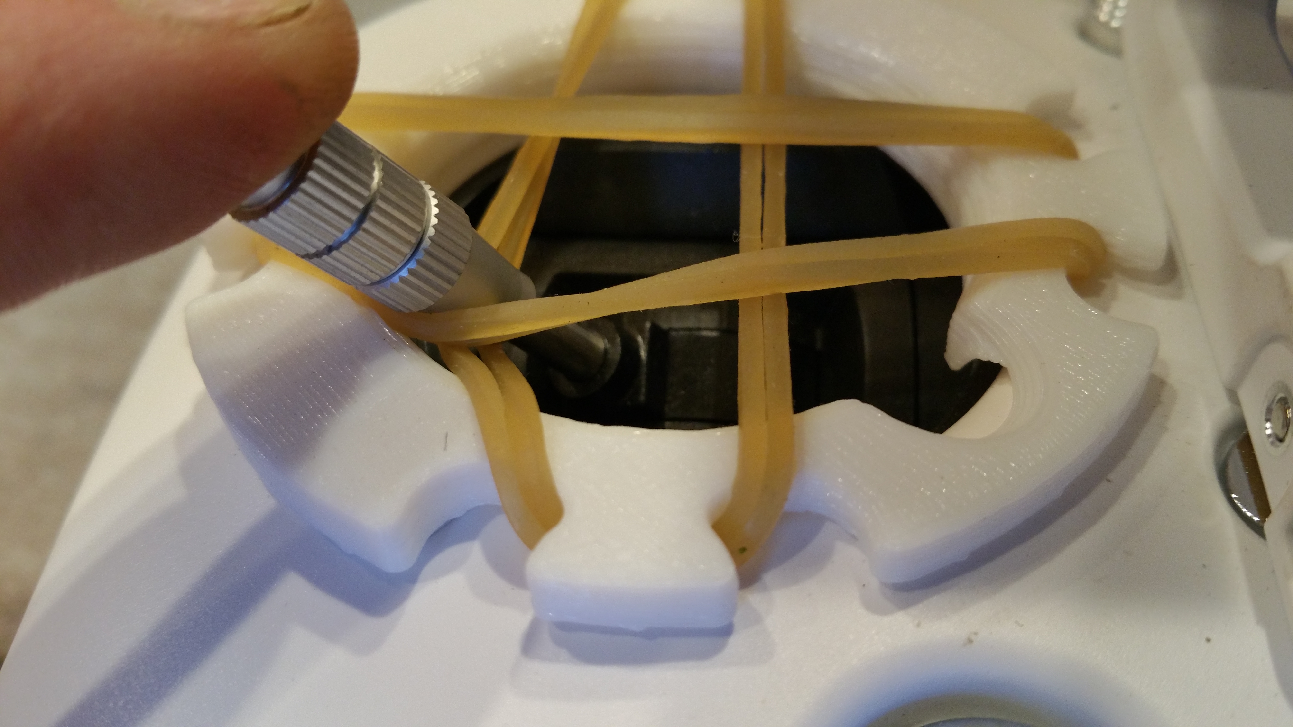

Warning: This could prevent you from being able to shut down your motors after landing/catching P3 by block CSC and left stick down moves. Worse, I've had my P3 flip twice, props still spinning into the earth, after landing while I was trying to execute these moves to shut down motors.
Review photos. Notice how the left stick is right up against
the rubber band retainer. You can see there is a cut-out only on right side that allows the stick to lay down far enough. You need to always pull sticks inward for 100 % success in starting and stopping motors. Unfortunately that's not what I've gotten in a habit of doing prior to installing this device.View attachment 27328 View attachment 27329
I think if you were to minimize the cutout on right side if you're accessory, then reproduce the same on left, you would have enough material removed to drop sticks into cutout while retaining enough material to stick 3M tape underneath for adherence. I also find myself reattaching the accessory to my rc, it wants to pop up.
Could you conceive of a way to add additional rubber bands into the accessory so that we can close gap in corners of center? Instead of square, we would have octagon? I find when I rotate around the stick, I fall into these corners and it alters resistance on stick.

I always hand caught until it occurred to me there is likely a correlation between that and developing cracks in body of P3--grabbing only one side of landing gear puts a rotational and horizontal stress on rest the craft as you take the weight of it and again while you are trying to pave it back the ground.
At first I thought CSC startup with sticks lowered and opposing was removed from a firmware because I couldn't get the P3 to start in this way. Wasn't till the crashes/flips that I investigated further. How tall are your sticks? There is a point midway up but closer to full extension that the wider part of grips on sticks will bump up against the accessory--if you have them extended less or more you'd probably be alright.
we really appreciate your suggestion. we will add it to our TODO list.
