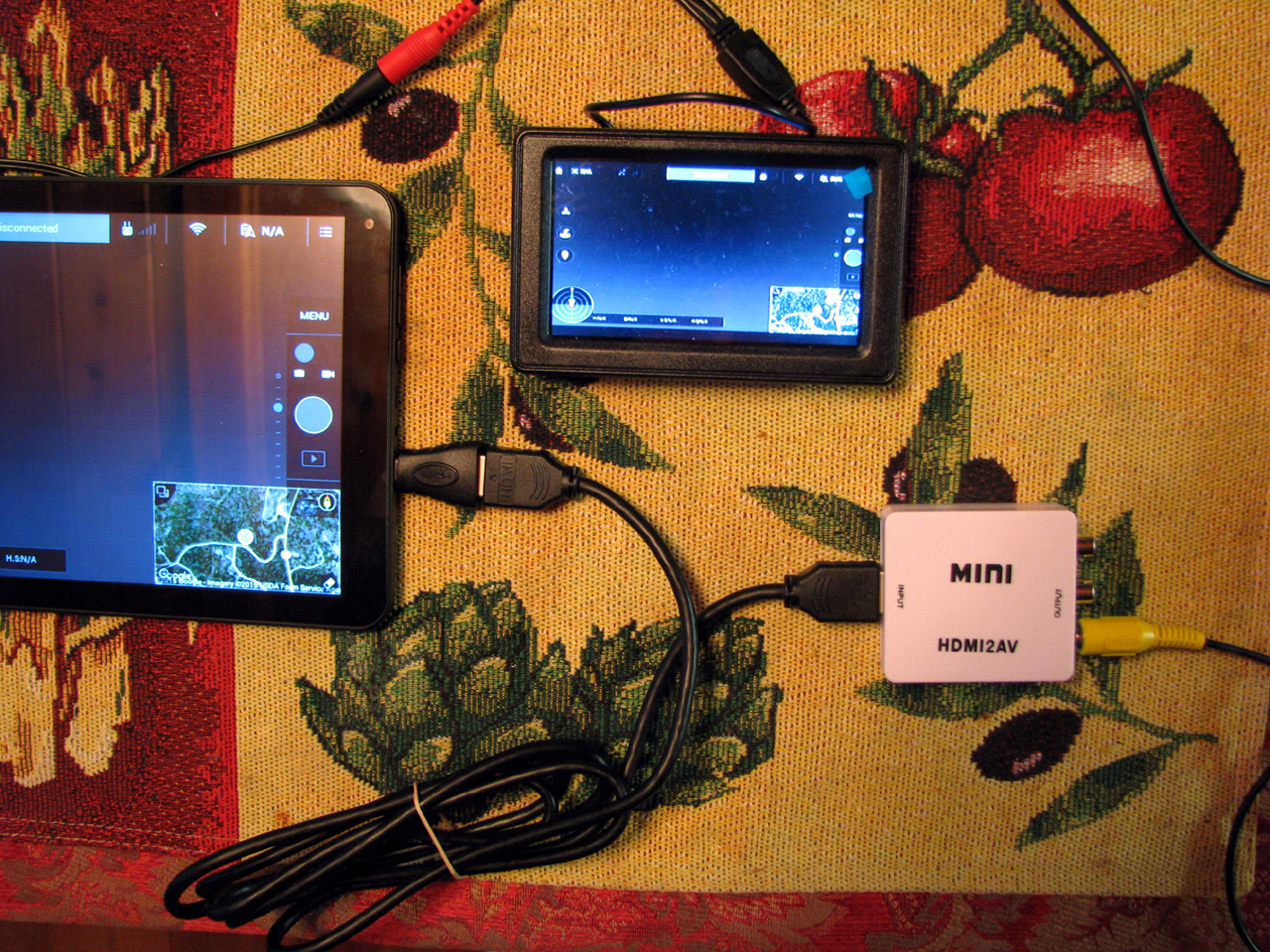

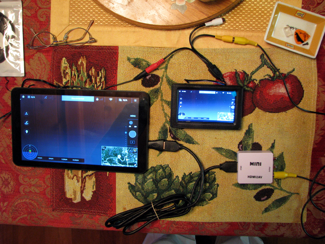

The converter I posted the link to is an HDMI to 'composite' video.
I'm not using an HDMI to component video (which uses 3 RCA connectors marked Y, PB/CB and PR/CR).
Here are some pics of my set up running DJI Go on the $88 Proscan and sending it to the 5" composite monitor for the goggles, via an HDMI cable to the $12 HDMI to composite video converter, and on to the monitor via an RCA cable, with nothing attached to the converter but the HDMI and composite video RCA cables (no USB power cable at all).
The monitor does need 12V DC power (in the pics I'm using a wall wart, but in practice I use a small LiPo, and put it all in an old fanny pack).
View attachment 37568 View attachment 37569

Can you show how you wired this. I would like to do this wiyh my DIY goggles. Thanks.
I posted pictures of the connections here: Tablets and phones that work well with DJI GO
Be sure to get the 'exact' $10 converter from Amazon that I posted about in this thread (a few posts before the above referenced post) as it has been reported that others that seem to be the same (but aren't) will require a USB power, while the one I used is self powered.
It's simply using HDMI source from your table or whatever, which is connected to the converter via the proper HDMI cable, then using an RCA to RCA cable ... you go from the converter's 'video out' to the Quanum DIY goggles' 'video in' (which as you know, also needs a 12V supply) ... I'm using a small LiPo battery for that.
The only issue I'm having with the DIY Quanums is because I'm farsighted, and it's a bit of a challenge to find a set of reading glasses/lens from a magnifying headsets (like jewelers use) to get focus in the Quanums.
But for people using any version of the Quanums FPV goggles successfully, this setup is less cost than the just DJI HDMI controller back, and that includes the price of the $88 10" Proscan tablet (which includes the HDMI output) and the converter.
