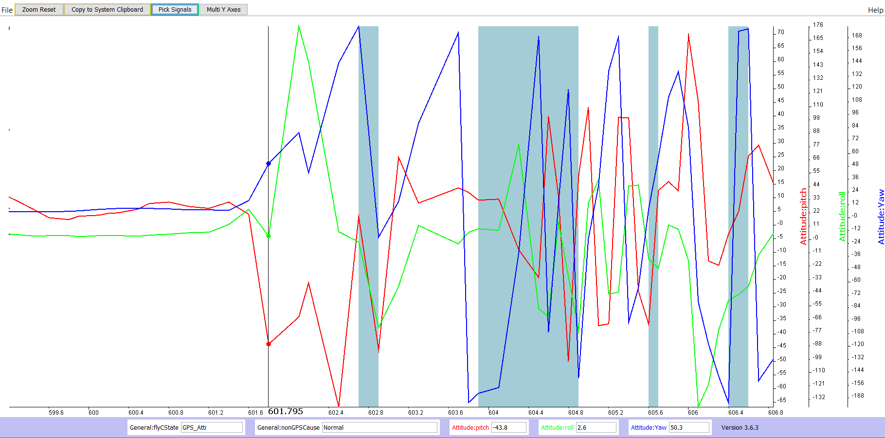

Understand that completely. Taking a wag, I would say a broken left front prop started the whole ordeal. When that happens, the aircraft could do most anything attempting to stabilize itself.

Severe Pitch down, then Roll to the left and yaw CCW......You can download the CSV from the Phantom help site that you uploaded to. If you use the Verbose CSV file that is directly readable in Bud Walkers CSV View. Otherwise you can use Excel and/or an external graphing software for the CSV.

The data shows the initial impact at 10:01.6 when the pitch, roll and yaw numbers change suddenly.
That tipped the Phantom over and it lost GPS (GPS health went from 5 to 1 almost immediately).
From then on, your Phantom did not have the benefit of GPS position holding.
