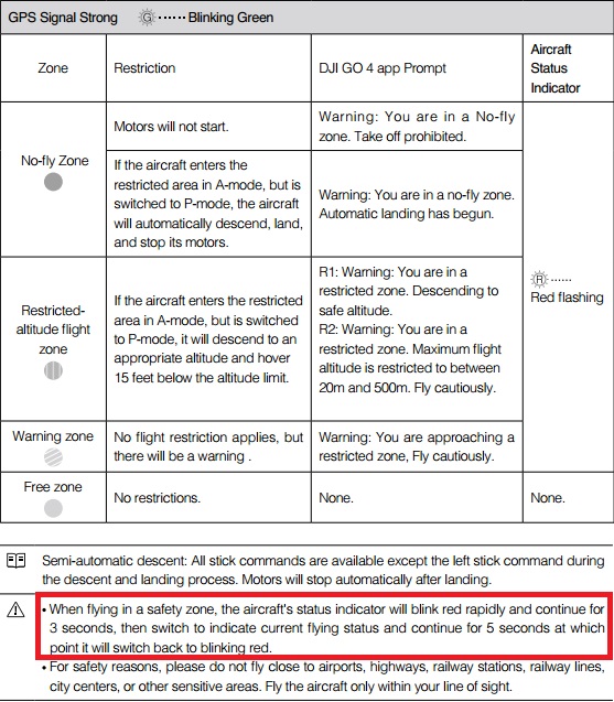

You can find charts in the P4P manual. It's available on the P4P downloads page. I checked it and did not see any patterns that match your description.
Yes same here, nothing in the manual explaining this sequence of LEDs. Just going to upload TXT flight log now.

The light pattern mentioned in the manual is similar to what you're seeing (minus the flashing speed). Perhaps the manual just doesn't document the difference when flying in a warning zone -- or the light pattern was changed and the manual was not updated.

Quick update, have tried flight at home which is only about 100 metres from where I first spotted the strange LED pattern and i'm no longer getting it. The weird is that i'm at the same distance roughly from the no fly zone, the red outer edge of which is about half a mile away from where I live anyway so i'm thinking that this pattern could mean that there is a no fly zone near by. Just a thought.
I've put a request in to DJI to let me know what this particular LED pattern means and will post on here if they get back to me.
