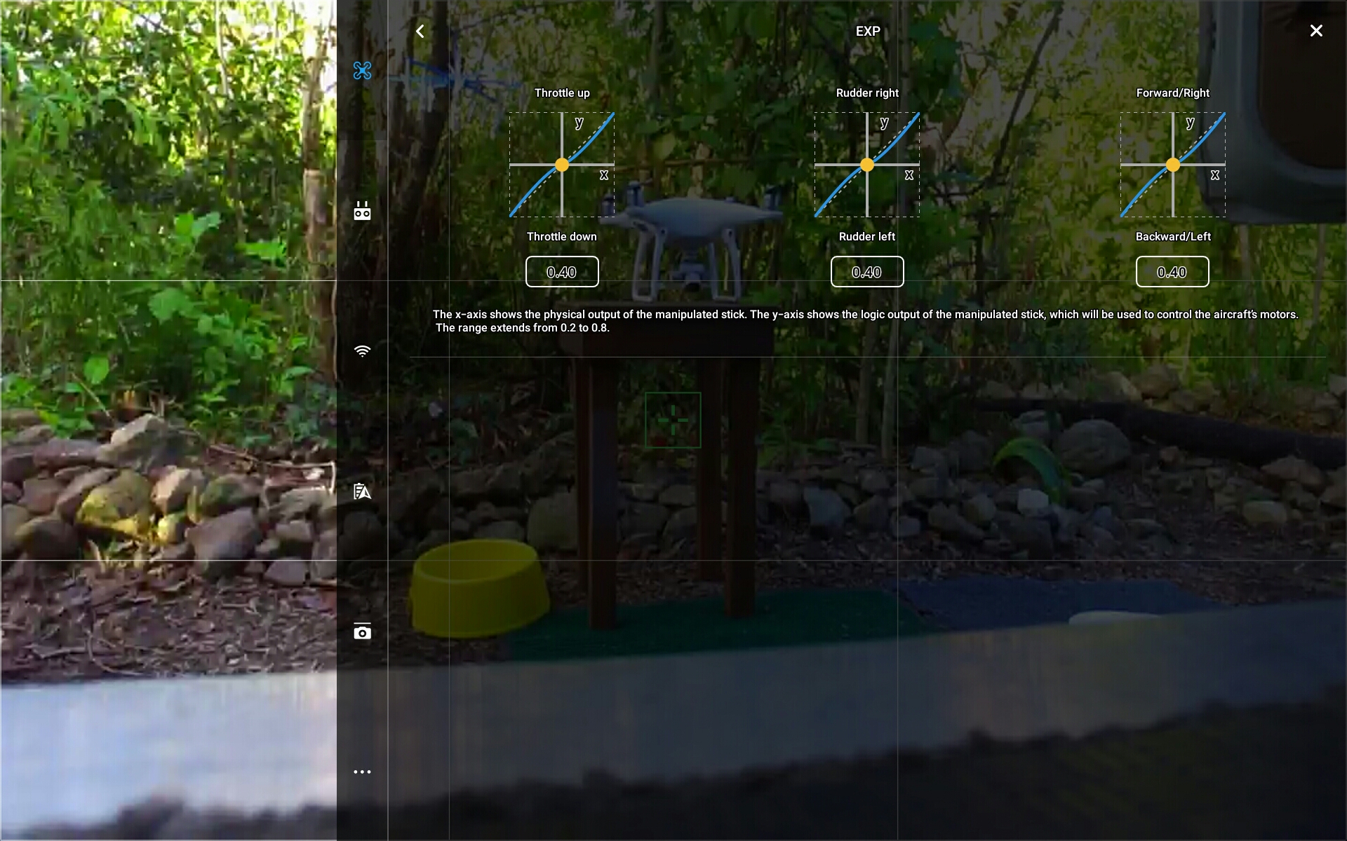

What you slow down for ,ducks,ha serious,,,Um might be able to do with stick calibration,,instead of 100% inputs give it 50% and save it ,,that should stop the top speed and go from there to your liking,,,to my knowing there's no speed where you can select unless pree planned flight,,,waypoint etc

Either way, these can be decreased by changing flight parameters; Ph3s make it a bit harder as there is no Assistant app; but there are other tools to set the parameters. Like this one:
