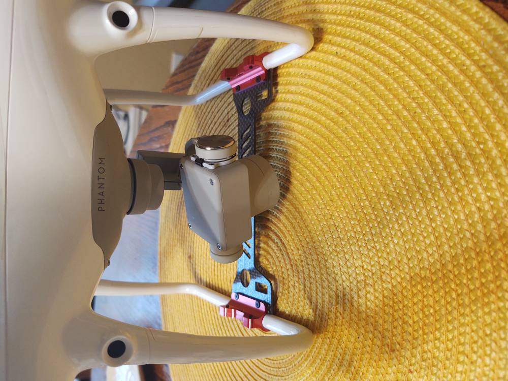

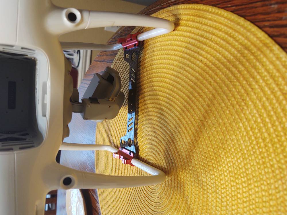

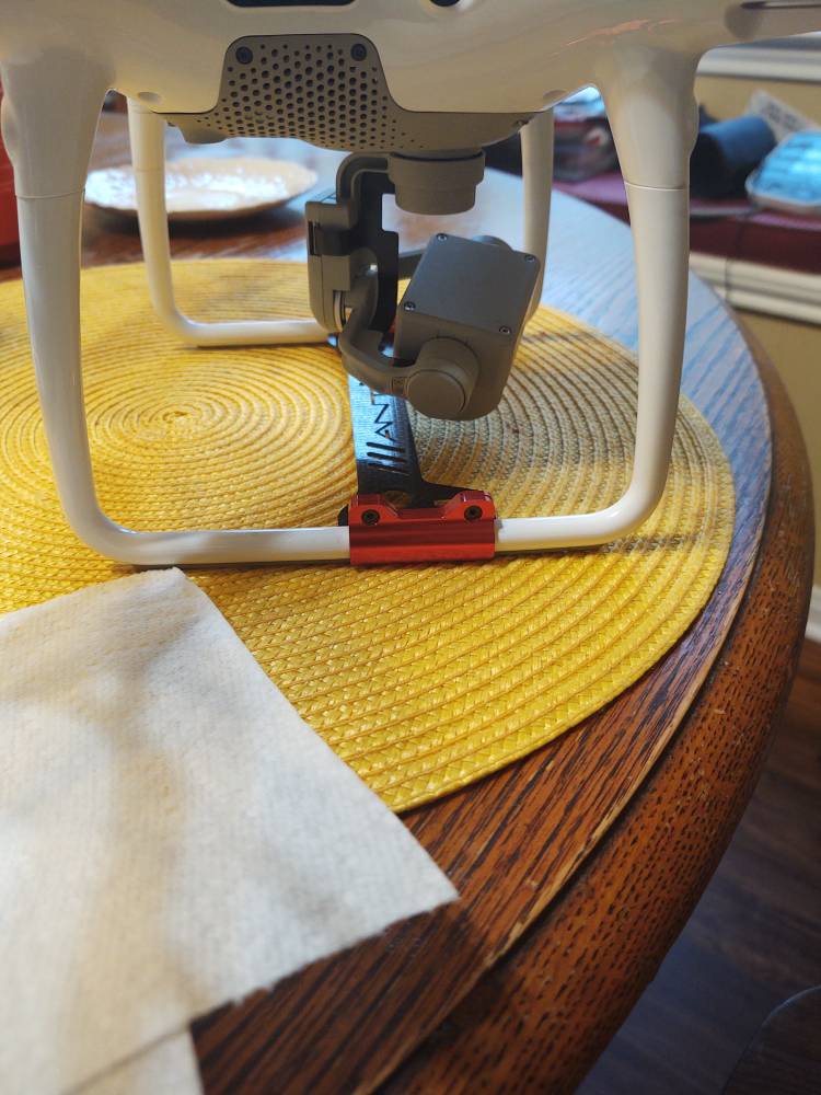

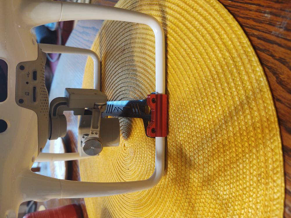

Curious to know which gimbal guard you use/ if all guards cause such a problem.
To work, the guard should be Very narrow in the center to avoid blocking the sensors. Wider ones can be moved forward but will then block the camera when pointed down. Personally I have not found them worth having on my drone.

I installed a new gimbal guard on my Phantom 4 Pro V2.0 and that was interfering with the downward sensors on my drone. I had to move it forward. I will test it tomorrow if it doesn't rain.
Glad you solved it. When I posted that solution, I was half joking as it happens so often. ?

I moved it back enough so it will not block the camera [emoji991] in the down position and forward enough so it will not affect the down sensors. I prefer to fly with a gimbal guard
