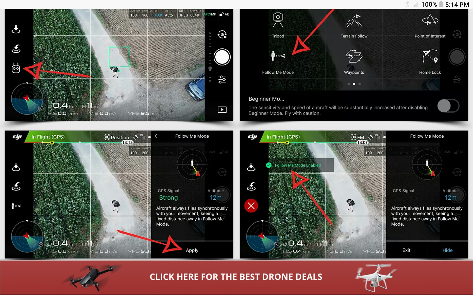

Lol stupid is good,don't know if don't ask,,here's screenshot ,,,,to be honest with you I have never tryed this feature since I get hooked,,I think that's why they last so long,,,did you move enough for it to follow,,if remember right there's a distance that it start working from you,,,,,,,,not 100% sure on that so if wrong someone put me right,,,,yes the flip not nice

Yeah I figured I'd need to walk a certain distance but I walked pretty far from it I'd guess 200 feet maybe I tried walking around left amd right thinking, the follow me mode is maybe just the camera that follows but nope the camera didn't move either my dashboard lol way different from yours. But I have basically the same info. It said it was in follow me mode on my phone screen. The MSG in your 4th pic I did not get. But my icons are in different places. I'll have to try again tomorrow lol. I did not notice but I was thinking it maybe the gps lost signal I was reading up on it and I think it needs the gps signal. Thanks for the Reply
I'm sure 4th picture refers to this ...there must be something on screen to enable this like 4tg picture shows,,,I guess it confirms if you want it to follow,,,
my dashboard lol way different from yours. But I have basically the same info. I did not notice but I was thinking it maybe the gps lost signal I was reading up on it and I think it needs the gps signal.

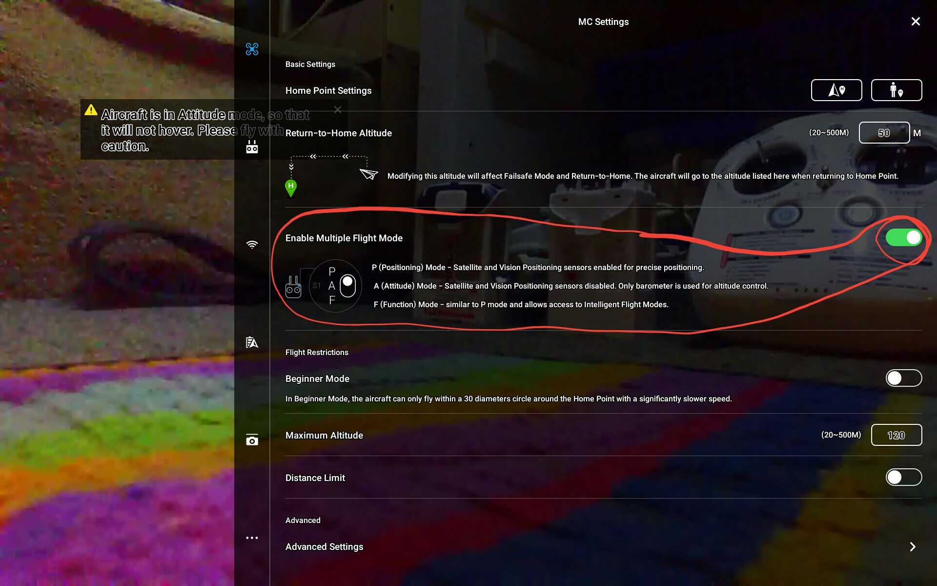

Lastly along with my first question how do the other modes work.
This has been answered by a thread above, however if you are flying a pre-determined flight path, always use the F option
