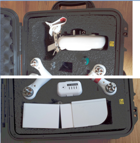

Comments somewhat related to the English Guys post...
I had noticed that in bright sunlight there was a lot of sun reflected off my face that made it hard to read the fine print on the smart phone display (Galaxy S4). I was able to see the main display but when I tried to read the battery%, satellites, etc it was real hard in bright sun. My son, with younger eyes, didn't have any problem. I experimented with a sunshade extension made out of cardboard and later built it in plastic. It just slides on to Milton's sunshade and so far I haven't needed any fasteners. Isf you look close you will see a inward pointing flange that wraps around the bottom edge and holds the extension down against the sunshade. Normally I am not holding it close to my face but when I need to read the fine print I can put the extension right against my face and it is contoured to totally cuts out the sun. You can notice where it is shown on it's side that it doesn't extend any further than is needed. The white inner portion slides over Milton's shade (of which I am a big fan).
In one picture you can see a cardboard box covered with blue painters tape. One edge is open. This slides over the magnifier when I put it in the case to protect the magnifier from stuff stored inside the sunshade.
The other picture shows how I modified my Tradecraft case. Based on an idea in this thread I also felt that if the sunshade could fit in the case it effectively wouldn't take up much room as other stuff could be stored inside the sunshade. I was able to enlarge the cutout to fit the sunshade with my extension... and still get lots of accessories inside it.
I was also able to cut a pocket extension where the transmitter goes to allow the double phone holder clamps to remain on the transmitter when it is stored.
So all in all, it is working well for me.
