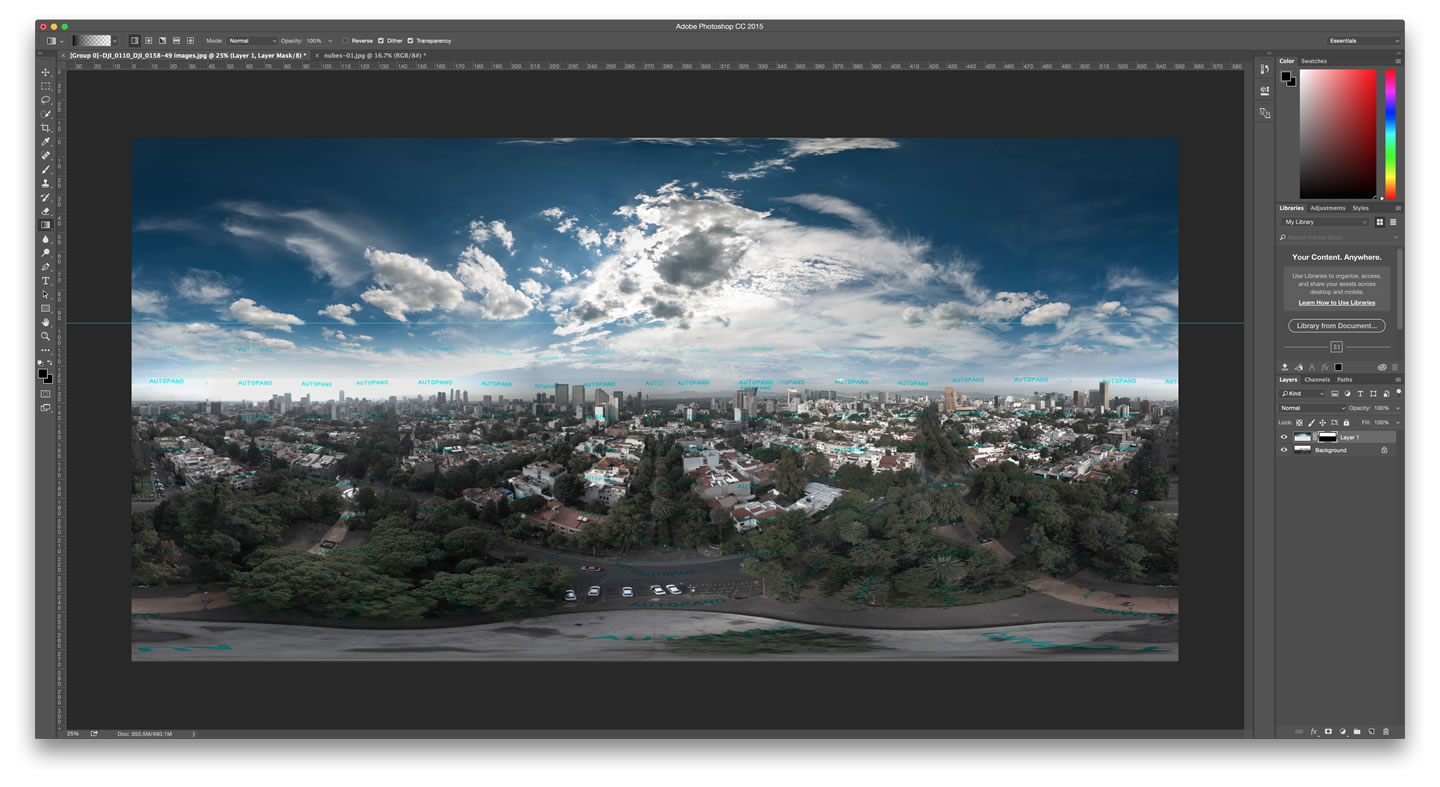

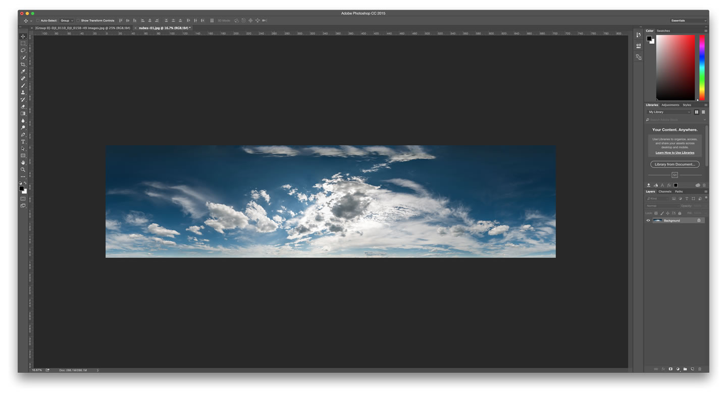

here we go, keep in mind that this is another way to add a sky to a 360 image.

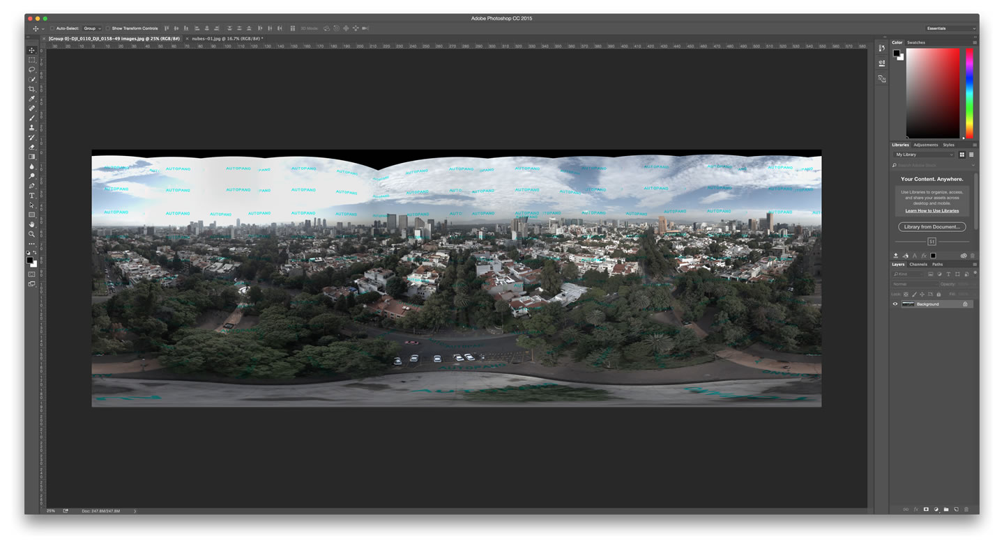

you need two images, the stitched 360 panorama and a sky image (im attaching the image used in the example) in my case my images are as follow:
panorama: 15,652 x 5,536
sky: 20,000 x 5,000

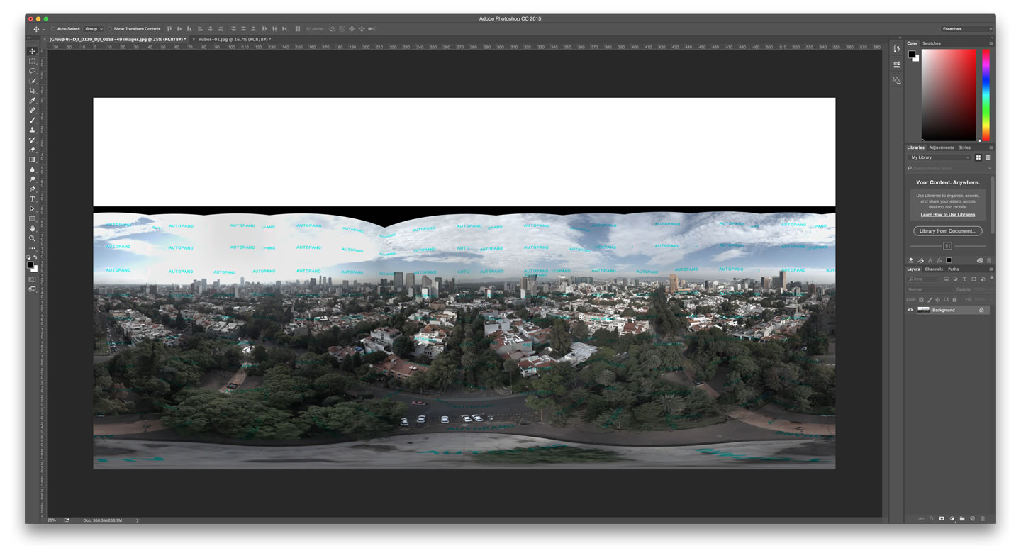

skypixel only accepts panoramas with a 2:1 pixel ratio so we need to modify the panorama canvas to 15,652 x 7,826 pixels (15,652/2=7826, when modifying the canvas size we add the extra pixels to the top, where the sky will be added) we also need to modify the sky image width to match the panorama width (15,656). notice that with the panorama we edited the canvas size and with the sky we changed the image size to end with the following:
panorama: 15,652 x 7,826
sky: 15,652 x 3,913
now we need to blend the sky with the panorama which is very simple
copy the sky and paste it as a new layer in the panorama composition

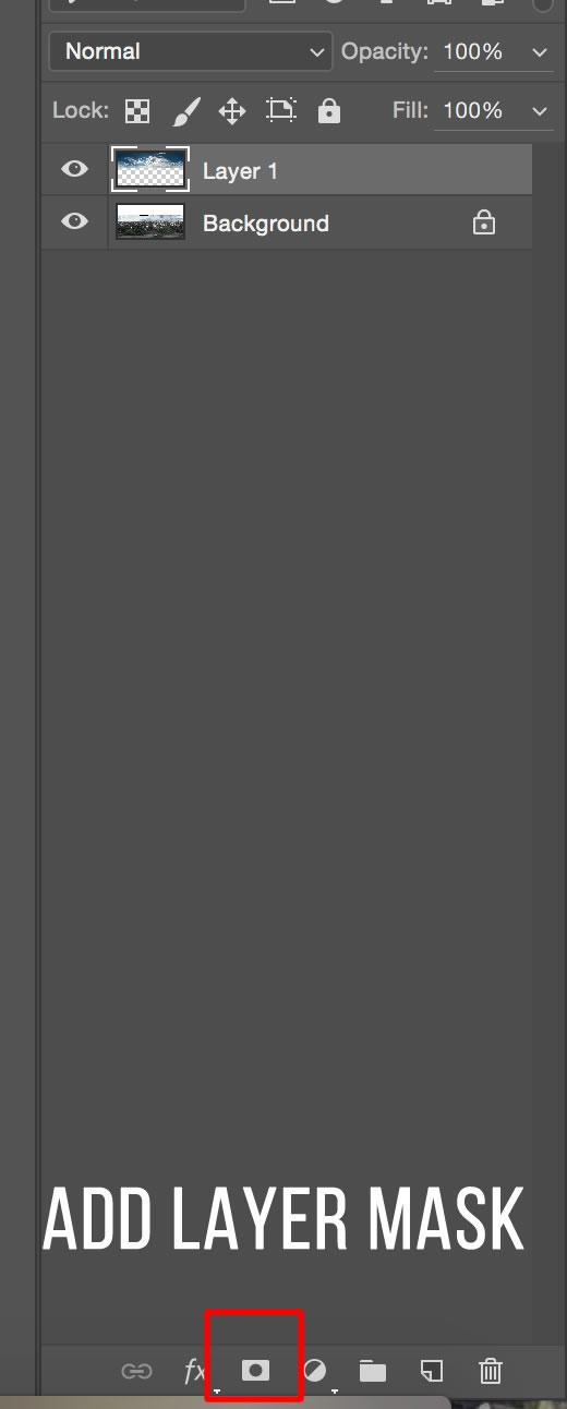

select the sky layer and click on ¨add layer mask¨

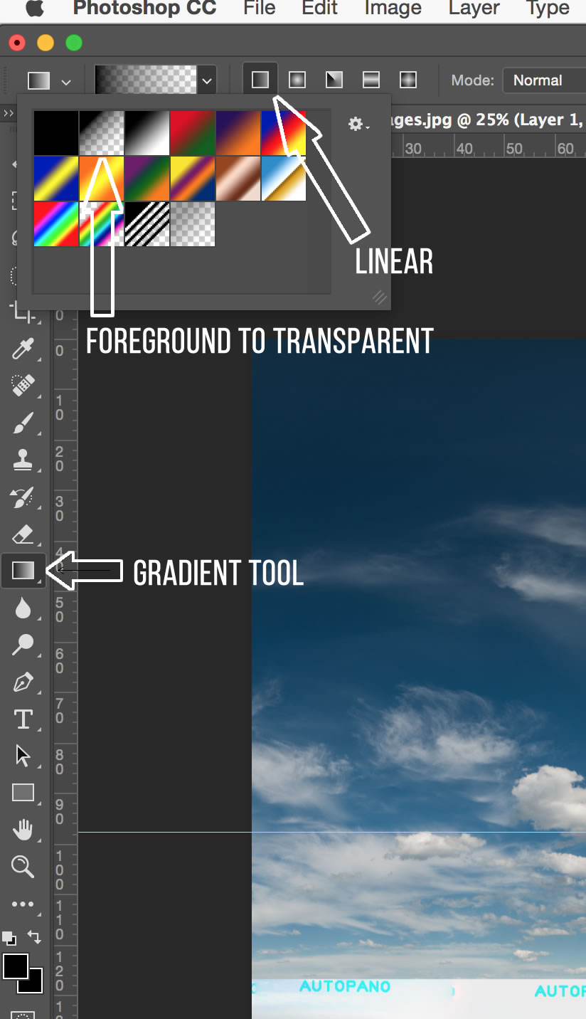

select the gradient tool, and be sure that ¨foreground to transparent¨ and ¨linear¨ options are selected, also be sure that the color is set to black.

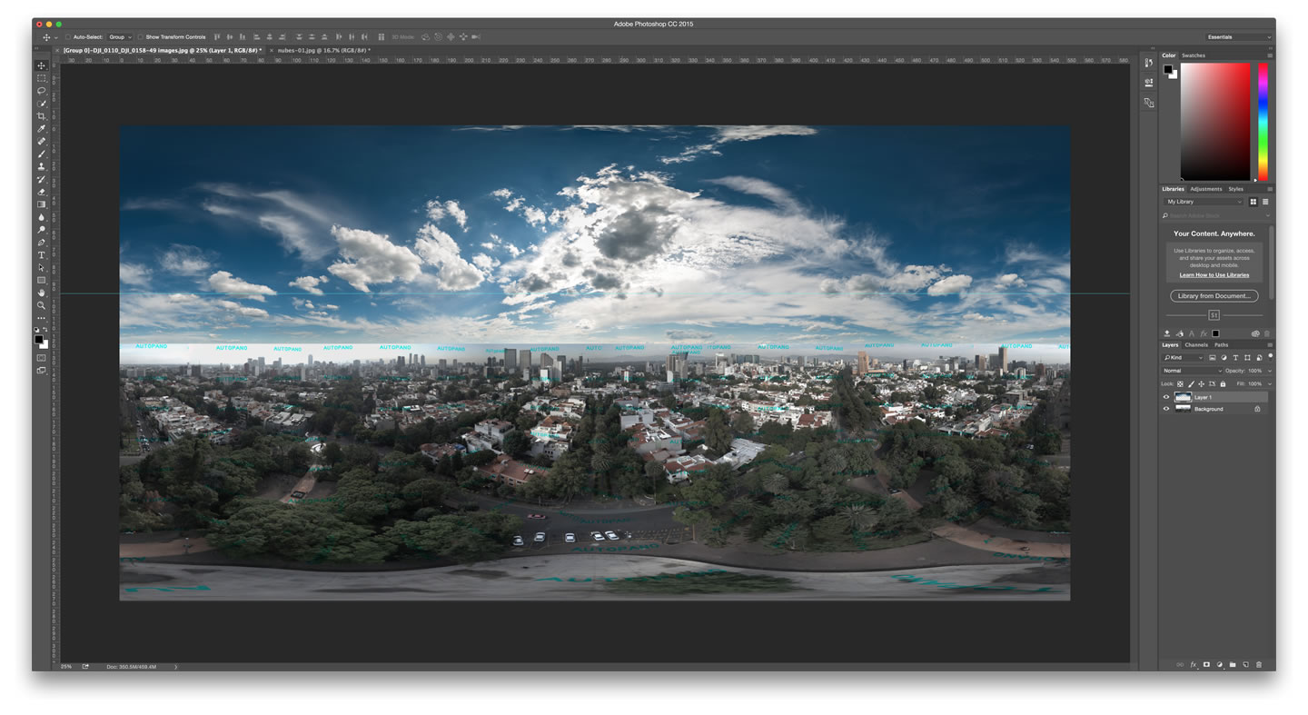

draw a vertical line to blend the images (here youll have to play to get the best result)
export your image as a jpge and voila, thats all :)
