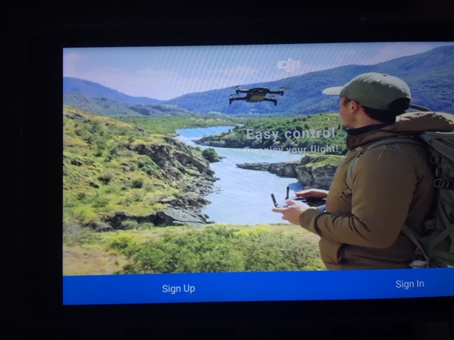

Can you post a picture of where your at in skypixel exactly , might help us.
Thanks for your response. I tried that and found a update option thinking it was an update for the controller, downloaded the update only to find it's an update for Sky Pixel. Still stuck. I've attached a picture of what is on the controller. The images on the controller are a loop of images promoting Sky Pixel
Thank you for your help. I've attached a picture of what is showing on the controller. The images on the controller are a loop of images promoting Sky Pixel.

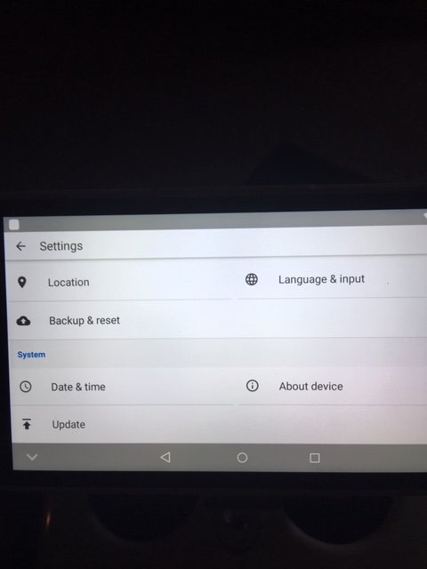

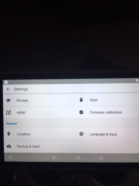

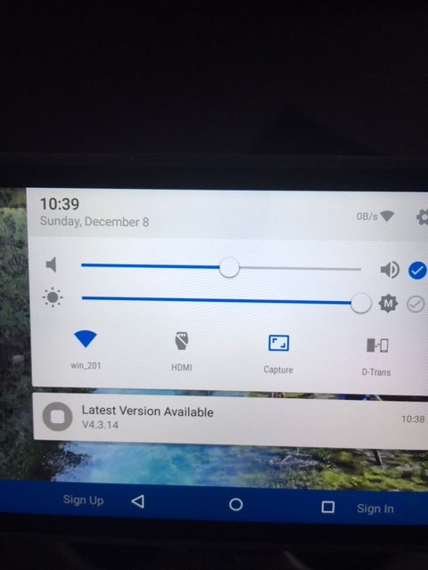

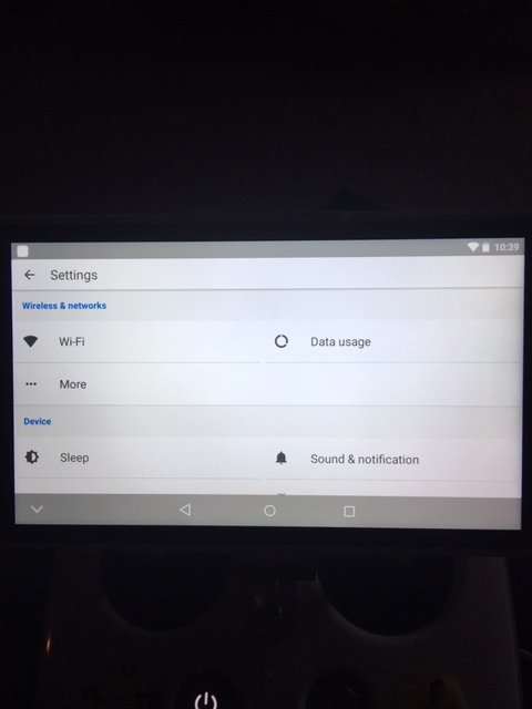

Attached are the
Attached are options when I select settings . Thanks for your time!
So i have this right your stuck at the login and cannot get off that screen with the exception of going to the settings.
Try logging into sky pixel with your face book or twitter account is that possible. ?
You can also try going to the account page on DJI and changing your password which could reset it.
Thanks for the help. Yes, stuck on the login page. I've logged in and still see no place to exit the program. I'm going to try and update the controller. I charging the controller and I just downloaded the controller update zip file from DJI. I'll let you know how it goes. Thanks.

The way to stop any app on Android (which you P4P+ controller is) is on the home screen go to Settings (the gear shaped icon)/System Settings/Apps/SkyPixel/Stop. Good luck!
