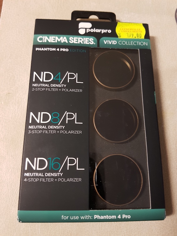

What I have been using with the Mavic Pro and Air are ND4/PL, ND8/PL, and ND16/PL and ND32/P.
When I go out in the bright sunlight I need the 32. With this in mind the closest I could find are these. I got them three days ago thinking I would get the 32 later on. But you don't seem to use them are they not needed on the P4P?

Yes, they are needed, but because the P4P has an adjustable aperture, unlike the Mavic series, you can get away with ND4-16PL filters, as opposed to having to use up to an ND32PL, like on the Mavic Pro series. I have the same filters in the picture you posted, and they're great, I have never needed anything above a ND16PL.
