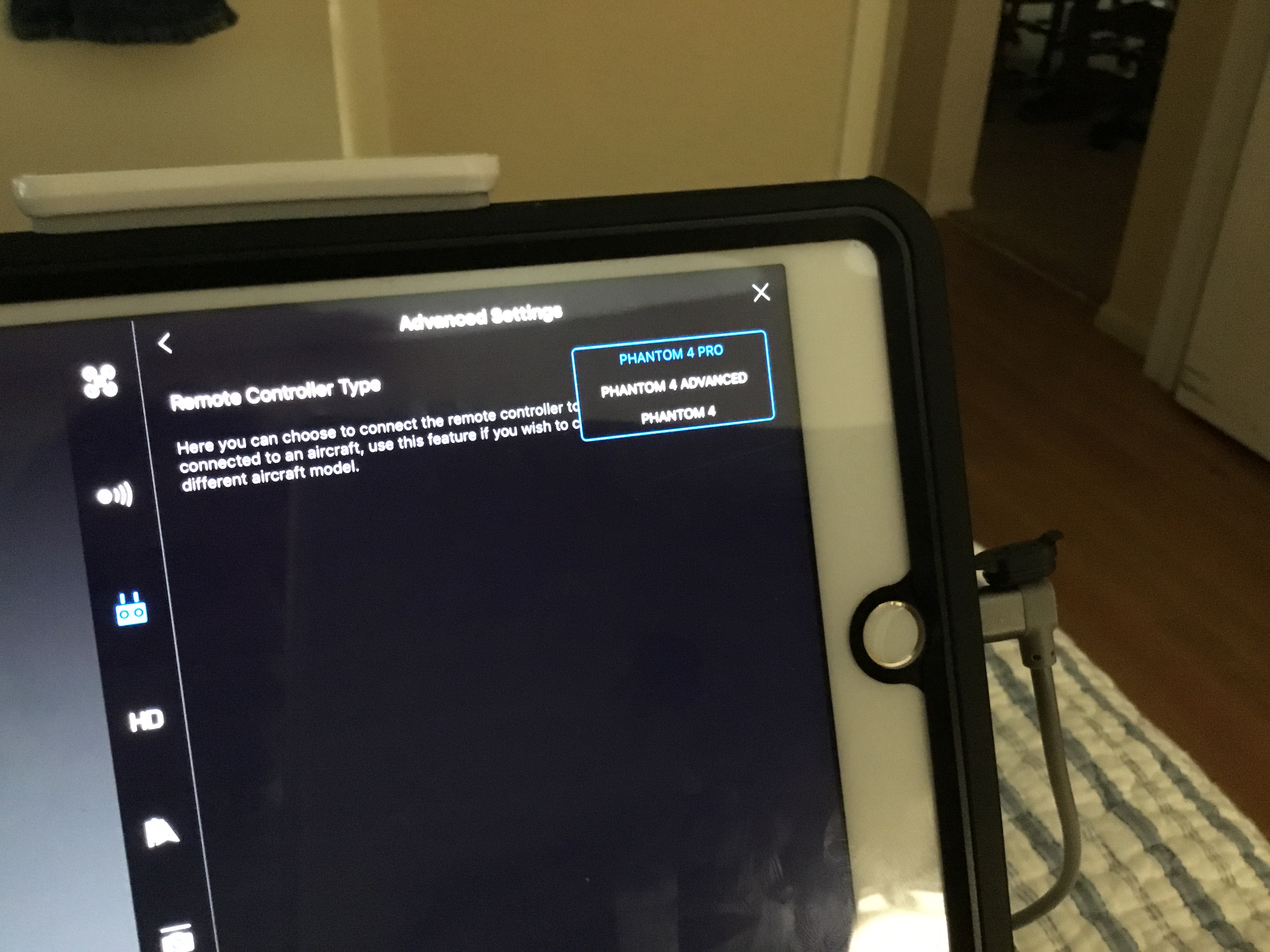

Under RC settings, scroll to the bottom of the page. Select Adv settings. Tap the selection frame to display your AC choices. (v1 only gives Phantom choices) follow on screen instructions.
No need to disconnect the battery.

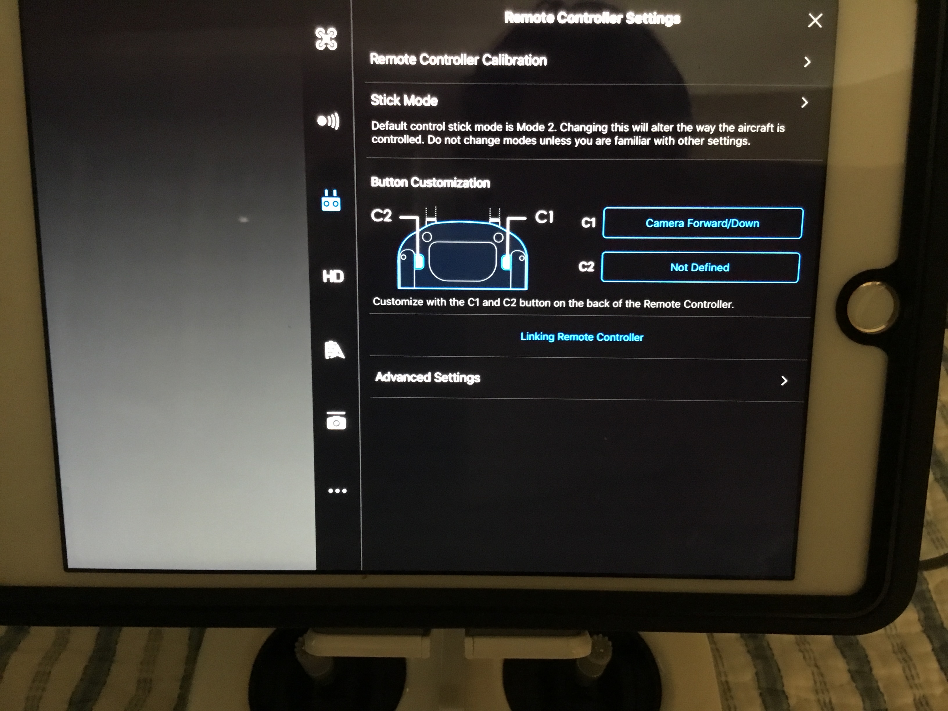

I am in the app and under RC settings, I have scrolled down to the bottom of the page.
At the bottom of the page , the last option is Remote Controller Linking
No Advanced Options o_O

Then your not connected to the remote. When connected it shows up.
Reactions: Jim Canada
I only have Pro v1 remotes so hope I'm not steering you the wrong way. Hope it works same on v2
