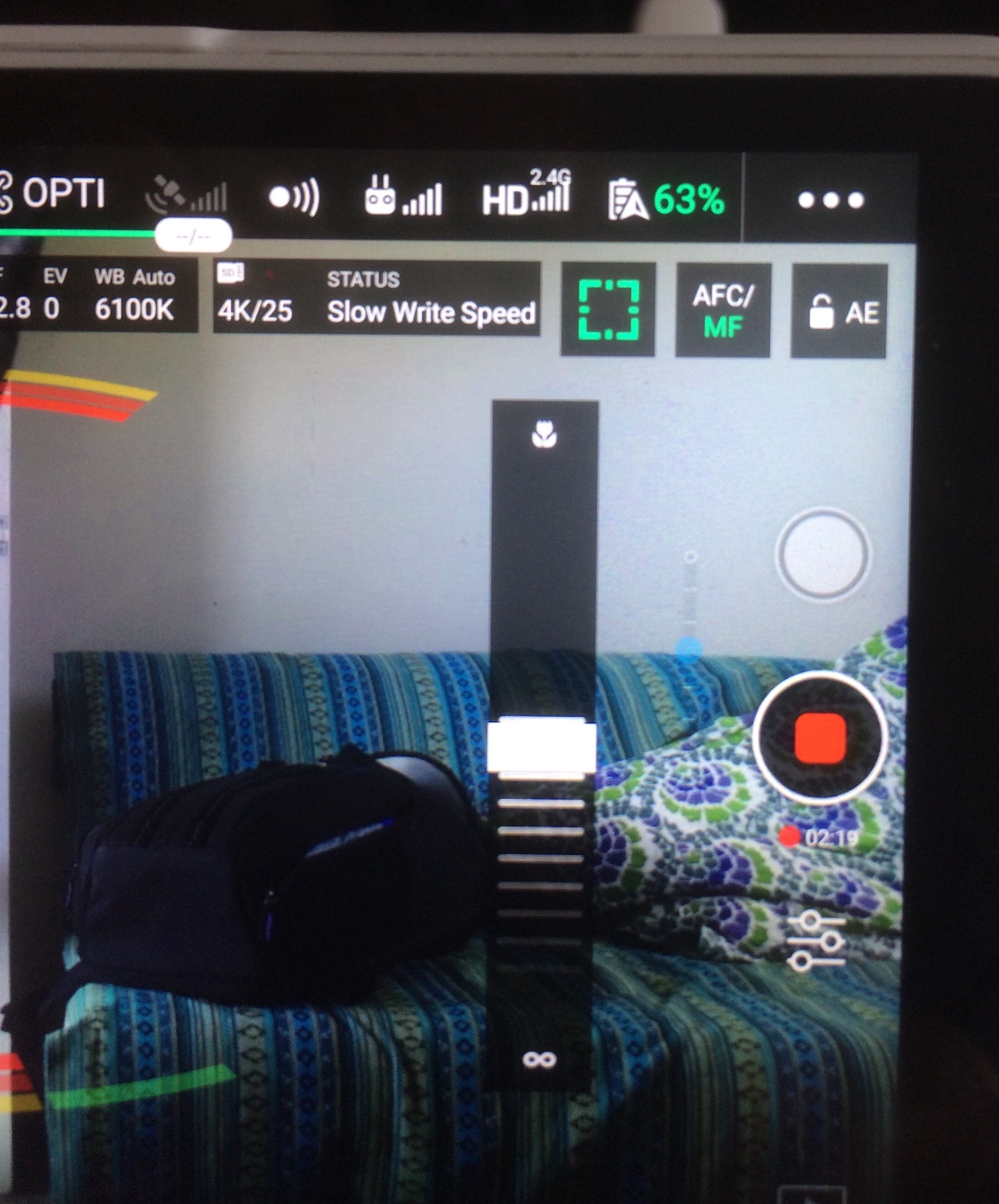

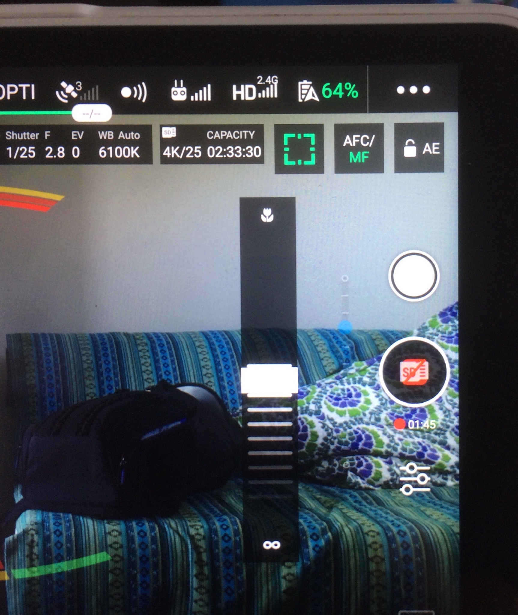

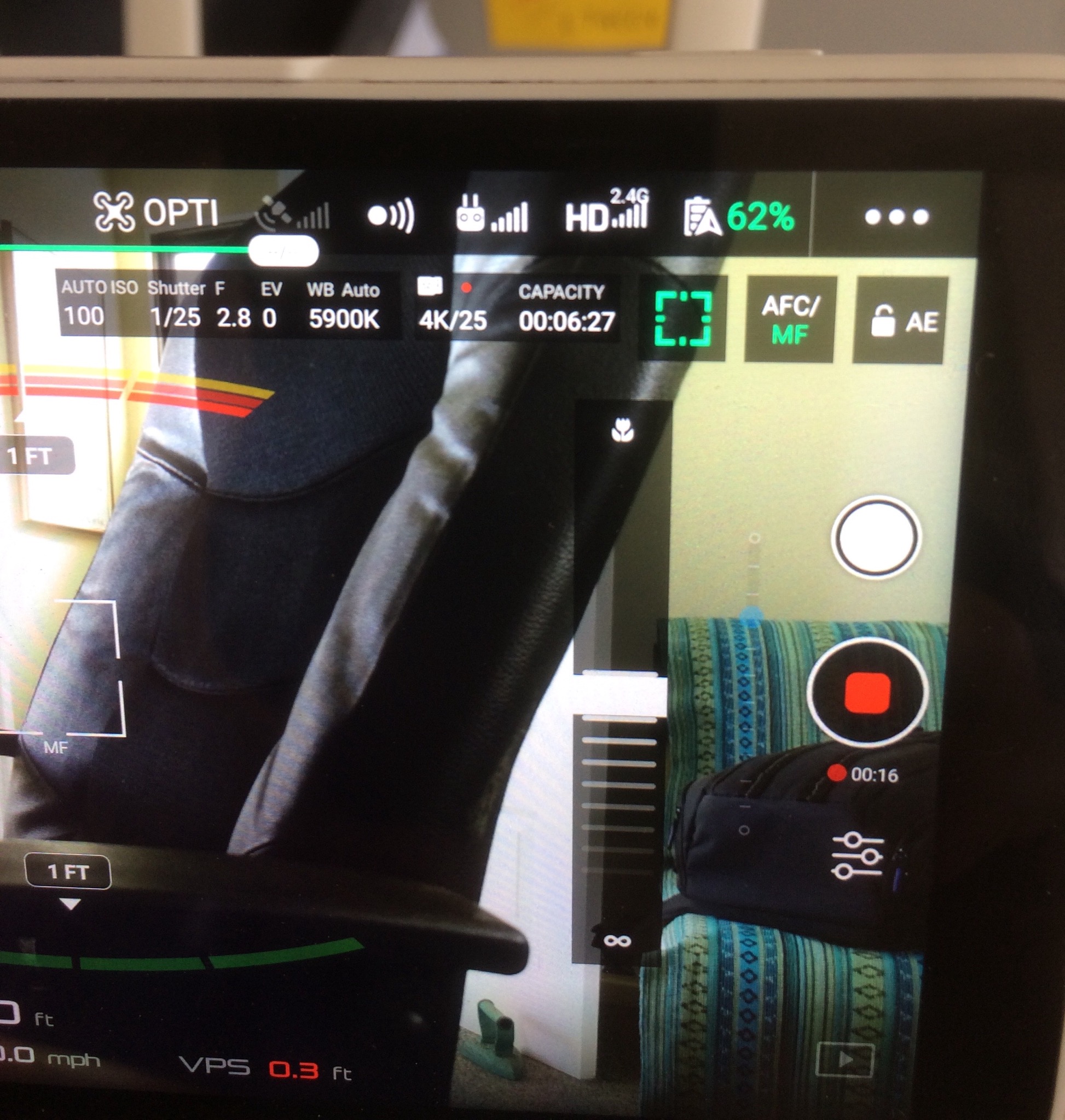

Card definitely empty (erased all video taken). The original card is OK - but will test again tomorrow.
F2058419-BF9B-40CE-BE75-7BCBCDD04665.jpeg Both SD cards now tested. Original card OK.
Replacement card only did 2 second grabs on the first 2 tries. Went a bit longer on the third attempt until a “slow write speed” caption came up
Eventually I got a caption warning on the video button and it basically shut down after a couple of minutes.
Any suggestions? Have I formatted the replacement card correctly?

Is this a u1 or u3 card? U need a u3. I have the evo plus 64gb u3 version. And it has been working flawlessly. So if you have a u1 version that is most likely your problem
I cant in my p4 pro i get cut out problems or recording stops ...same for my mavic air... put in a u3 good to go. My mav pro is fine with a u1 so was my old og p4
Well there's your problem right there... sounds to me like the new card is simply not fast enough
