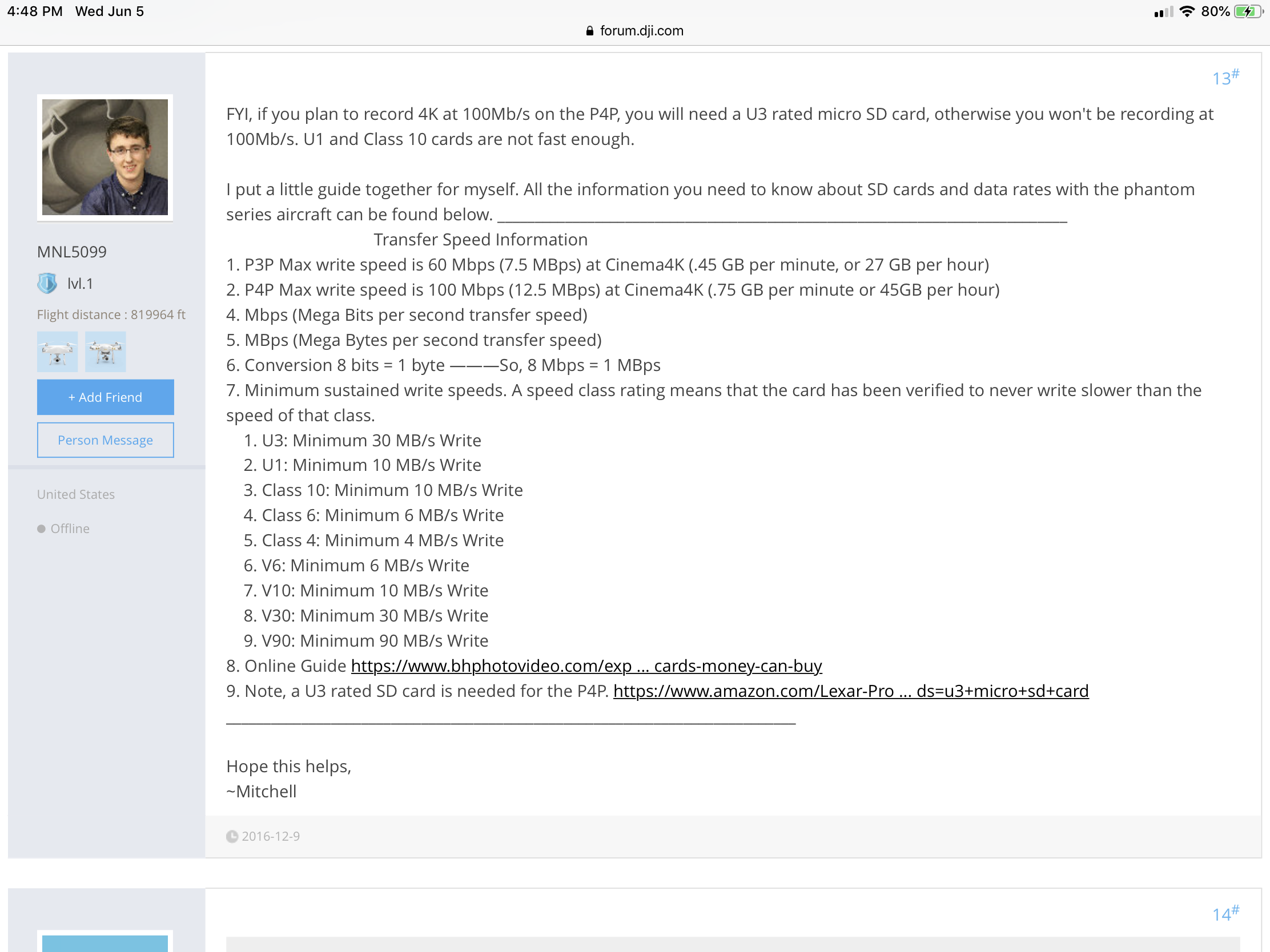

I’m thinking that one is just under what you need. This may help.

Dunno about the P4 ... but my P3 will warn me if card is not fast enough for the settings. It will still work though..... albeit with possible break-ups in recording.
Reducing to 1080 etc. or lower is the usual way to get around it till new card is obtained.
OP says his card is just not recognised at all ... saying error .... so ? I don't think its speed of card.
What is the max size of card for a P4 ? I know I have various digital stuff and if I try a larger card than spec'd - it will usually fail to recognise it.
Yeah, I haven't picked up a new card just yet, but I'm sceptical because of this reason. I feel like the drone would read a slower card, but I'd only notice a problem once recording. We'll see once I obtain an extreme card.
