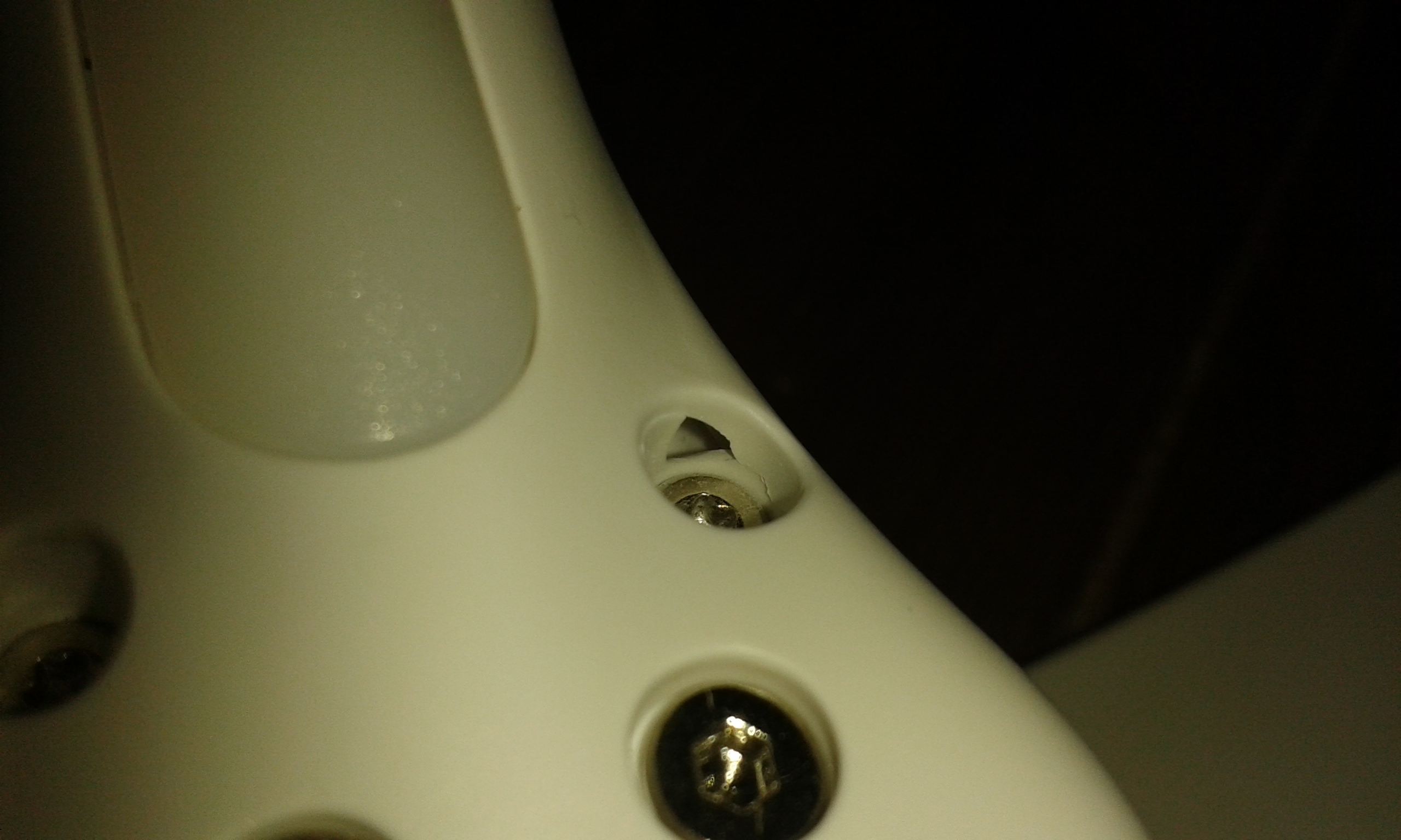

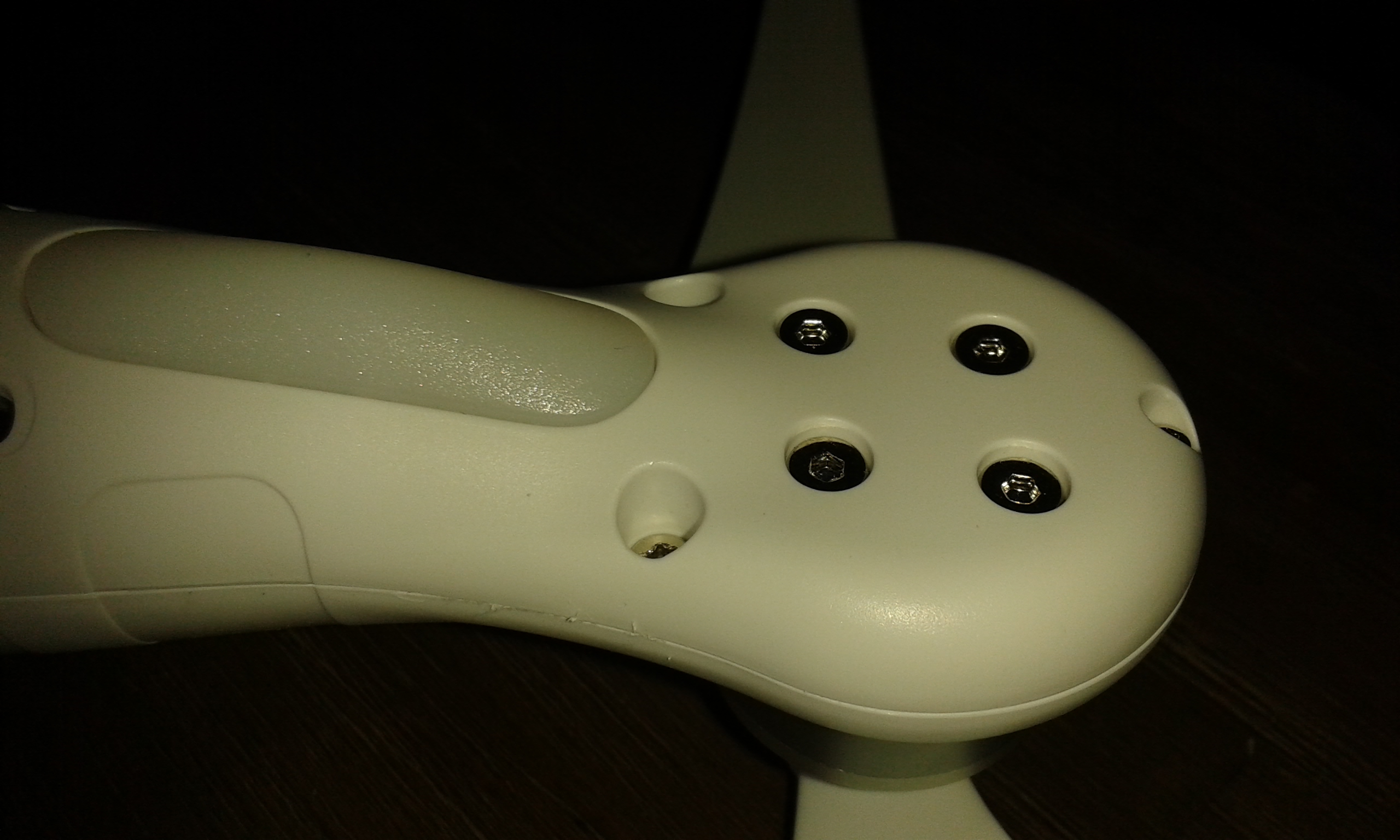

Here are my cracks. To hell with it, I'm gluing the fuselage together. Why? He cause this now is worse than the P2. The P2 cracks didn't affect the structural integrity that much because they were on a different location. These cracks do. You can physically see a lot more twisting movement from the arm ends once the cracks are there. And again folks, chances are you probably have them.View attachment 22829 View attachment 22831
Holy ****! That's a hole! I just have hair line crack issues. Never that extreme. I would bit the bullet and send it in if I had that issue.

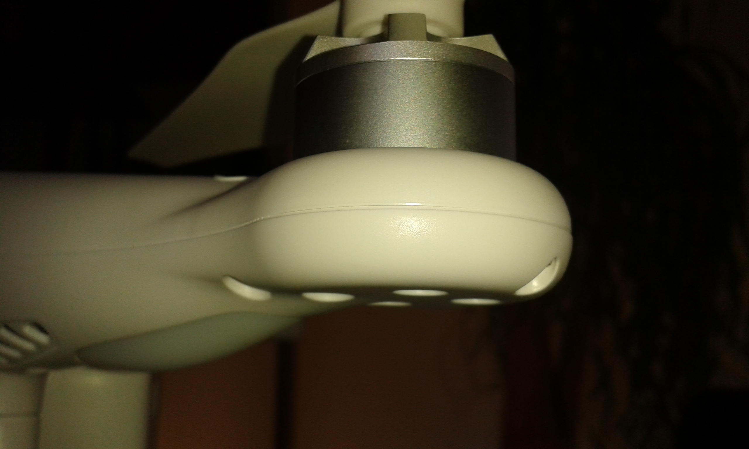

That's it, I'm done with this crap and frankly I'm tired of it. I just finished super gluing all the seams on all four arms. I didn't undo a single screw as I used to do on my all my P2s. This time, considering the issue is more about the two main chassis screws instead of the arm end cracks on the P2, I solidified the arms. If an esc takes a crap, not only is the main board dead, but the entire craft as well from the crash. Hence, I glued 180 degrees around all four arms. Just finished.
This isn't new to me and phantoms. It's about time they improve these shells. They are plenty thick enough in the mid section but could use a couple of more mils on the arms. Yes, I love phantoms, like the shell form factor. It works. But the shell is a piece of crap where the motors are. Wake up DJI!
I've had cracks on my P1 after crashes, they expanded, I replaced the shell after one year. I would definitely send it for replacement.
Here is result. All four arms are gued at the ends from right where the lights end and all around. The P3 does not have a modular parts construction. It's one main board. Any replacement of that will get close to the cost of the DJI offered craft minus camera and radio. The result is far more stiffness in that area now. DJI does not give a rat's *** about these cracks and believe me, they aren't under warranty. If they were, and people actually looked, they would have an extremely high rate of returns since this is a far bigger issue than any other. I have another brand new in box P3A and I'm going to glue that as well. Until they finally get around to strengthening this area, which they wont, I'll have to do this mod.
While some out there are busy crashing into the trees behind their house, there are others who just about never crash. And for those that never crash this is beyond annoying. It's infuriating. Anyway, here is the seam glued arm. I spread the super glue liberally, waited about ten seconds, then wiped the excess with a paper towel. I kept pressing it closed. Any glue marks that were there it took care of with some wet 400 grit.

I agree with hairline cracks but look at the picture...You can't superglue a hole.
Wow, now that's different :( That doesn't look like a structural part of the arm so unless you want to deal with DJI you could fill in any cracks with super glue to prevent them from getting bigger then fill in the hole with white bathtub sealer and let dry. That will keep out dirt and stuff. Or just some white tape. I don't think it would affect the integrity of the copter. But yes, you shouldn't have to live with it if it bothers you.
While some out there are busy crashing into the trees behind their house, there are others who just about never crash. And for those that never crash this is beyond annoying. It's infuriating. Anyway, here is the seam glued arm. I spread the super glue liberally, waited about ten seconds, then wiped the excess with a paper towel. I kept pressing it closed. Any glue marks that were there it took care of with some wet 400 grit. View attachment 22838
