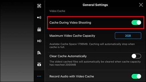

It looks like you probably have video cache mode on. On your DJI Go app, click camera to go into the camera view. You do not have to be connected to your drone for this part. Now, click the three little dots on the top right corner of your screen now you will see a menu scroll down to Cache during video shooting. The little slide bar will probably be green. Click on it, and the slide bar will turn black. Now it should not use up as much data with the unnecessary cache video that is saved to your device. I personally have an iPad, and it has plenty of room, so I always leave on the cache video option so that if somebody wants to see my video on the spot to make sure I wasn't spying on them or something, I can show them the video right there. It is also useful if you lose your drone to have that cached video and it might be able to show you where it might have crashed.

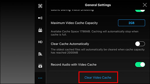

If you were caching the video on your iPhone, then clear the cache here:
And, then disable the caching here:
Thanks so much gentlemen - I’ve gone from having 2.3 available free space to 8.86 on my phone. Over half of the 16gb the phone is equipped with. Lots of room to fly now!!! The Samsung goes back next Monday and an iPad will take it’s place. I know lots of guys here use Android with no problems and I appreciate that. But being a life long Apple user I was having a bit of a time getting into the differences it has. It could be age... nah...
