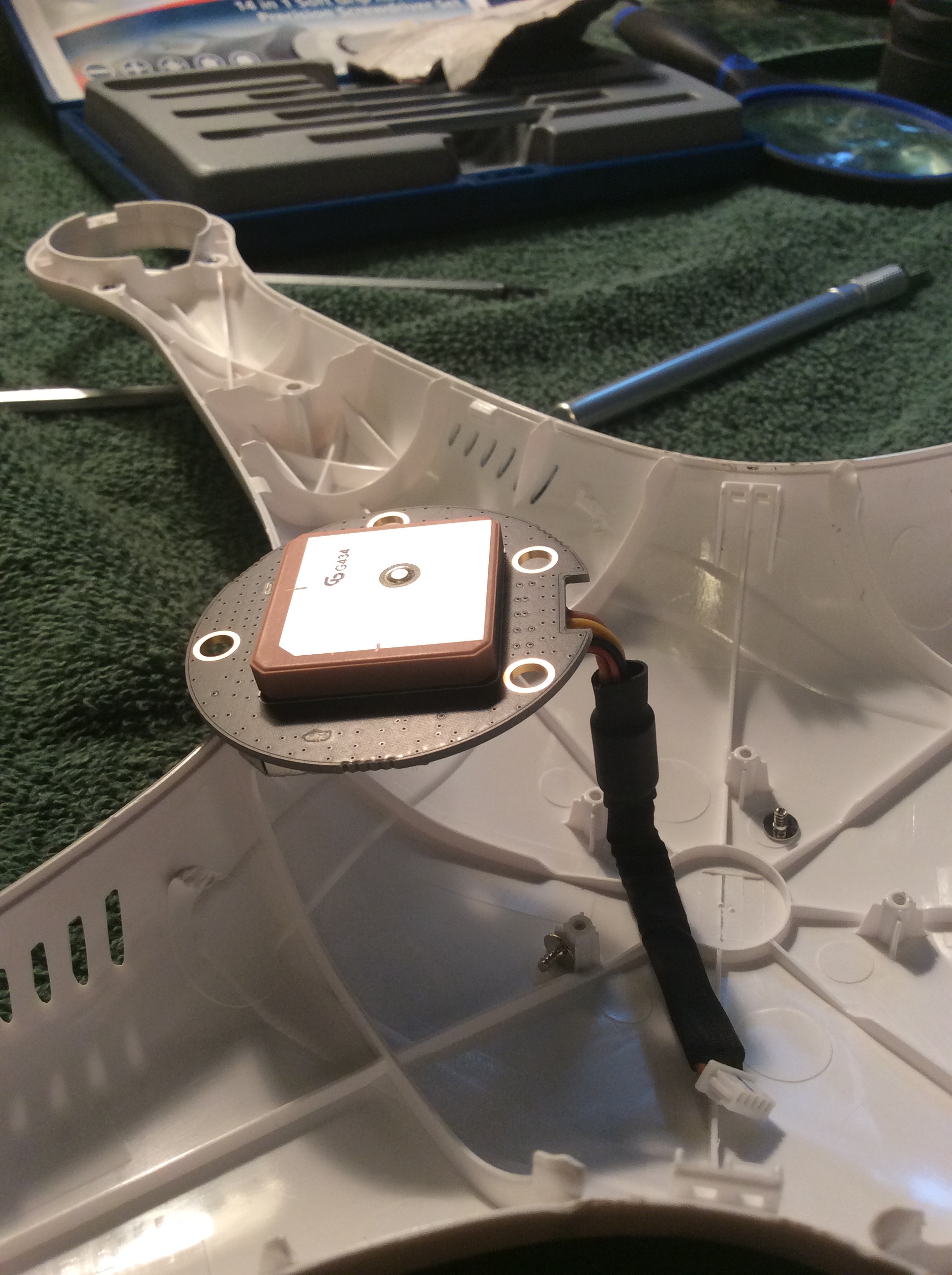

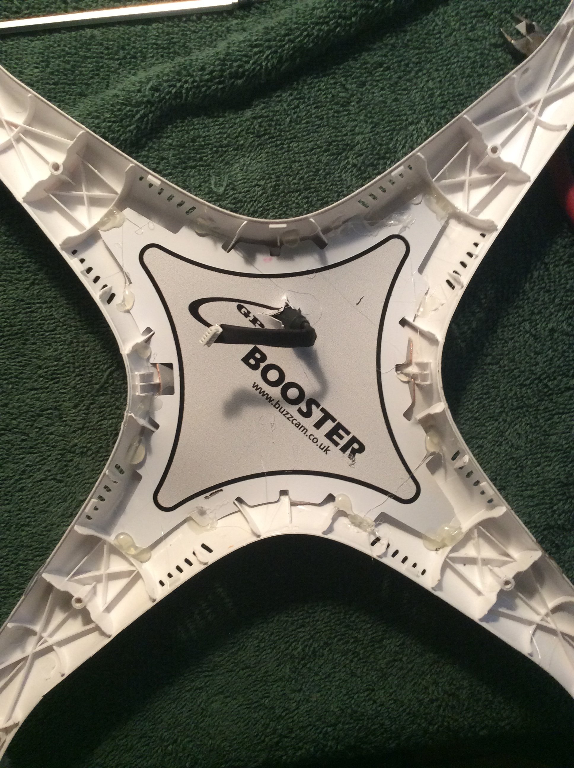

I've done the foil and 4mm antenna mod on my P2V and got as many as 15 .
Now this one has me on average once up at 14 . Well look at it .
sheild.JPG has something under it on the puck the other didn't and the shield is way thicker .

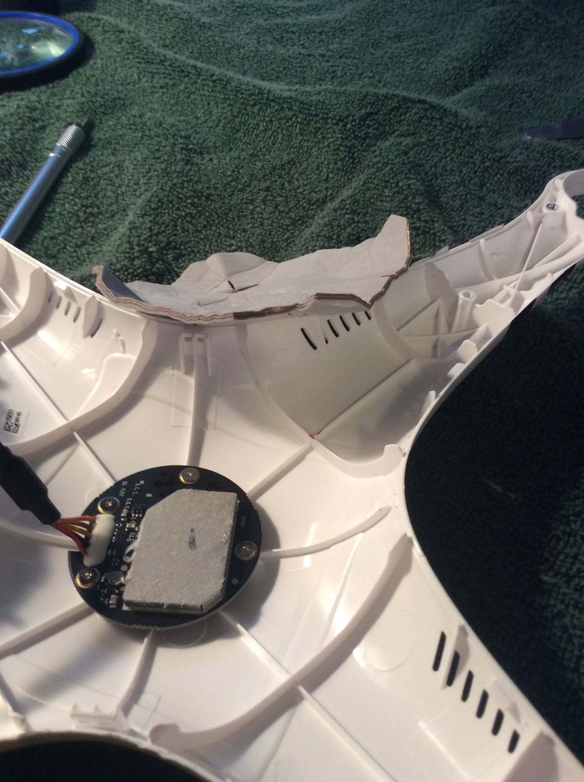

I added this just cause I was in there b3.JPG and will see if it gets me anymore . Can't hurt .

View attachment 35172 has something under it on the puck the other didn't and the shield is way thicker .
The antenna is already 4mm .View attachment 35171
I added this just cause I was in there View attachment 35173 and will see if it gets me anymore . Can't hurt .
