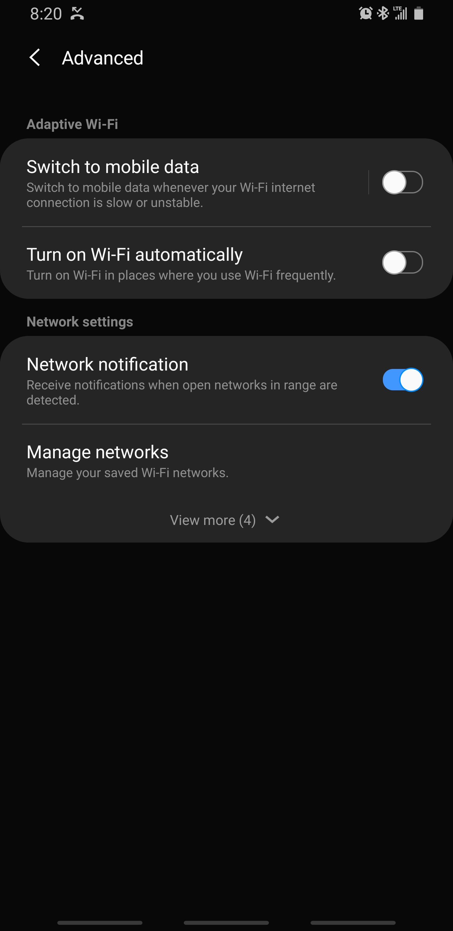

You won't get any data from that connection, because there is none. On your wifi settings, go to the advance tab and make sure to turn off the "Switch to mobile data" option.
Mobile data option is off! The Pixel 2xl phone is now not connecting in the same mannor as thia Samsung A70 must mean it's an issue with the Drone rather a phone issue, doesn't it?

Without seeing a screen shot, my guess is that what you are seeing is normal. It is also a VERY common question.
Since your Phantom's wifi signal is not an internet connection, your device is telling you that it has no access to the internet when it is connected to your Phantom's wifi signal.

LOL I said the same thing Oso did. Guess my message did not go through. The point of the screenshot is, that Android phones tend to drop the internetless wifi in favor of mobile data. To turn off the "Switch to mobile data" option prevents the phone from droping the wifi and will let you fly normally.
