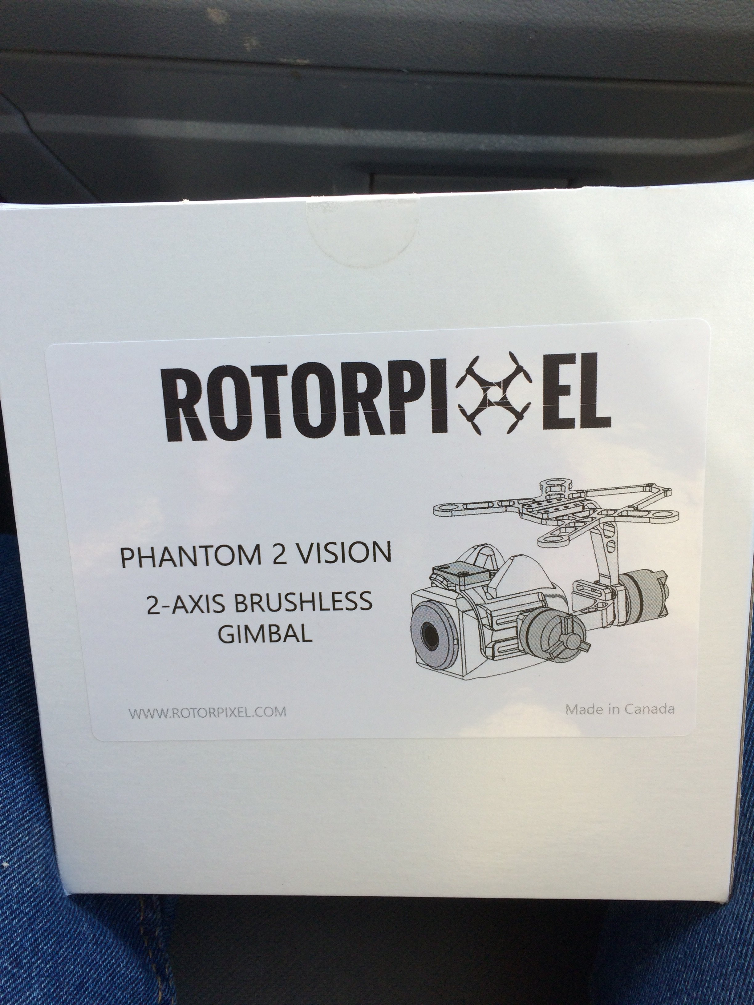

View attachment 17701 Look what came today it's like Christmas in April
That's great news, glad you've recived it, bet it was like Christmas morning for you, we are all big kids at heart:), the guy in the red suit with big white beard has now got to navigate his way over to me now, he can't be in two places at once.. Think I'll track him via Google:D
Let us know when & how you get on with the install.
