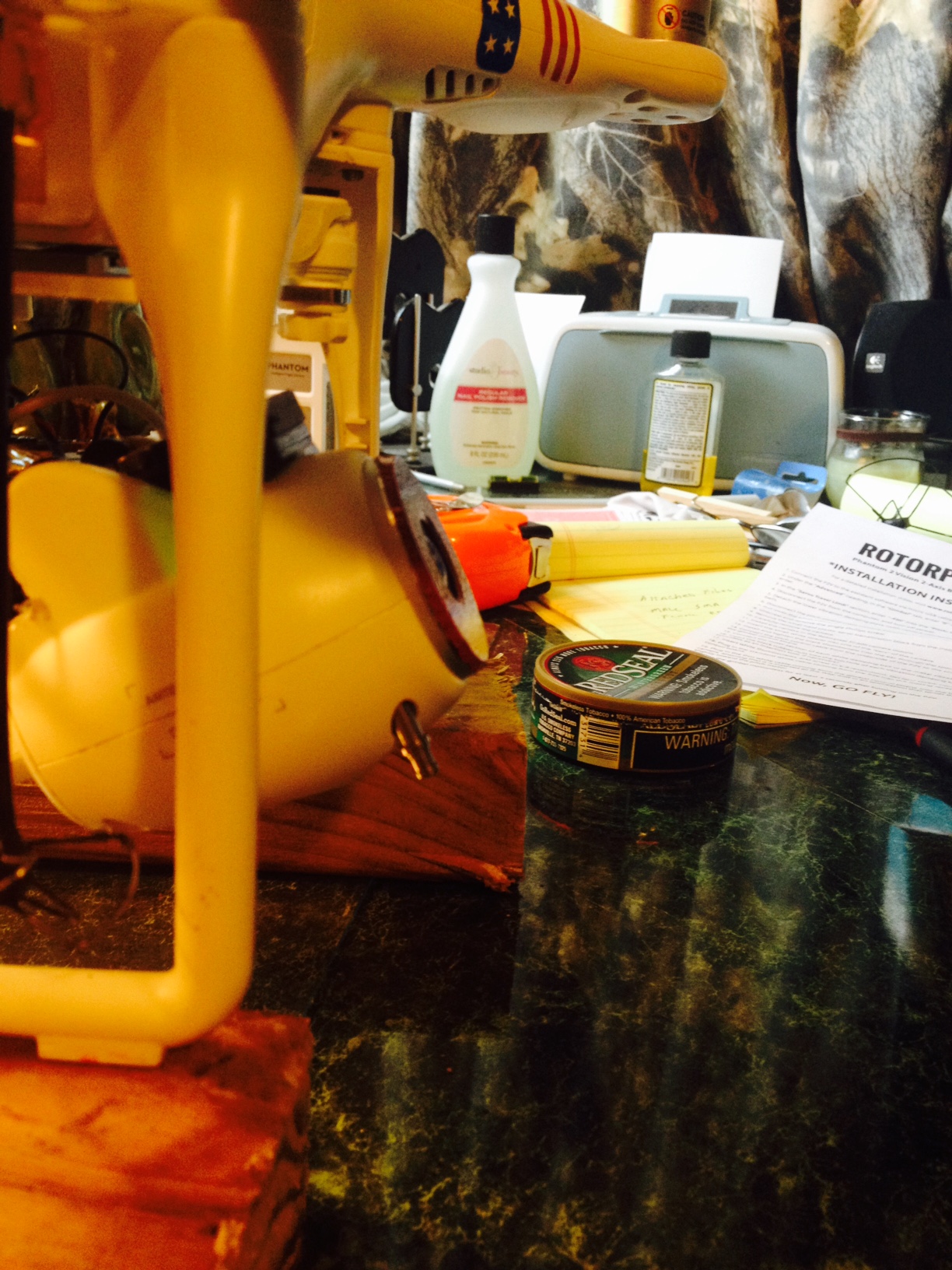

Success !! Well almost and now have ? Finally got it to work but had to take the filter kit and lens off as it just went straight down and shook . Now I got the settings in assistant like it said in instructions but when I have it tilted full up it looks like this , Normal ?full up.jpg
Settings are 1000.....-450......-1000
Success !! Well almost and now have ? Finally got it to work but had to take the filter kit and lens off as it just went straight down and shook . Now I got the settings in assistant like it said in instructions but when I have it tilted full up it looks like this , Normal ?View attachment 16510
Mine doesn't go up that far. The upper limit is about straight forward. I would, however, be more concerned with the other limit. It should point straight down. If not, then some adjustment is needed.

It does go straight down no problem but seems to point to far up ? I need ta find the post where ya balance the filter kit on it but haven't found it yet .

Ya it goes straight down but I found when I power up I just push the scroll wheel up and it holds steady !!! Now where is it I find out how to get it to not go crazy with the lens filter on it !! I had to take them off to get it from trying to shake itself apart?
And Thanks ! ;)
Added / I got it to sit right using 1000....-500....-650 . I guess ya just have to play with it ! Happy gave me his #'s and just played from there .
Thanks. I calibrated mine with the lens filter on and it sits fine, no shaking.
Only issue I have is that I can't balance it perfect.
