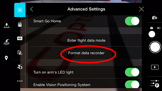

    There are two locations where flight logs are stored -- on your mobile device by DJI GO and on the internal memory card in your Phantom. The new owner will not be able to access your DJI GO logs. Here's what you need to do in DJI GO to remove the internal logs:

    Thought you might want to note one difference in the screen shot of the GO app Advanced Settings screen pictured by msinger.
    At least on my iPad running 2.4.3 of the GO app, there is no selection available to "Format data recorder" under advanced Settings.
    Maybe it is available on the Android version and not the Apple version.
    I do remember seeing it at one point, but I think DJI disabled that function during one of the GO app updates.
    As far as I know, there is no way to format the internal SD card built into the Phantom which would erase the .DAT files.

    While the format button is gone in the most recent versions of DJI GO, the "Enter flight data mode" is still available. Once in flight data mode, you can connect your Phantom to a computer via the included USB cable and delete the DAT files. See more details here.

    Sky King the 'Format data recorder' button has in deed being removed, but there is still the choice to erase the flight logs. Here is the screen in DJI GO app v3.1.2 for iOS that I'm still using.
