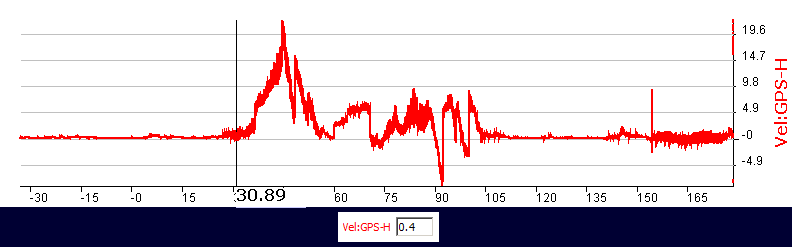

Firstly, in my DatCon conversion of FLY071.DAT, the parameter Vel:GPS-H is all over the place, with many entries reading "Infinity".

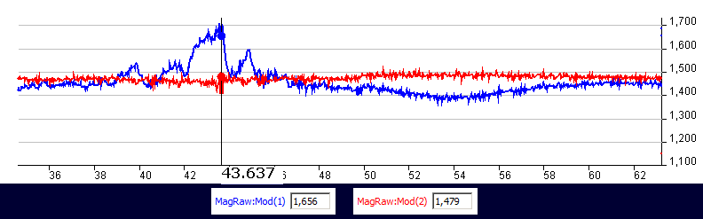

Also, mag1 raw mod seems unusually noisy, but I'm not sure what to make of it.

Me too. I don't get infinity values in Vel:GPS-H. What sampling rate are you using? There may be a difference between the PC JVM and the Mac JVM.... Could you run it at 200 Hz and provide the .csv and I'll compare against mine.
I'm looking at the magMod thing. The AC is using Mag1 and it's noisy. Theoretically, it should be a constant value.. Unfortunately, DatCon doesn't extract battery info for the P4. But, looking at control inputs vs MagRaw:Mod(1) it appears that at max current is when the MagRaw:Mod(1) hits the maximum error.
Kinda reminds me of the motor cabling problem that some Mavics had. The cable wasn't twisted enough and it was close to the back compass. At high current the back compass would get noisy and ultimately cause a compass error. Also, on the Mavic the back compass was on the same PCB with the GPS. If the same is true of the P4.....
I wondered about the sampling rate, and I guessed that you were using 200 Hz. It has infinity entries at all sample rates, but the values vary wildly with sample rate. Here's 0 - 100 seconds of the flight at 20 Hz and 200 Hz:
Dropbox - FLY071_20Hz.csv
Dropbox - FLY071.csv

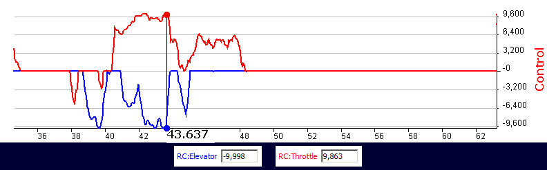

Interesting observation on the elevator input related to mag1. The motor current data are in the file so you can add those to get approximate battery drain, and they clearly relate to the variations in mag1, but perhaps not as closely as pitch:

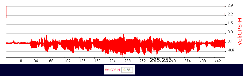

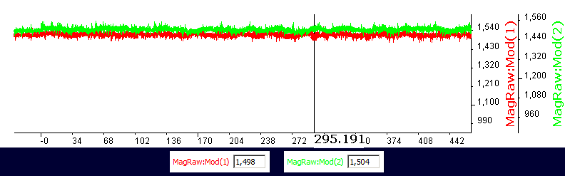

OK, got some new results. See data logs FLY081.DAT and FLY082.DAT at the link below.
P4A data files - Google Drive
FLY081 was a short 3:34 min flight after calibrating IMUs only. I terminated the flight after receiving "compass error", and "weak GPS signal" messages at 1:33 min. I also got a couple of "Current RTH route will pass a No-Fly zone. Pay attention to the aircraft's position to avoid RTH failure". I never initiated RTH and there was no other indication that the AC self-initiated it. Just alot of confusing disconnected pieces of info.
Then calibrated the compass out in the middle of the soccer field. After calibration, the compass interference values were as shown in the pic below. Sorry I didn't think to take a picture before calibrating, but I recall the bars were green but somewhat larger than shown here. The point is, relying on the app to judge compass health ain't no good.
bEb1YWCZhtvU24iJ3
While preparing to take off, I got this warning on the Aircraft Status screen. I figured, oh oh, now I'm getting the error before takeoff, and contemplated not even conducting another test, but then realized this might be a hangover message from the previous flight. So...cautiously, I took off.
0mGyh1nTXyWRpACp2
FLY082 went uneventfully, staying in GPS mode all the time for a 12:48m flight, with none of the aforementioned errors. Continued with VLOS and low level (up to 100 ft) with no issues. Contemplated doing a POI circle as a test (it makes better circles than I do) but didn't want to push my luck until having had a chance to confirm the data is clean.

FLY081 seems to have the same issues as FLY071 and FLY074. With FLY082 it would seem that the compass calibration made a big difference. The magMod issue is gone.
And the Vel:GPS-H issue is gone.
