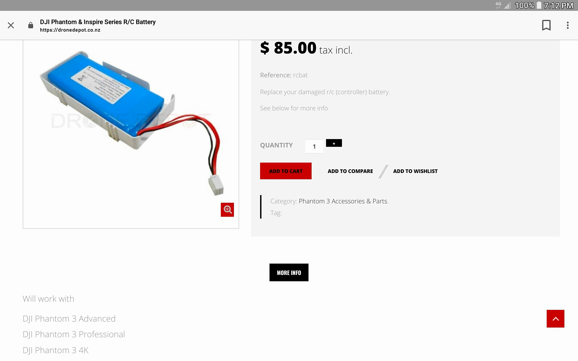

Could be something else going on,I recently sent a batt to help someone but battery made no difference to the out come,it could be the board that battery plugs into,,this batt below is the replacement one for remotes even though it 3 times the size of original that's in the p34k remote,it will fit in remote there is room in there for it,install of a off on switch good idea but for some reason they do discharge themselves ,I can be fully charged and next day plug it in and some more charging will happen,hope this gives bit of insight to what going on
Could be something else going on,I recently sent a batt to help someone but battery made no difference to the out come,it could be the board that battery plugs into,,this batt below is the replacement one for remotes even though it 3 times the size of original that's in the p34k remote,it will fit in remote there is room in there for it,install of a off on switch good idea but for some reason they do discharge themselves ,I can be fully charged and next day plug it in and some more charging will happen,hope this gives bit of insight to what going on View attachment 102693
