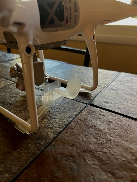

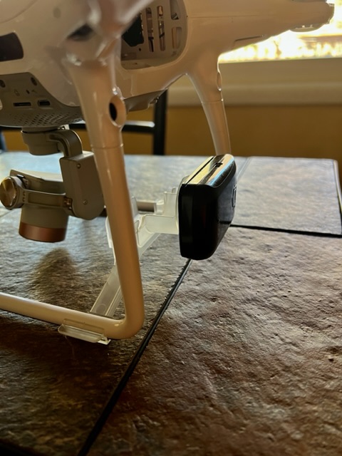

That is an ingenious idea. But I see two issues. (1) I'd be a little nervous with the mount just press fit onto the landing runner from underneath and (2) I think it is going to interfere with the two downward facing sensors located toward the rear.
Reactions: CoreySnipes
Caught that! I would also definitely zip tie for security

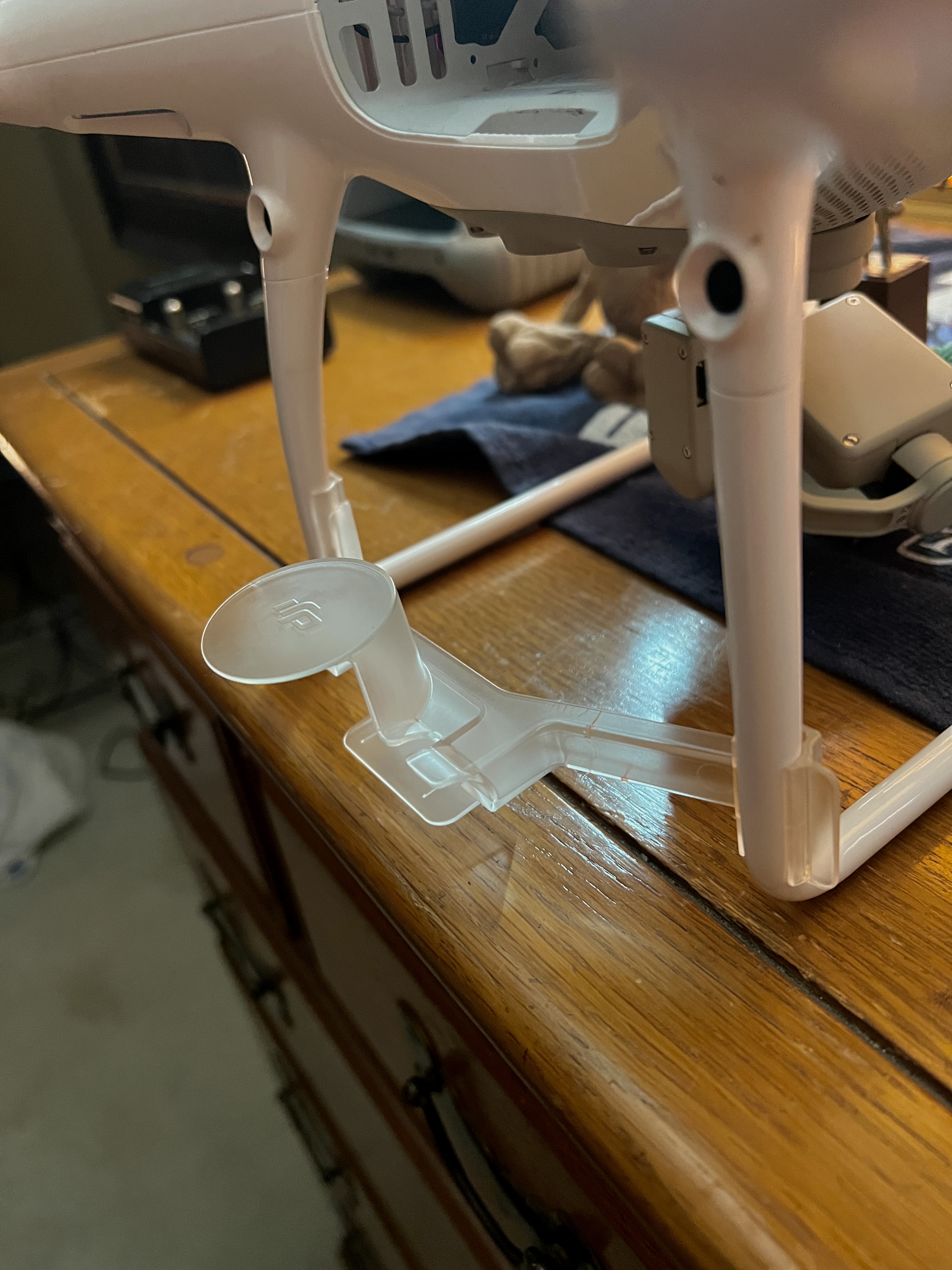

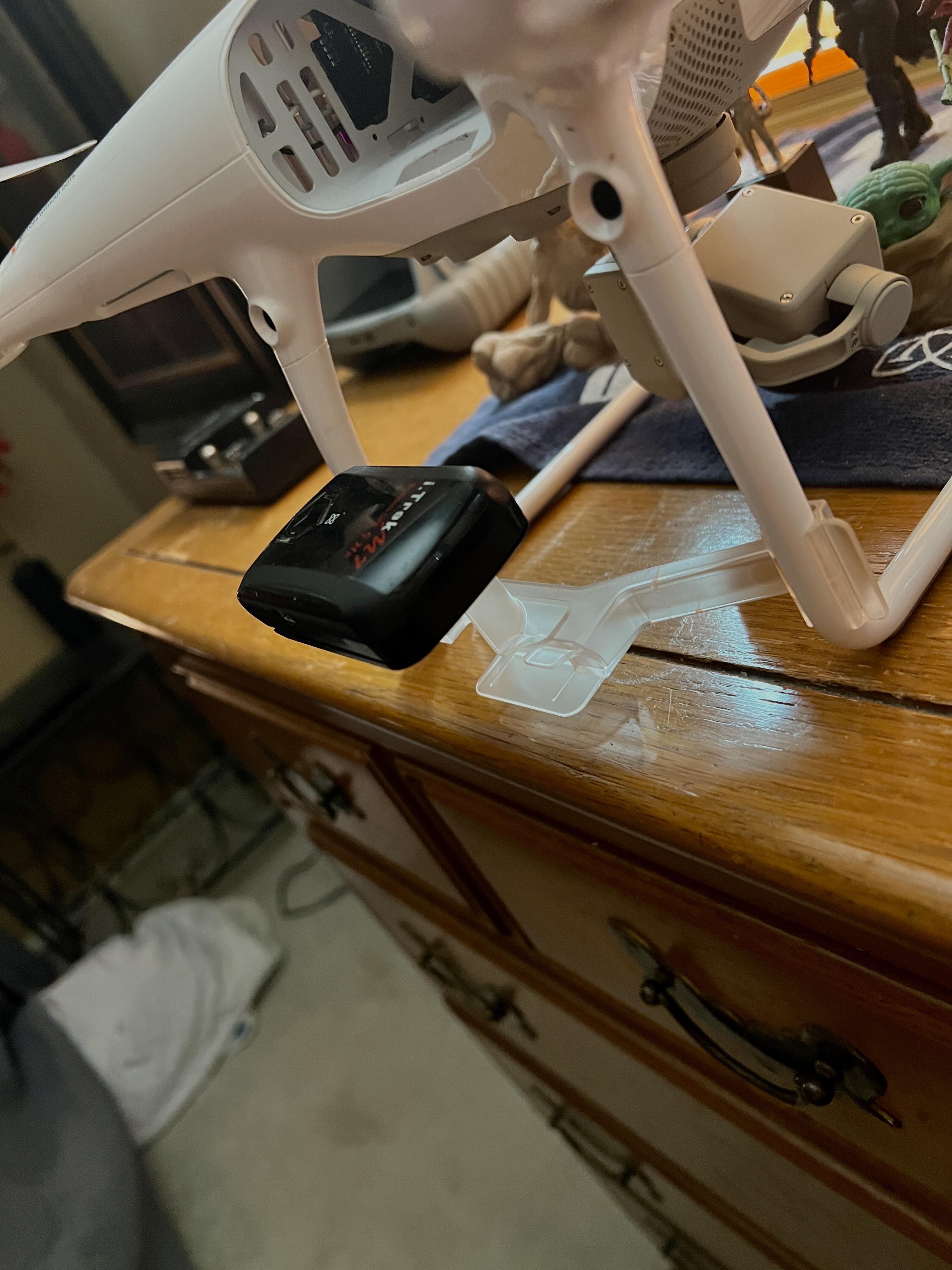

Just purchased the Holy Stone RID from Amazon and a matching (3d print) Phantom leg mount from Etsy. Far away from the GPS. Will post test results and pics when they arrive. Have 3 P4Ps so easy transfer and solid attachment is a must.

Tech...brilliant placement! Have you tested it to make sure it does not interfere with anything?
I have not but I am making a 3D Printed version that cuts down on the unnecessary waste of the original bracket. Details, photos, and .STL file coming soon…
Brilliant Tech! I have sent your photo to a couple that have Phantom 4 Pro's V1 and I configured mine like yours!

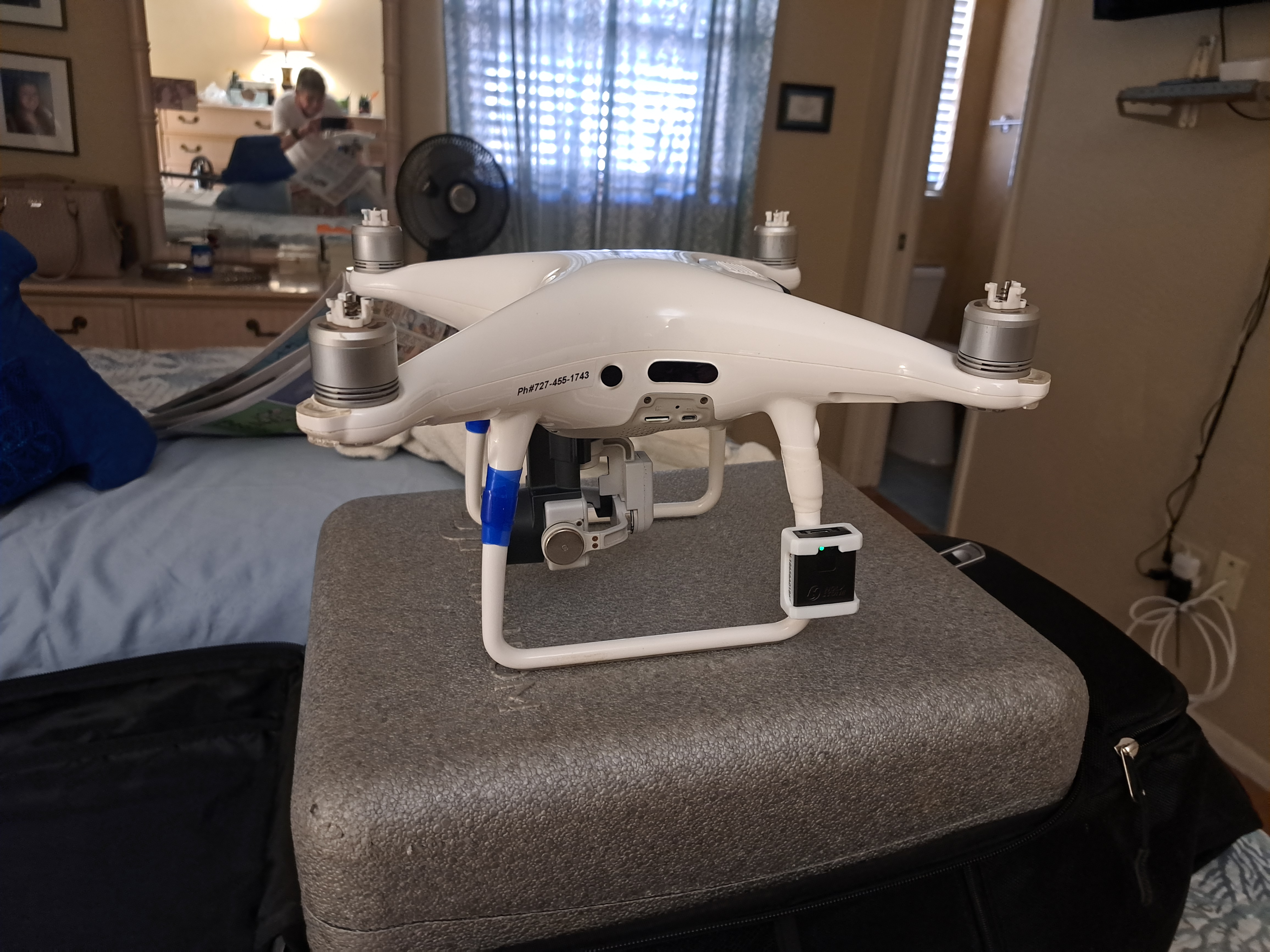

Legs were out due to possible antenna problems and it would not fit into my case.
This is perfect.
Looks very promising. I already attached my HS RID to the camera protector like you showed. Works great and fits into my original P4P container. (with RID removed and placed back on the camera). Not concerned about interfering with downward sensors since my flying is usually above obstacles. I almost always hand catch my P4P too.
