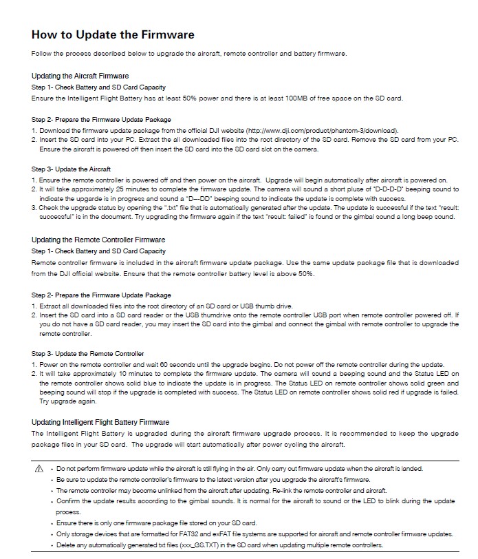

Dude you're going to get hammered on here for two things... One - reposting.... just bump your original post (still not great but better than reposting) and you're going to get crushed for not reading the
directions - so I enclosed them for you....

When you download the update from the DJI website, there are very specific instructions on how to update the controller and the aircraft. They must be followed exactly.
There are also specific videos on you tube that will walk you through the process. Try those resources first and then get back on the forum with your specific questions. If we don't know what you did specifically when you upgraded, it is rather difficult to be able to help.
Sounds like the update did not complete.:) It is somewhat confusing if you aren't familiar with all the terminology, but that will become clearer as you learn the processes.
Re-perform the firmware updates on the controller and aircraft and let's go from there..
