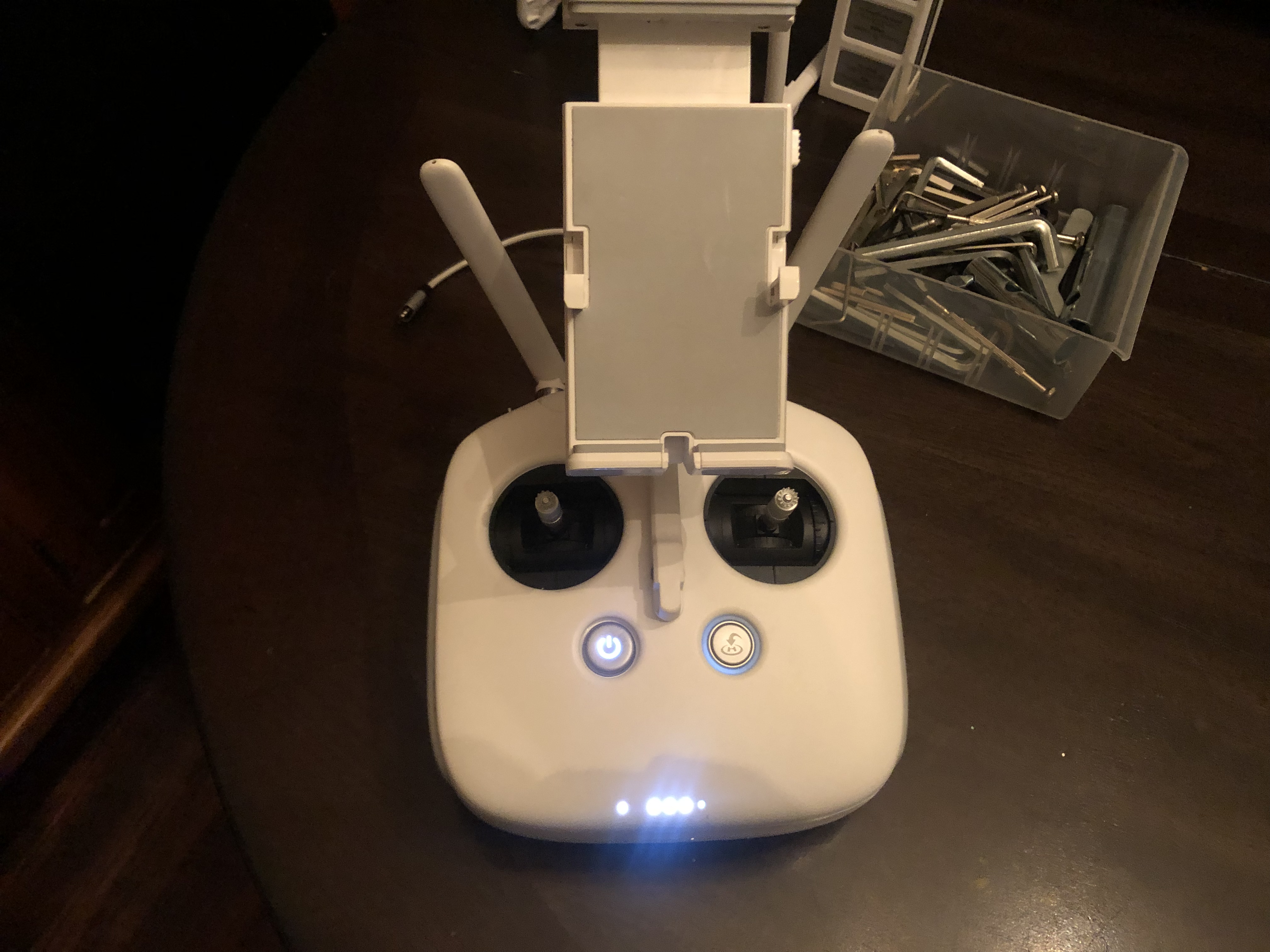

I hate to bother you guys but it seems some of you to be a master of dronage
I purchased a phantom 3 pro from a buddy last week, I charged it all up and it linked up and everything worked perfect
Until I decided to update firmware and that’s where the disaster started
My controller(gl300c) won’t power up
Unless I press c1/shutter together What’s happens is 2 solid white and 3rd flashing which than allows me to push once and again it beeps and powers up , now it has a blue light with 2 solid whites and a 3rd white flashing it’s stuck in this mode and nothing can be done, tried linking with 2 different iPhones as well as an iPad , checked the USB cord, obviously it’s from the update, I spent many days reading forums and trying everything people suggest but with no luck am I screwed? Thanks for your time
Jon

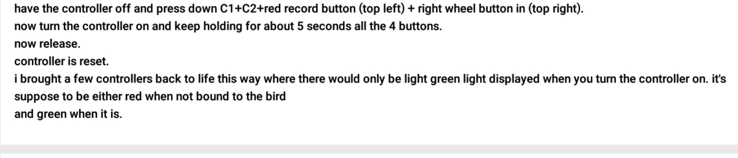

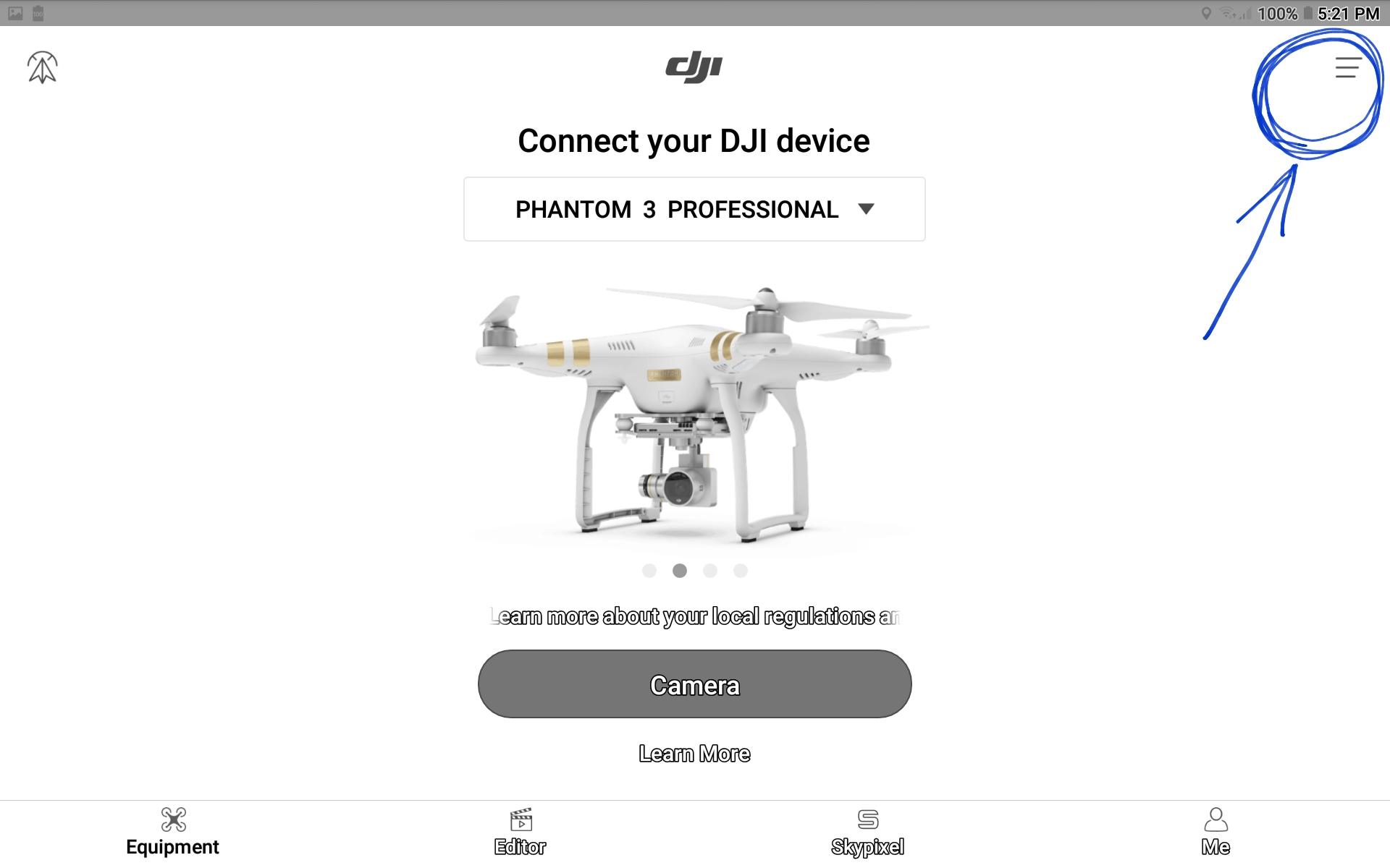

Try this method,,,this is hard reset of remote,also are you able to open app at home page before connecting, there is 3 black lines top right of screen ,,press and hold and another screen comes up with any available firmware versions ,,if unsure ,,I post some pics to help you find
you should get screen like this but with all powered on drone and remote you should have version there to choose

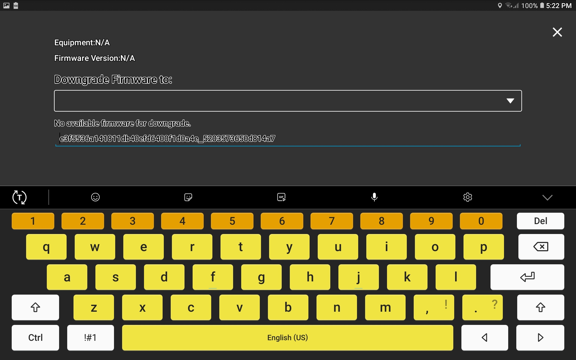

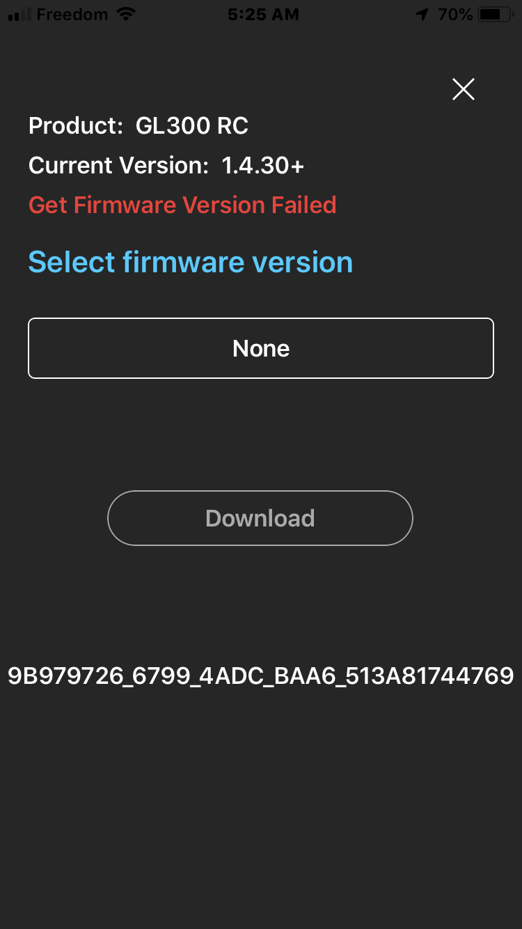

This is the screen I get with no options of pressing or selecting a download

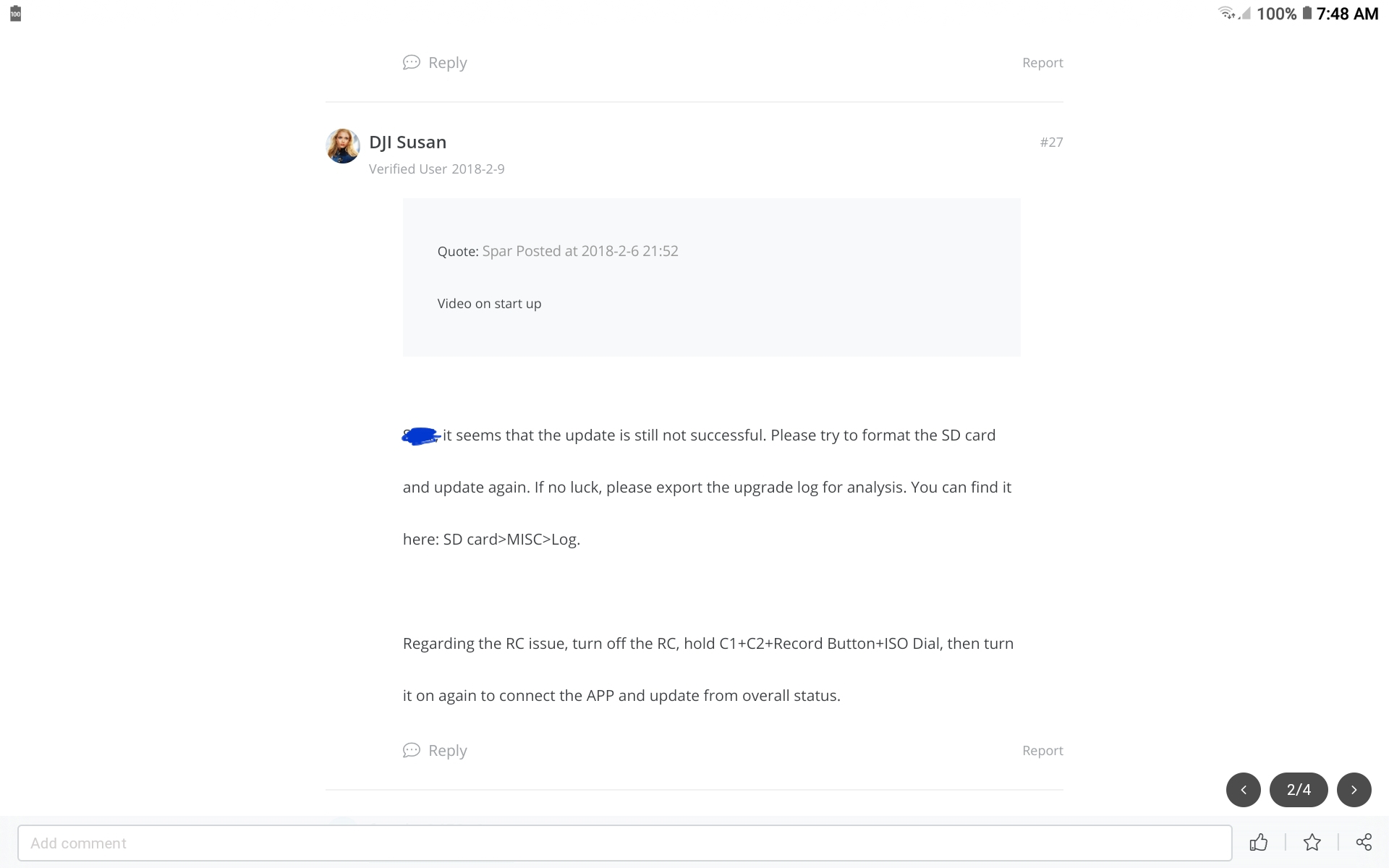

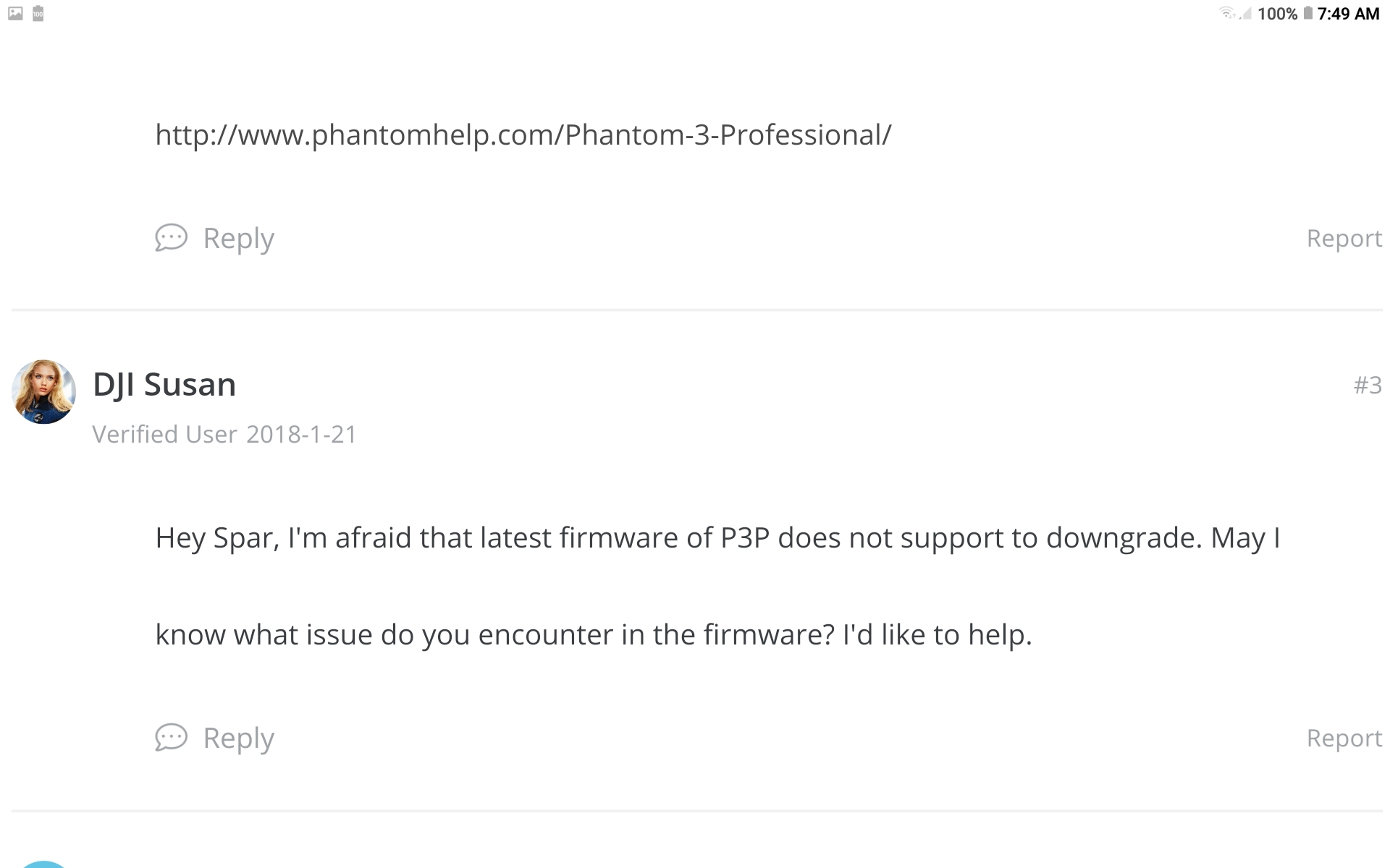

Ok me been checking this,not sure on this but this post from dji Susan stated that there no option for this with the pro firmware,,unsure what to advise on this now
