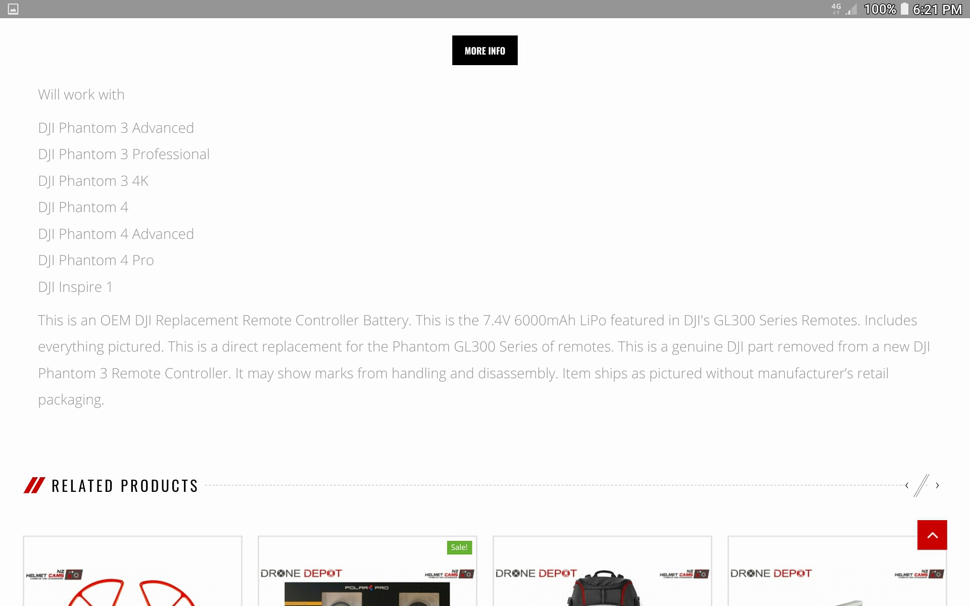

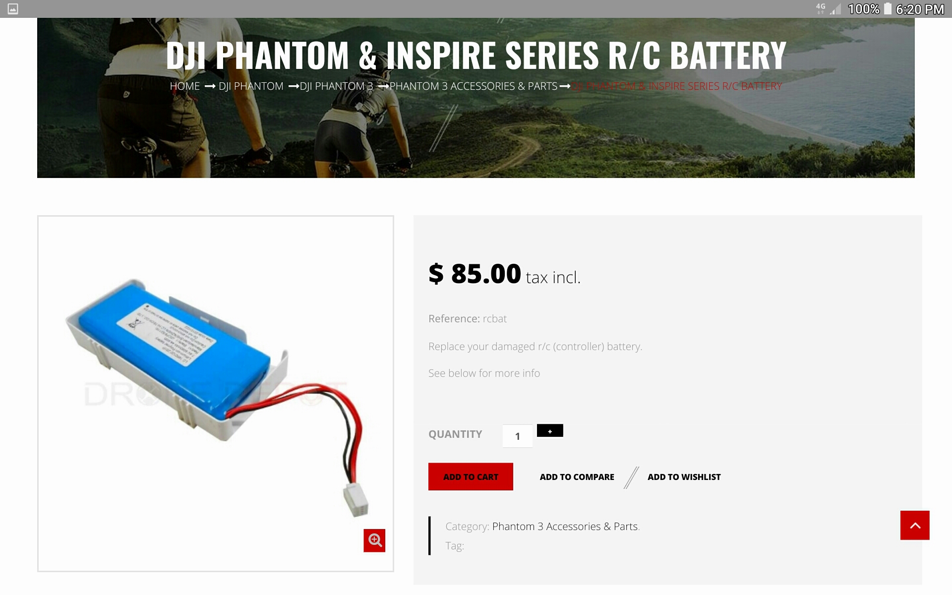

I don't want to bugger up the remote. If needed I will replace it with the one I unsuccessfully tried to link to and is shown by ianzone in post #4.

So what is the advantage of what you did versus buying the battery listed for $85? Is it the cost or something else?
Hi GaryDZ
I would not say that there is an advantage in the battery I used, on the contrary, I am assuming that as there is no balance lead on the battery you listed because, that battery must already have an on board balance circuit which would be much better than the battery I used, but when I needed it, the battery you list was not available.
I can't quite remember, but the battery I used was only $ £30.00 I think, so some saving yes, but as I said, on rare occasions I do open the RC to balance charge the battery, so that is a distinct disadvantage.
If I needed a battery now, I would go for the one you listed.
