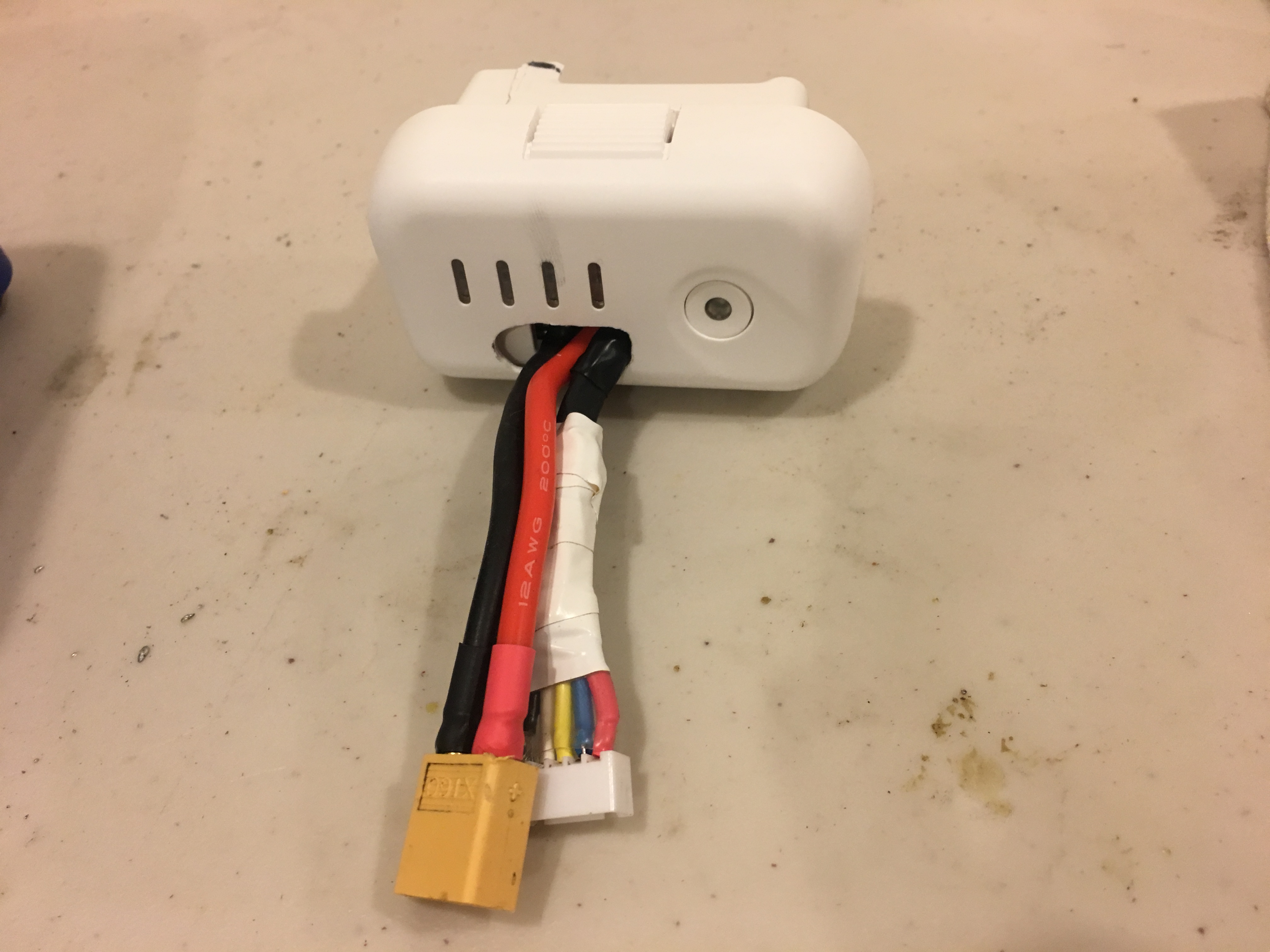

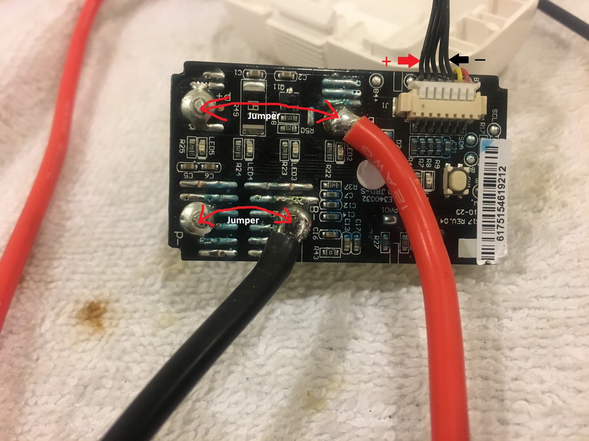

@With The Birds is correct...You'll get an error "unofficial battery" or something like that and the motors wont start. The attached pics is what i had to do to get it to work. Its very finicky and not for the faint of heart. IMO being you don't know what is wrong with your P3 i would just go the official way and not add anything that can cause additional problems and when you do get it flying then, hell yes! cut this apart and start modifying stuff after reading all 130 pages of this thread Dual Battery Mod ;)
@With The Birds is correct...You'll get an error "unofficial battery" or something like that and the thing wont start. The attached pics is what i had to do to get it to work. Its very finicky and not for the faint of heart. IMO being you don't know what is wrong with your P3 i would just go the official way and not add anything that can cause additional problems and when you do get it flying then hell yes! cut this apart and start modifying stuff after reading all 130 pages of this thread Dual Battery Mod ;)
I think there is a major difference here ............. other guy croc clipped to the AC contacts ... not to the battery board.
Your modification was to the battery board which of course has DJI FW and other in it.
................ on a note about LiPo's and whether a standard 4.2V per cell LiPo could work ... of course it can if the AC accepts it ... the fact its a LiPo and not a High Voltage LiPo only means a lower starting voltage.
People do in fact create the Z contact plates to carry a second LiPo on board ... so it does work.
Nigel
