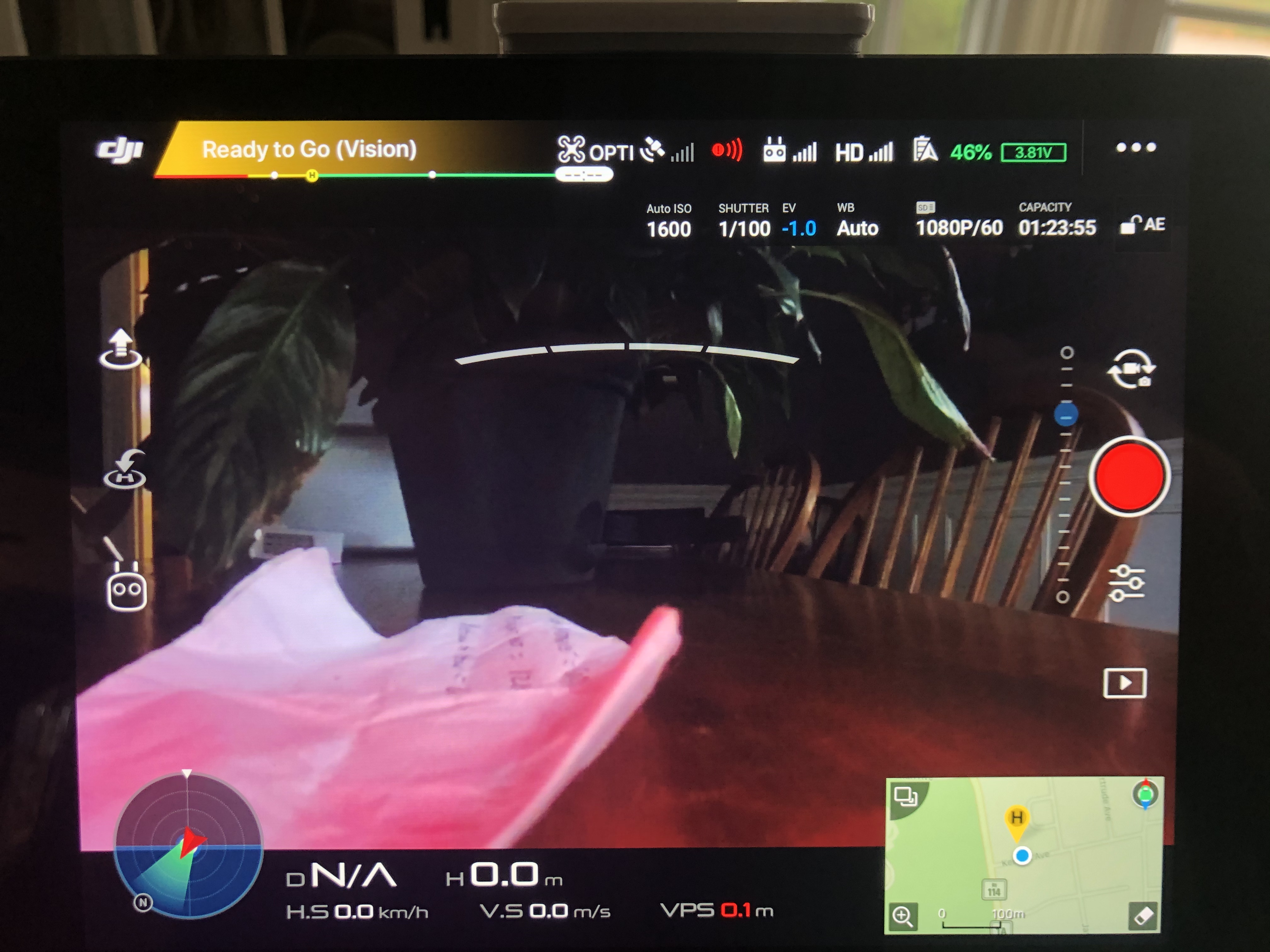

When I start up my Phantom 4 Pro it seems to be stuck on Ready to Go (vision) mode? Do I have some setting set wrong?
Are you starting it up indoors? Are you in P-GPS mode or ATTI mode? Indoors, that is the best you can hope for; GPS is line of sight basically and will not generally penetrate the roof of a structure. If you are outdoors try moving into an open area with no tree cover or buildings/structures nearby. You might just be in a blind spot....

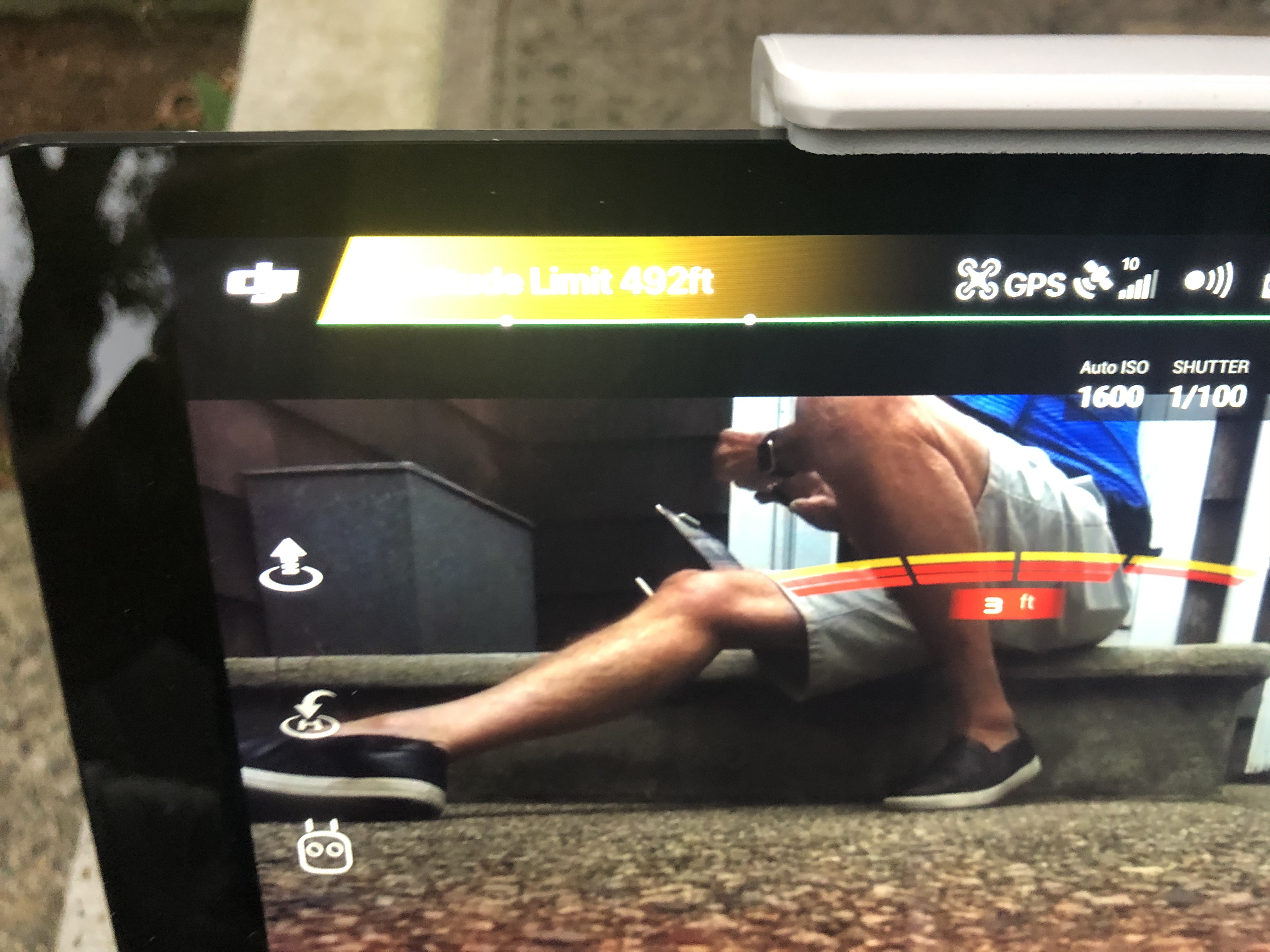

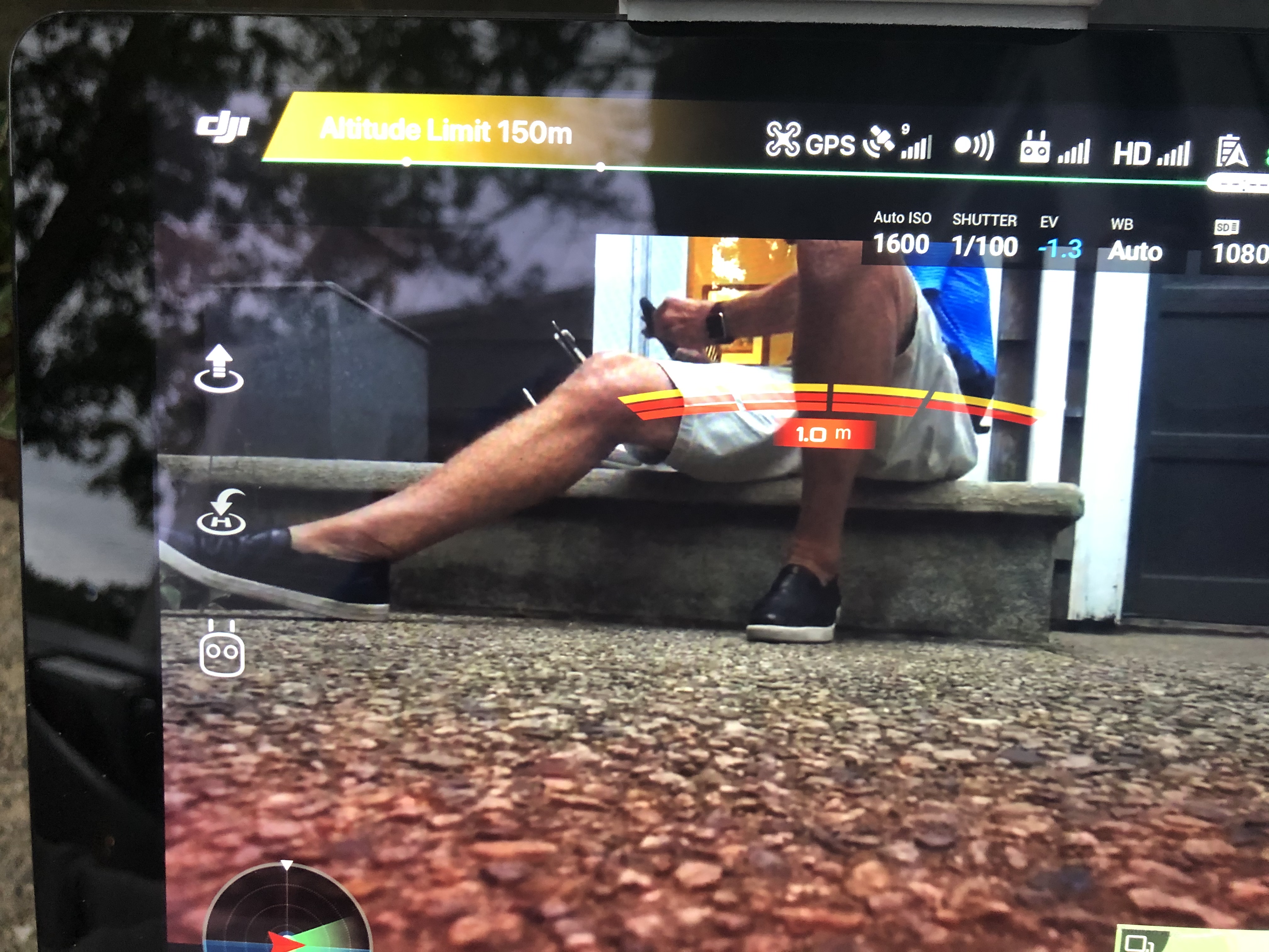

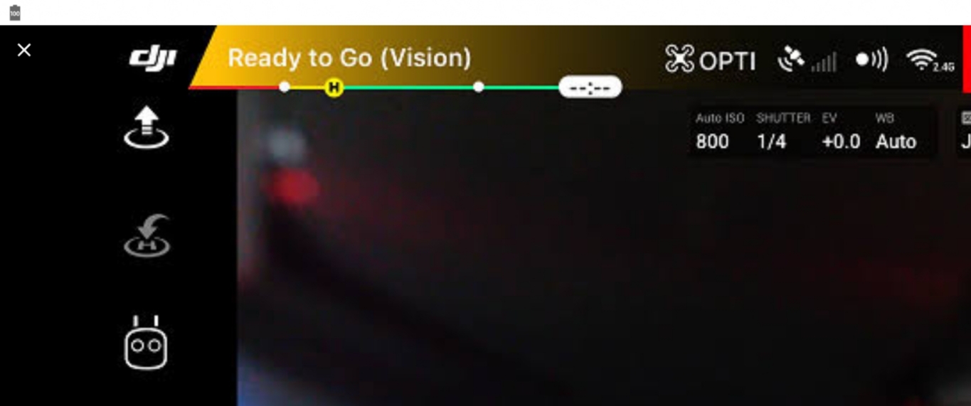

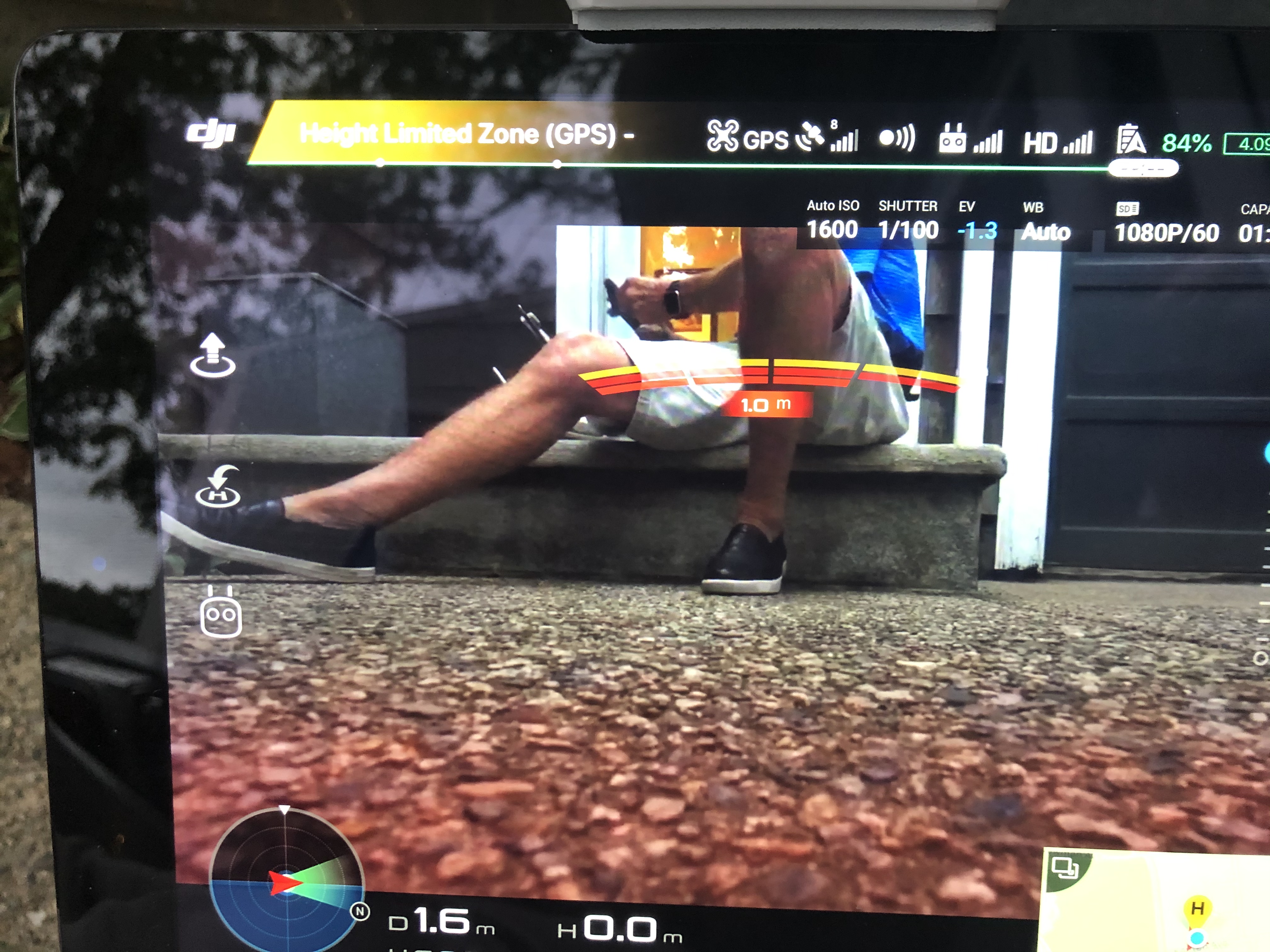

The series of 4 pictures you uploaded in post #4:
In the 1st picture you have zero satetlites so only vision positioning is active.
In the 2nd picture 9 satelites but a hight limit because of your specific location, which means you have a GPS-fix and the drone is "Ready to GO in GPS-mode"
In the 3rd picture the same as 2nd picture but only 8 satelites.
In the 4th picture the same as 2nd and 3rd picture only 10 satelites.
Conclusion: There's NOTHING wrong with you system !
