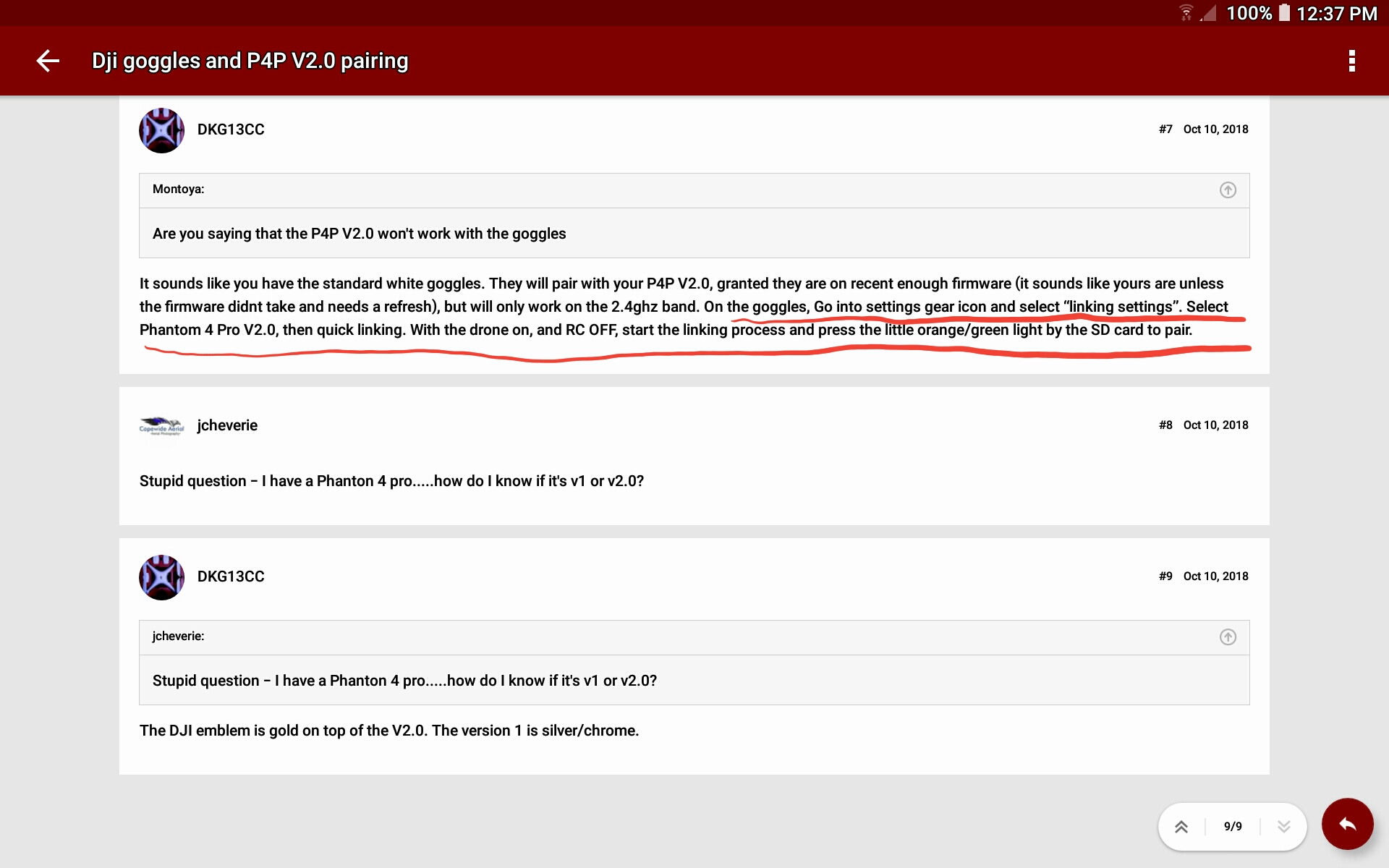

Hi, so i made it past one hurdle with activating the goggles. Gotta say the documentation is quite sparse to say the least.
Now, I can't seem to get the goggles to link up to the drone, a P4Pv2 with updated firmware all around.
1. What is the right process to link these up? I downloaded a PDF and it's got different documentation than the manual that comes with the goggles.
2. Do I have to link up the goggles each time or is it a one time link up?
thanks, Kurt

This from another post,,hope you can read it,are you trying in linking under in goggles settings,,,yip one time link up,,,using usb or ocusync ...it does say there have rc off
P4pv2 has live view only no usb,was just reading,,Google friend here,there a PDF manual u can download, not as informed as dji goggles but has little info there
